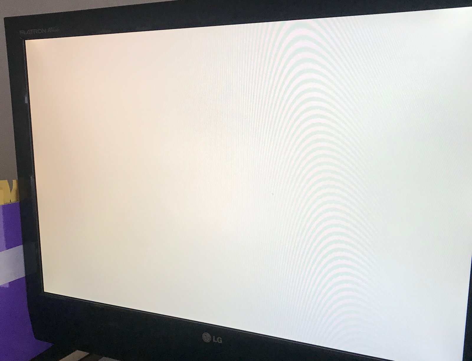

Hi everyone, I started with a post with this problem with my Atari STacy in the Atari forum, but unfortunately it has not been working for a few days. As I have just received the diagnostic cartridge from exxos, I am eager to proceed with the identification of the problem (and of course its solution).
Here I summarize what has happened to my STacy and what I have done so far to identify the problem.
After I cleaned the motherboard (it was really dirty but working), I plugged it into a power supply and I heard tick-tick-tick coming from the power supply; it looked like it had shorted out. On the second attempt I heard a small "stac" from the motherboard, so from there it no longer worked properly, and more specifically, connecting the motherboard to a color monitor gives me a completely white screen, while on a monochrome monitor (external) , it gives me out of range while in the original display, of the STacy, it remains black.
I did a test by powering the motherboard from an external power supply, directly into the floppy drive cables, with + 5V (as suggested by a fantastic user who helped me on the Atari forum and unfortunately I don't remember his nickname).
In this case I see a white screen on a yellow frame.
In any case, no characters on the screen.
I assume that the original DC / DC power board of my STacy is working and I state that all the cards (DC / DC and EPROM), have been inserted correctly in the motherboard sockets.

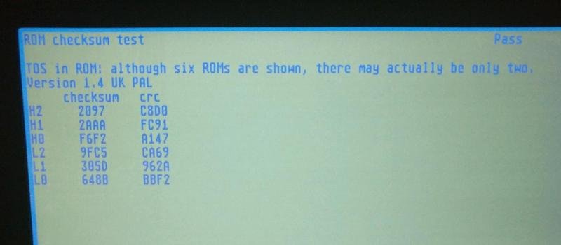

I received the long awaited diagnostic cartridge from exxos just the day before yesterday. I then tested my Atari ST, either directly from the menu displayed on the monitor, or via serial, by connecting my Atari ST to a high PC via serial cable, and also in this case I see the menu to perform the various tests. My Atari ST is working fine.
So, I did the same thing with my STacy (the dip-switches remain in the same position as an ST), but unfortunately no menu via serial.

"It should be noted that there are situations whereby neither the on screen menu nor the serial terminal mode do not work. If there is a problem with ROM space on an ST, generally speaking you will see a plain white screen when booting to low / med res.
Because the diagnostic cart maps into ROM space, a problem with the onboard ROM space will prevent this from happening. On a positive note, it means you can focus on fixing what's wrong with the on-board ROMS, so at least this sitll points you in the right direction.
If you plan to repair STs, then the diagnostic cartridge is an essential tool. "
I forgot to mention that I have already tried to replace the GLUE chip and another one of similar shape, whose name I can't remember, putting these two components from the STacy to my Atari ST and they work.
I think at this point that they could be the two EPROMs of the STacy.
I haven't had the chance to change them because I can't find them and as always they are different from those of a normal TS; they are from Toshiba and have different pinouts and my EPROM programmer does not support that EPROM model.
Of course, any idea is welcome! Thank you.
This is proof that the cartridge configuration works:
This is the white screen that my STacy offers:

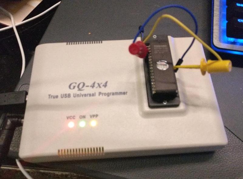

Well hrmph. I seem to be unable to program EPROMs for @Roberto.
I've got some Toshiba TC571001D EPROMs I picked up a long time ago, back when I was starting on my colour Stacy project, and I've got a GQ-4X4 programmer. It reads these chips just fine, but every attempt to write fails. Following some advice from an arcade forum, I gave them a good 60 minute UV erase session, even though they already test blank successfully, but that's made no difference.
The programmer's supported device list includes the TC571000D, but not the TC571001D. Can someone who understands these things better than I do have a look at the datasheet and confirm for me that writing the TC571001D is the same as writing the TC571000D, and therefore my programmer should work?

What happens if you make an adapter and switch OE and A16 (pin 2 and pin 24)?derkom wrote: Wed Jul 13, 2022 6:13 pm ...
Re: White screen with STacy
I've pondered that. Figured I'd fish for some advice first. The datasheet specifies that for programming, /OE can be either high or low, so my assumption has been that it won't have any effect. But I do plan to give that a shot if nobody knows for sure.DoG wrote: Wed Jul 13, 2022 6:44 pm What happens if you make an adapter and switch OE and A16 (pin 2 and pin 24)?
Edit: Well what do you know, that actually works. Thanks! Based on what I'd seen on the datasheet, I really didn't think that would work. Unfortunately, the way I quickly bodged it together to test it has destroyed one EPROM (leg is about to fall off now), but I've got more. I'll figure out a nondestructive way to do another one.
