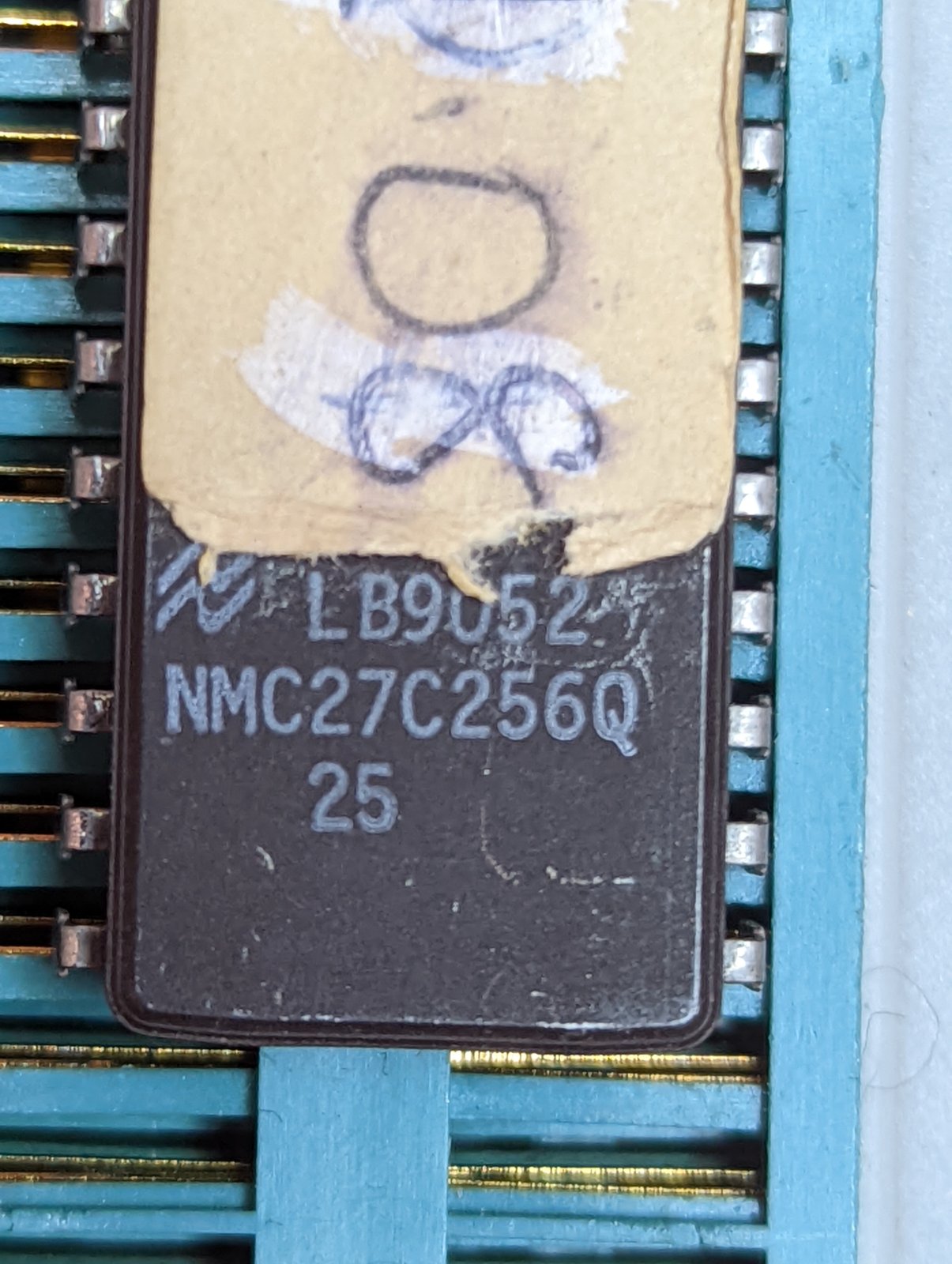

I was wondering if anybody recognised the company that made this ROM from the logo (The 2 wavy lines):
It looks damn familiar to me but I can't remember the manufacturer name and I don't want to scrape off the label any further just yet. Ultimately I am trying to dump it for preservation and also want to leave the physical ROM as unsullied as possible, but I need the correct manufacturer for it to work with my TL866 Pro.
Any ideas folks?
TIA

National semiconductor.
- Posts: 15484
Re: Chip identification - help please
Ahh, of course, thank you!
- Posts: 15484
Still didn't work until I told it not to check the chip ID.
Successfully dumped now.
