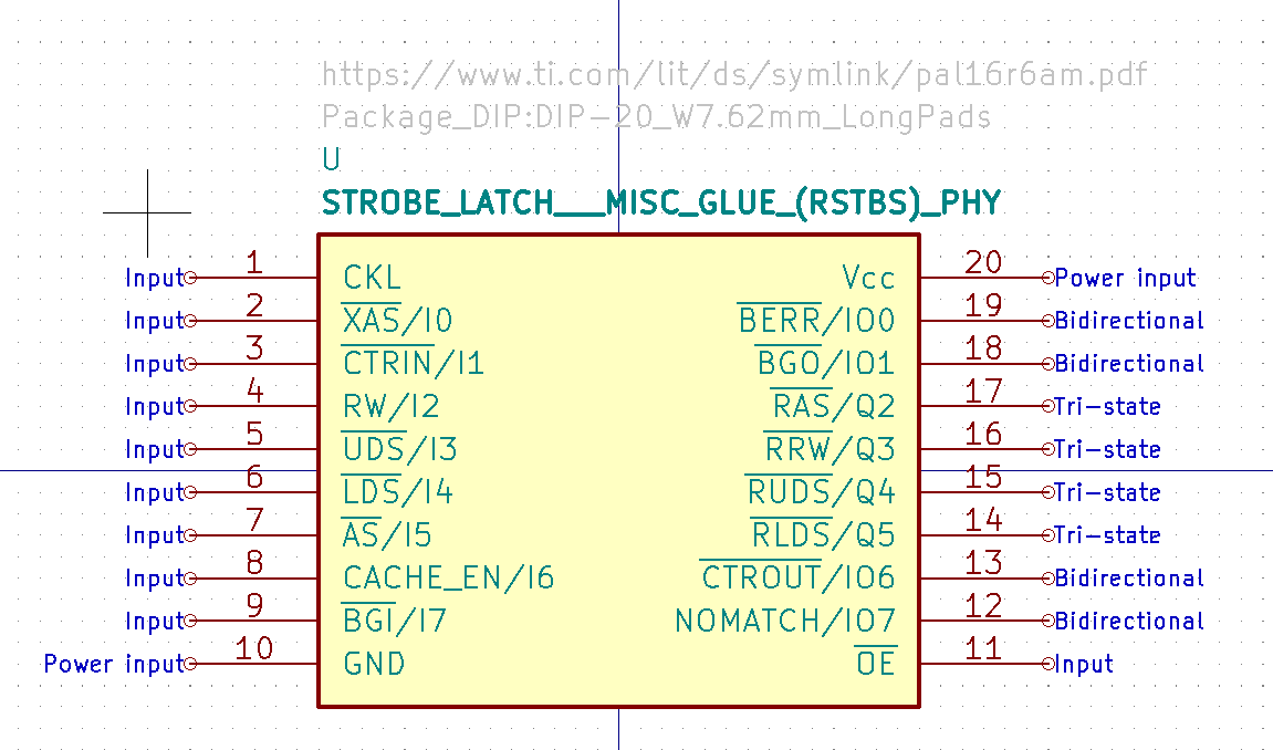

Hello,
I am curious about the PALS used throughout the Mega STe to implement the various features that makes it "Mega" (especially 16Mhz mode, cache, fpu)
Some of these PALS have their sources availables in the "Atari HQ CD1", that's great :
  • RSTBS.DOC: U002
  • SYSCTL.DOC: U011
  • CCTL.DOC: U012
  • CLKCTL16.DOC: U407
  • VME2.DOC: U904
  • SCCCTL.DOC: UA03
  • FPUCTL.DOC: UB01
But I do not find such reference material for the other PALS (U003, U006, U903 and UA02, if memory serves me right). To some extent, I can find out what are the input and output thanks to the schematics, but if someone has the formulas, that would be great to satisfy my curiosity.
(But then, I will be able to more easily make something like this :
