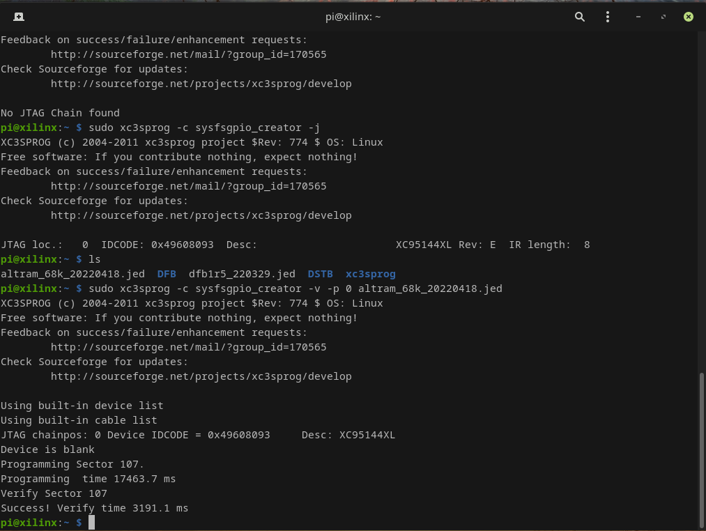

I used the 3v3 regulator from the DFB1 (all I had) which is why it looks weird with one leg bent over. Just finished programming, will test next :) I'm aware @Badwolf will be ready with a new @ijor inspired firmware soon so I'll flash that as soon as it is hot off the press ;) I could only get 50mhz Osc for this, which is fine as I ideally want to use this with a 68010 which probably won't clock as highly.

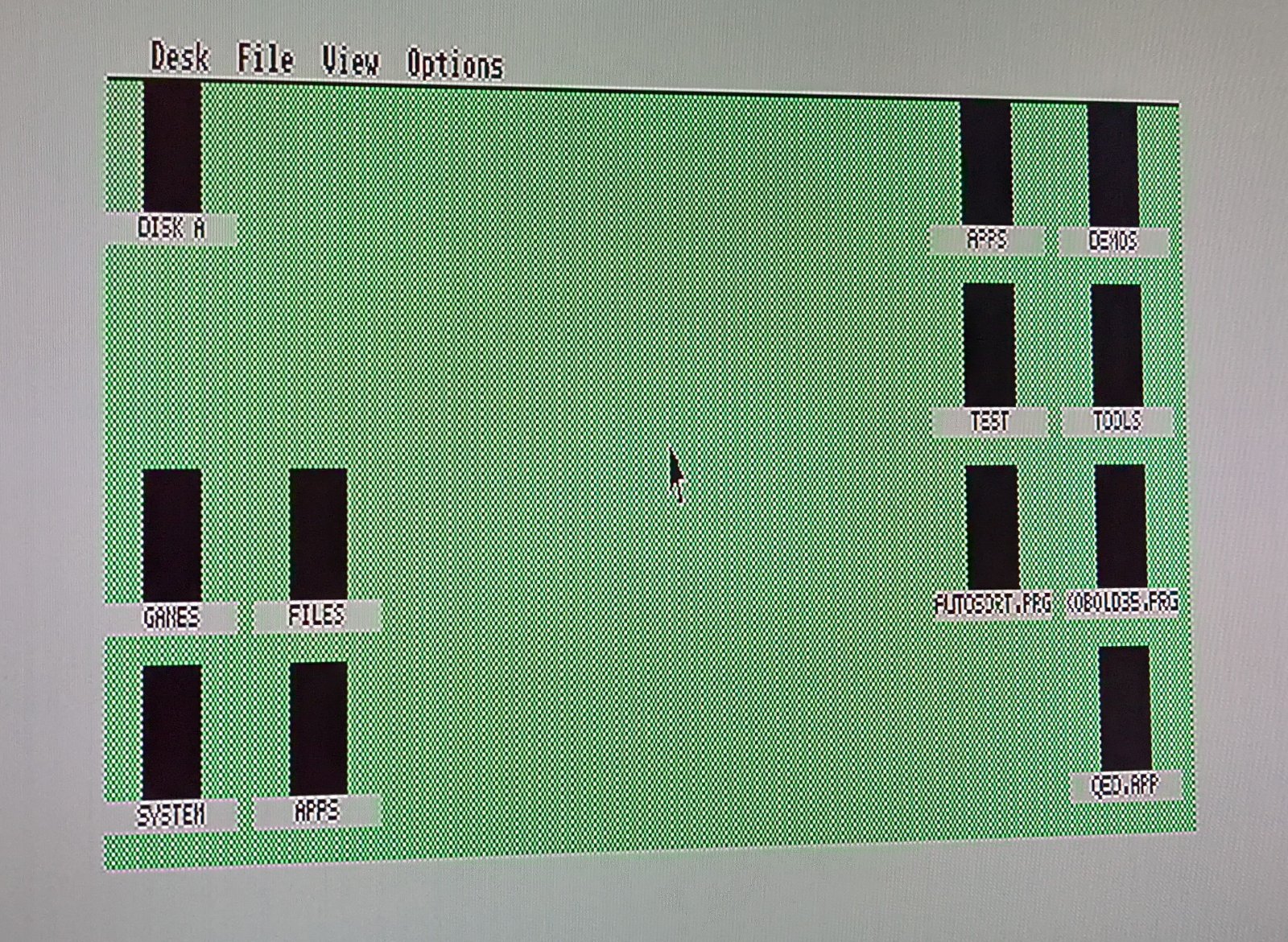

Just testing: EmuTOS Icons and screen redraws are black. Frontbench locks up at the same place each time, no bombs. I suspect the new firmware will fix these issues.
