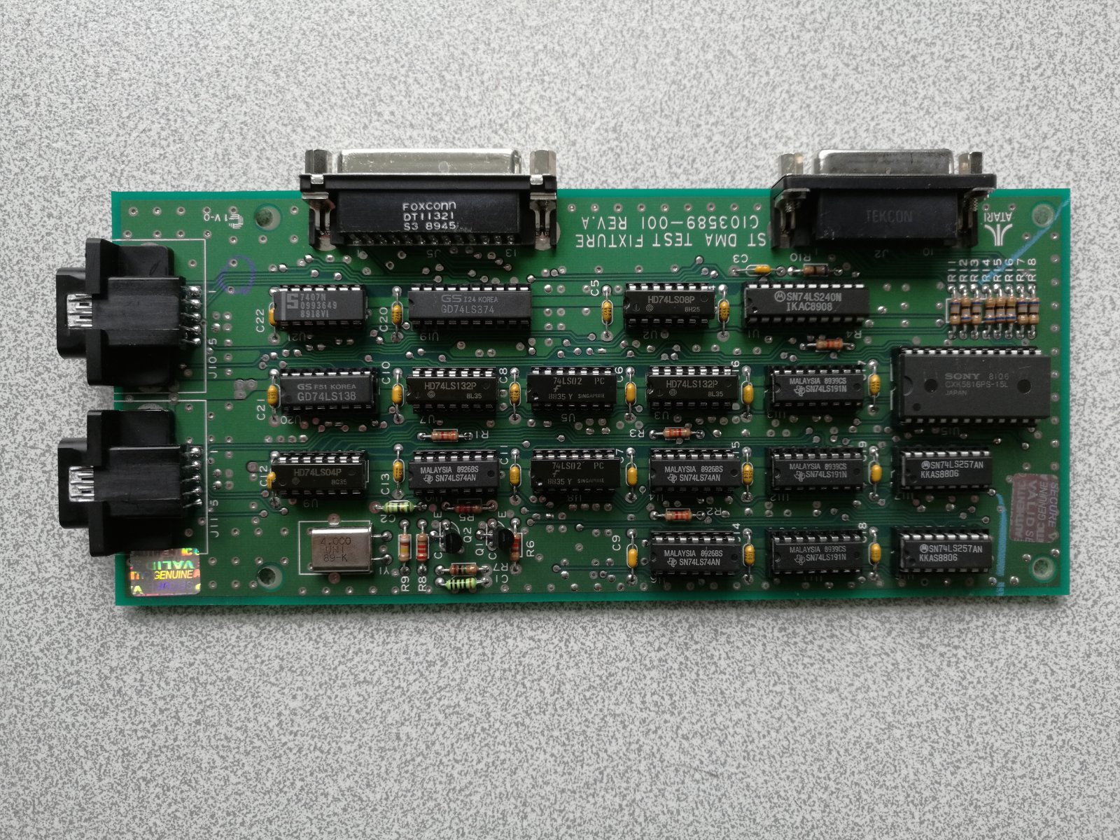

I suspect you'd need the original full test harness to perform some of the tests.
There was probably a cable that plugged into the DMA socket and looped back connections or routed them to another port.
Re: STE + Exxoshost Diagnostics Cartridge DMA Port Test, a question!
There is a PCB with cables that is attached to every port to do a couple of the test on the diagnostic cartridge. This is what the manual says about it:
EDIT: BW beat me to the answer...
DMA TESTS (D) (REQUIRES ST DMA PORT TEST FIXTURE)
Four sectors (2048 bytes) of data are written to the RAM on the port test fixture via
high speed DMA, then read back and verified. This test is repeated many times for
RAM addresses throughout the range of RAM.
TY @DoG !DoG wrote: Fri Apr 08, 2022 8:17 pm There is a PCB with cables that is attached to every port to do a couple of the test on the diagnostic cartridge. This is what the manual says about it:
DMA TESTS (D) (REQUIRES ST DMA PORT TEST FIXTURE) Four sectors (2048 bytes) of data are written to the RAM on the port test fixture via high speed DMA, then read back and verified. This test is repeated many times for RAM addresses throughout the range of RAM.
Have a look here for more info: https://www.exxosforum.co.uk/forum/viewt ... =91&t=3796
There are a few tests that require external connections, and in the case of the kit I have, it also takes power from the joystick port, so it's essential they are working properly beforehand.
Also, for the STE you will see the extended joystick port test fail since even the enhanced diagnostic harness has no test connectors for those. Threw me the first time I saw it until I realised.
