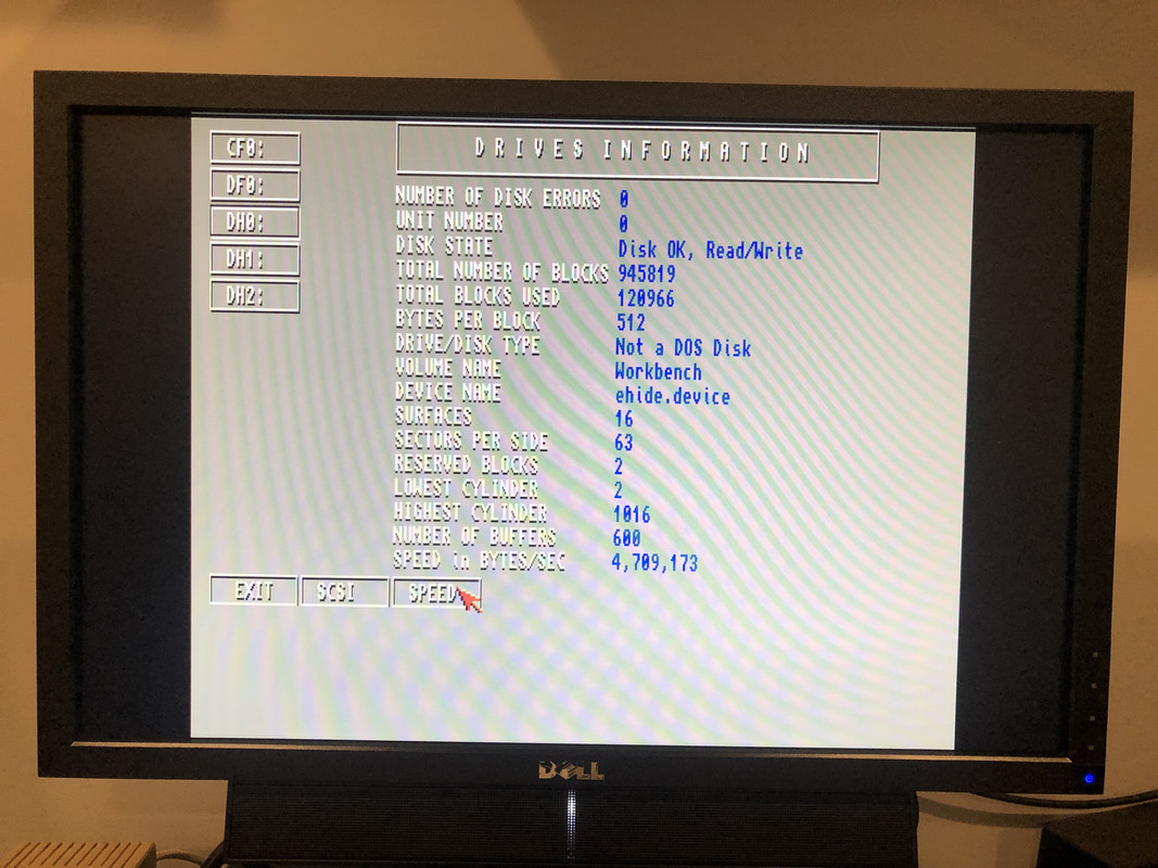

Hi Folks, I rebuilt my image onto a set of partitions with a smaller block size and can confirm that this is the problem with SysInfo. The TF IDE is lightning quick by comparison of course, but it scratched an itch to see actual data
Thanks to all for helping out.
Mark
