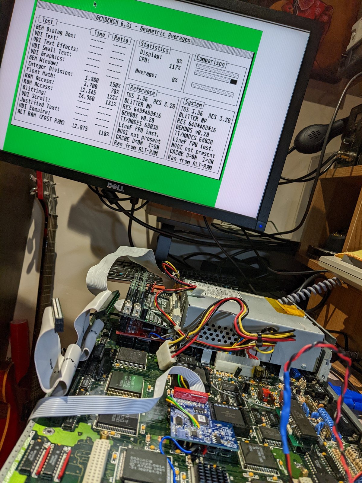

Allo Allo,
I got a lovely little device from the Thunderstorm team (@czietz, tuxie, matthias) this weekend. Installation was a breeze. I have just managed to install and do a quick test. Gembench shows 150% faster in CPU speed with lots of other improvements too. I ran the demo 'elegant machinery' to test for stability and everything ran fine. I'll do more tests that I will post here later.
FYI I haven't tried the FPU 48mhz mode yet which is why my FPU is showing slower at the moment (I previously ran at 40mhz, default is 32mhz at the moment) Can't wait to see how fast MiNT runs.
I am yet to update to the newer Storm ram expansion, but once I do the Speedy will also accelerate the RAM access which will be even faster! Awesome stuff :D

Oh, so it is a finished product after all, nice! Frankly, I'm a bit divided on this one -- not only it requires quite some desoldering but since it's using the original components (I mean the CPU and FPU), I'm a bit worried that I'm deliberately shortening its lifetime this way. Even if I find a 030 CPU at 50 MHz (I know there are PGA variants with such designation), it would be even more painful to replace as it is the SMD variant in my case. Dilemmas, dilemmas...
EDIT: The poorer thermal characteristics of the QFP package limited that variant to 33 MHz; the PGA 68030s included 40 MHz and 50 MHz versions. (wikipedia) I see that Steve's TT has the 33 MHz variant so there's nothing better to replace it with. Hmm.

mikro wrote: Sat Mar 19, 2022 6:59 pm but since it's using the original components (I mean the CPU and FPU), I'm a bit worried that I'm deliberately shortening its lifetime this way.
For the PGA CPU (I only have that), I can say that - even after hours of stress-testing the Speedy in a loop - the CPU is cool enough to touch. I once measured the case temperature and iirc it was roughly 40 - 45°C. Even if we take into account the thermal resistance between junction and case, the CPU gets nowhere near any alarming temperatures. There are chips in a stock TT that run hotter than my overclocked CPU. Thus, I don't worry about damaging my TT's CPU (or FPU).
