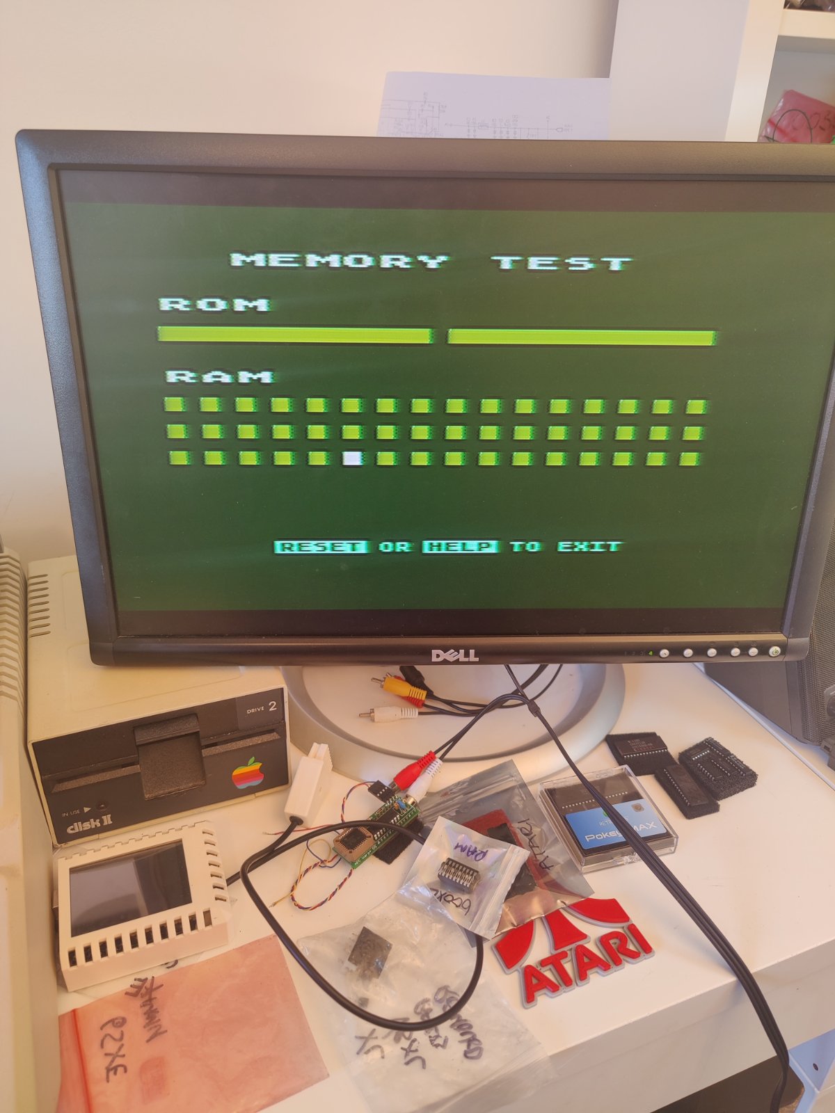

Once installed as above, test the RAM as you see fit, here I have done so with the SuperSalt cartridge:
You can however either run the internal Self Test by booting with Option held down, and selecting the memory test. If all is well you should see 50 green blocks on the screen, 2 for ROM and 48 for RAM. Any bad blocks will appear red. The white block here is the one currently being tested.
Or type "PRINT FRE(0)" at the basic prompt and hit enter. You should get the result 37902 if all is well.
