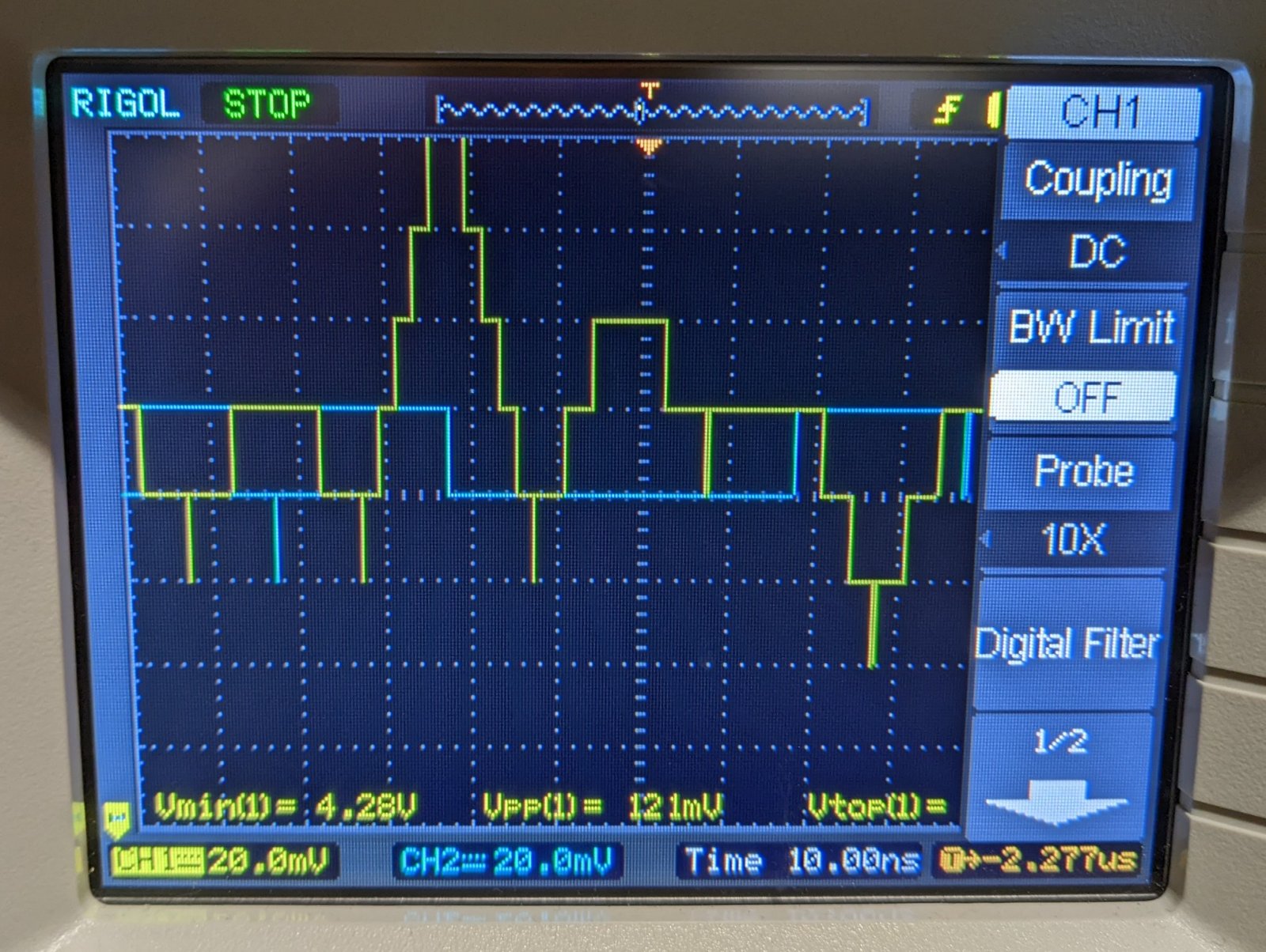

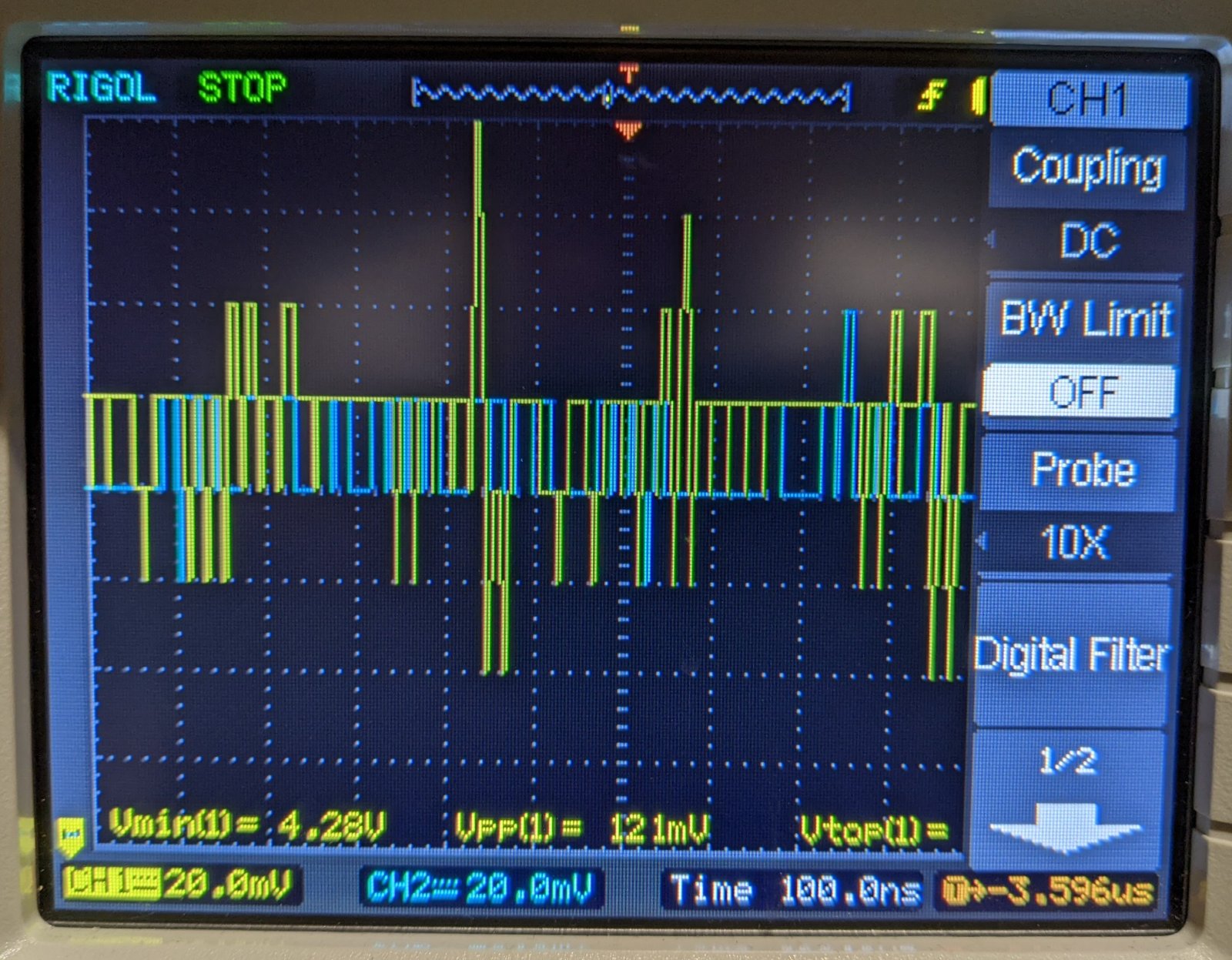

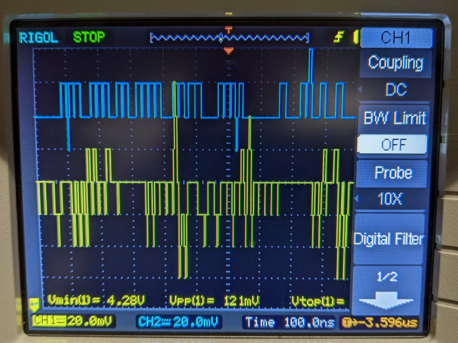

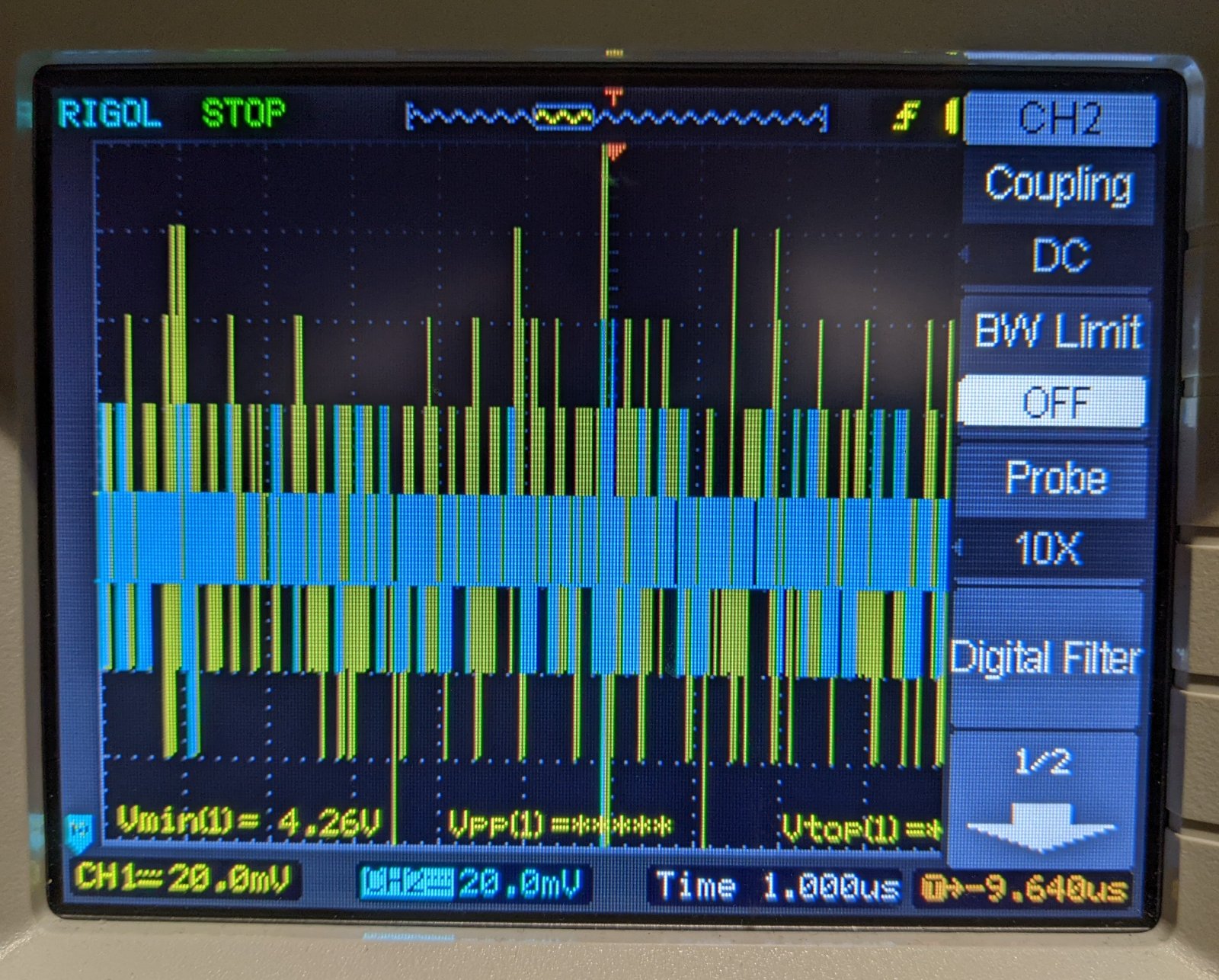

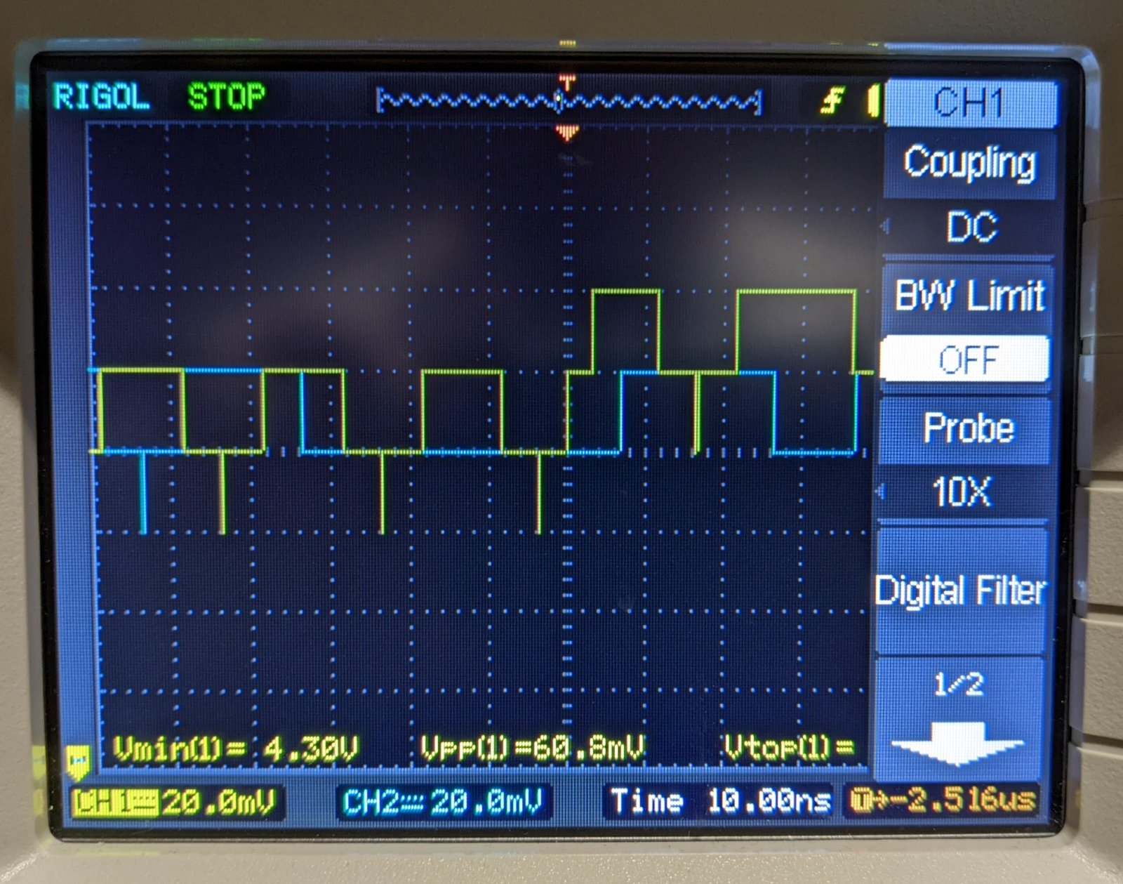

Here are some scopes, blue is 5v direct from the PSU and yellow is connected to 5v on the STRAM board.
I am not so great at reading the results, I took photos at various different zooms/scales and at 20mv for both channels.

I think that you're hitting the resolution of your scope and seeing individual samples for a start.
Variations of +-20mV aren't unusual for power rails in a digital system... they'll also be picking up RF such as mobile phone signals etc.
I think you're currently chasing ghosts.
Have a look at the actual signals on the data and address lines and forget the power rail for the time being.

Your scope appears to be set to 10x, try it at 1x, see if it's clearer.
