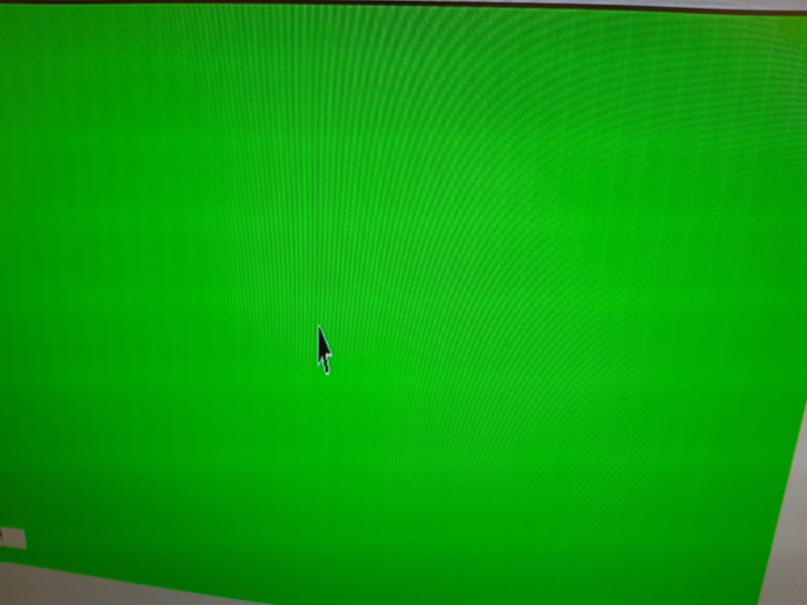

1) After fitting, faint vertical background bars occur on the screen display at 16 pixel spacing (medium resolution) and 24 pixels (low resolution), this is particularly noticable on the bright green background - less so on the dark blue background of the diagnostics rom cartridge. I suspect that the extra noise load on the PSU may be causing this? I have a Cisco 3A 5V, 2A 12v, 200mA -12v psu.

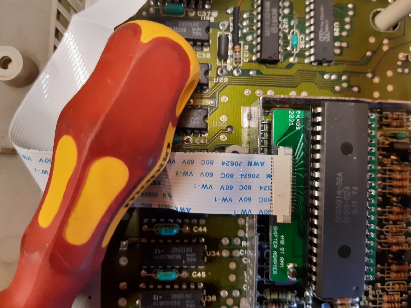

2) There is a physical collision between the ribbon RAM cable as it comes out of the shifter box with the case mounting pillar. The ribbon connector needs to be atleast 3 mm further over to the right.

Interference is very hard to get rid of on these machines. Noise comes from the power supply but a lot is just inherent in the design of the motherboard.

Probably would not hurt to put a little bit of insulation tape under the cable when it comes out of the shifter can either.

@microman noise is inherent to these machines, the output is really bad on all of them. If you think that is bad check anything that has black or dark blue backgrounds, like Frontier, it's horrendous.
The ONLY way of solving the problem is by getting yourself a RGBtoHDMI Pi device for Atari. I use this on my STM machine and it gives pixel perfect HDMI output.

Re the video background issue prior to the 4Mb RAM upgrade I had not seen it on the STM nor on the STFM. I feed the SCART into a SCART -> HDMI adapter that seems to work quite well on other vintage kit.
Looks like a long slow process with the scope and looking for earthing issues / decoupling.
