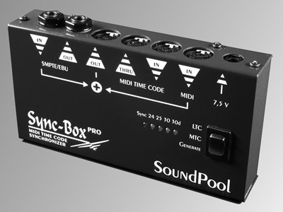

Features of the Sync-Box Pro
Professional SMPTE/EBU syncronizer and generator with comprehensive features for syncronization of computer controlled MIDI systems to audio tape. With drop-out correction and TC-refresher, MIDI merger and MTC to SMPTE converter (like Sync-Box).
LTC MODE
In LTC MODE (MODE selector switch in upper postion) the Sync-Box Pro syncronizes MIDI system to tape recorders.
Setup for LTC MODE:
  • Connect the SMPTE/EBU OUT to the input of your tape recorder (e.g. the last channel).
  • Connect the output of the tape recorder (SMPTE track) to SMPTE/EBU IN.
  • Connect the MIDI output + OUT to the MIDI input of your computer.
  • The masterkeyboard can be connected to the additional input MIDI IN.
All timecode formats are supported. The required code format has to be pre-selected in MTC MODE (refer to the section MTC MODE).
MTC IN is routed to MTC THRU. The code at the SMPTE/EBU IN jack will be converted to MTC and merged with the MIDI IN data. All MIDI data will be routed to the + OUT output.
Please note: As long as no SMPTE/EBU signal is connected to the input, all MIDI data received at MIDI IN will be transmitted to + OUT. When SMPTE/EBU reading starts, the transmission of SYS-EX data will be cancelled. Stop syncronization and switch your sequencer to internal clock when recording SYS-EX data.
Please note: Don't change the Sync-Box mode during MIDI data transmission. This could lead to MIDI errors.
Dropout correction and TC refresh: So called dropouts of the source code will be ignored up to 20 frames. You will find a new generated code at the SMPTE/EBU OUT (code refreshing).
This function can be used to renew old time code tracks.
GENERATE MODE
Setup for generate MODE:
  • The masterkeyboard can be connected to the additional MIDI IN input.
To record timecode please enable record of the SMPTE/EBU track of your multi track recorder. Start the recorder and activate generation with the MODE switch on your Sync-BoxPRO.
The generator starts with 09:59:55:00. SMPTE/EBU code with 25 frames will be generated. There are no MIDI functions in this mode.
Please note: In generate mode the Sync-Box PRO generates 25 frames format only. If other frame rates are required select the desired frame rate on the MTC generating device and switch the Sync-Box to MTC mode. The sync-Box will now output SMPTE with the desired frame rate.
MTC MODE
Setup for MTC MODE:
  • Connect the MIDI output of your computer (MTC source) to the input MTC IN.
  • Further MIDI devices can be connected to MIDI THRU.
  • Connect the SMPTE/EBU output to the input of your SMPTE slave (e.g. UnitorTM, display or mix automation)
In MTC MODE (Mode switch in mid position) MIDI data from MTC IN is always routed to MTC THRU. MTC code will be converted to SMPTE/EBU (refer to Sync-Box).
Please note: The last selected code format is valid for LTC mode. To switch to an other format, please select the required format in MTC mode. The default format after switching power on is always 25 frames.
MIDI data from MIDI IN is always routed to the output + OUT without adding a timecode signal.
