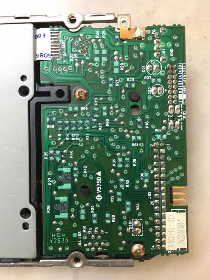

I just installed a HD7 1.44MB upgrade kit into my STE with an Epson 340 floppy drive and I'm trying to understand the media change wiring.
Having pulled the shield off the drive, it appears to have a slightly different PCB revision to the one shown in https://blog.troed.se/2017/01/20/the-ta ... i-mystery/. That said, my multimeter indicates:
- The second pin from the edge of the drive->PCB connector toggles between 5V (no disc/1.44MB disc inserted) and 0V (720KB disc inserted)
- Pin 2 of the floppy connector sits at ~4.5V irregardless of whether a 720KB or 1.44MB disc is installed or the drive is jumpered to use an internal or external HD select signal
- The (unnconnected) drive select via on the HD7 board sits at 5V
I had thought that only the drive ribbon cable pin (connected to the HD detect sensor) would toggle, and then pull up the input to the HD7 board - is that not the case? I'd like to understand the behavior before connecting everything up - thanks!

Re: 1.44MB HD7 media change wiring w/Epson 340
The HD select wire is 5V when 1.44 is inserted and 0V when 720K is inserted. I think troed routed it via the floppy cable somehow, but i've never even had one of those drives to even figure it all out. Other than troed, I think he is the only person who attempted it.

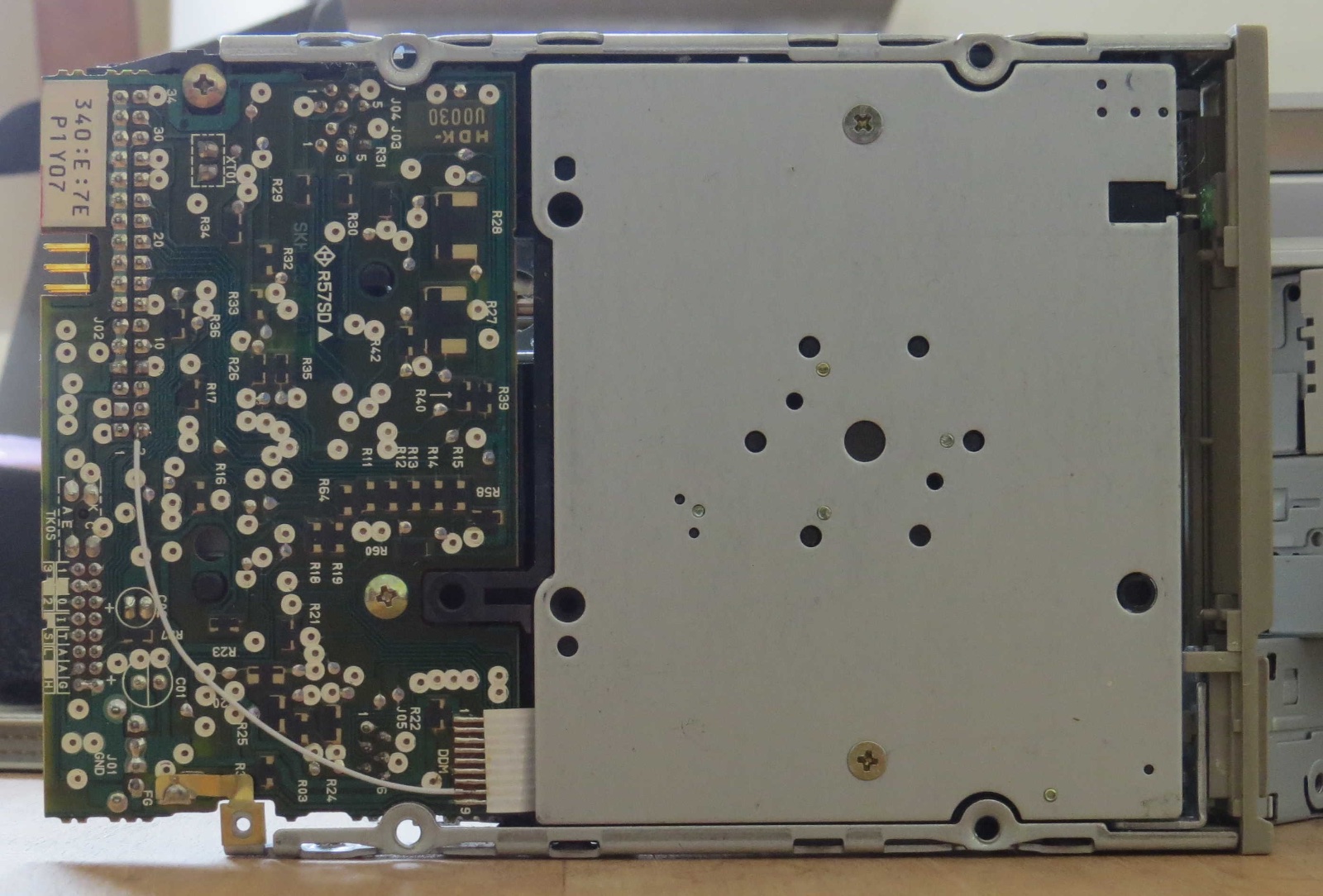

Just so that we're clear on the workings. HD mods work "backwards" from how Atari implemented it*, sort of. We use the fact that the drive signals whether it has an HD or DD disk inserted, and route that signal to the HD mod PCB. The floppy cable isn't involved - you just wire the pin you found to the HD mod.
I thought I had documented another board revision as well, found on an Epson 349 .. let me see. Hmm. Not more than having a photo ...
/Troed
*) TOS 2.06 doesn't make use of any HD signals at all but just tests whether it's able to make some sense out of the drive when using either mode. To do this, Mega STE and TT have a PAL that can be poked from software to change the speed of the floppy IC.
/Troed
EPSON HD Modul Mod ...
