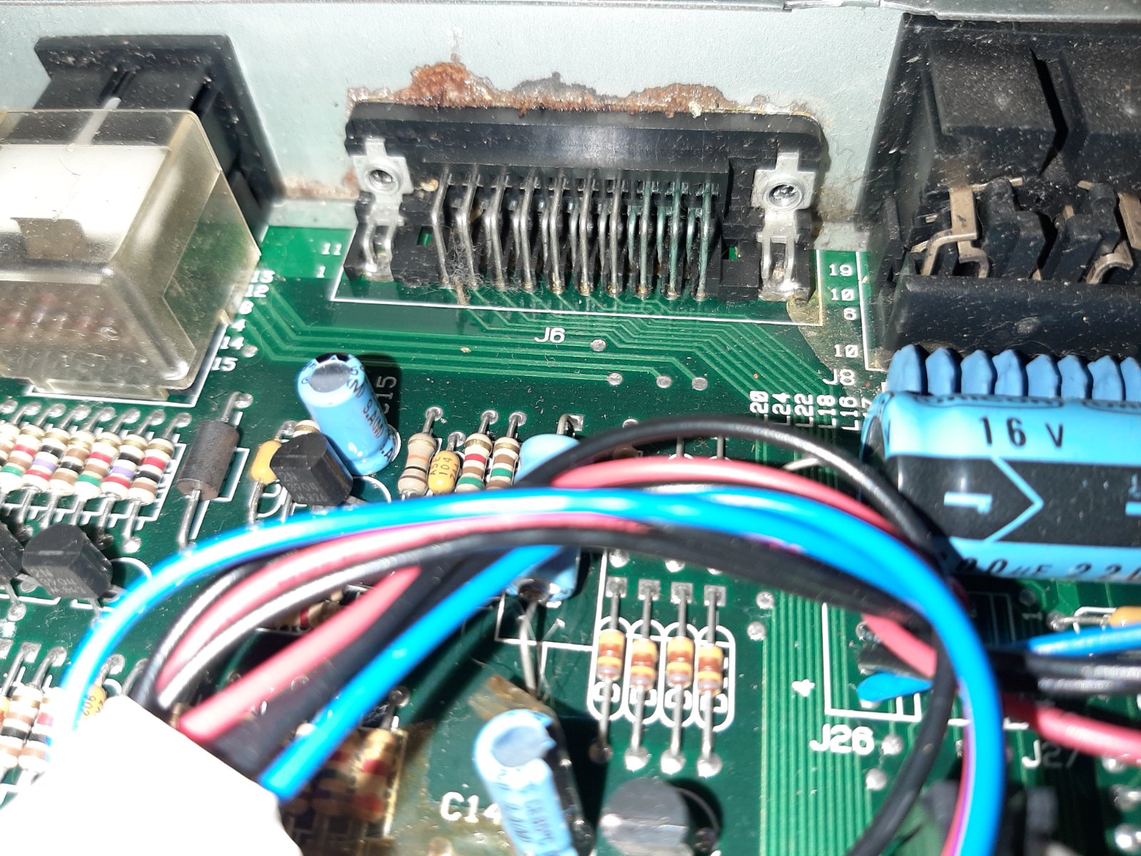

Hi,
i have a working Stacy1 which needs some care :
- led screen sheet replacement
- Rear ASCI, floppy, screen (...) connectors replacement
- 4M RAM upgrade
I think i will also add an SCSI2SD to replace the existing drive and maybe a Goex drive too.
My questions :
- There is a lot of ASCI connectors on exxos store, wich one should i use ?
- I'd like to upgrade it to 4Mb. It is possible with a stfm kit (once it will be back in stock) ?
Thanks.

Marsupilami wrote: Fri Nov 19, 2021 11:13 am - There is a lot of ASCI connectors on exxos store, which one should i use ?
Cannot really say, there are that many different types of them. I'm trying to find a thread I wrote on this.. You can only really go one which physically looks the closest. Unless yours has a part number on top of it.
Marsupilami wrote: Fri Nov 19, 2021 11:13 am - I'd like to upgrade it to 4Mb. It is possible with a stfm kit (once it will be back in stock) ?
I assume you can use the MMU "plug in" variant. But I am not aware of and of anyone ever fitting it to a STACEY.
https://www.exxosforum.co.uk/forum/viewt ... =78&t=2403

exxos wrote: Fri Nov 19, 2021 11:49 am
Replace the 8x 256kx4 chips with 1MBx4 chips and add the MAD9 line ...
Like in a Atari Mega ST1

I know no one likes dealing with Best Electronics, especially from overseas, but
Brad does offer a trade in program for certain STacy memory boards. I had a 2
meg board and he allowed me to trade it in for a 4 meg version. I don't think
he does the 1 meg version, but it wouldn't hurt to ask...
Just a thought.
BTW, where was that STacy stored to get that much corrosion? Ugh. :)

Darklord wrote: Fri Nov 19, 2021 6:49 pm I know no one likes dealing with Best Electronics,
Ordering from Brad is not the easiest thing in the world indeed.
Darklord wrote: Fri Nov 19, 2021 6:49 pm BTW, where was that STacy stored to get that much corrosion? Ugh. :)
I don't know. I got it like that. I guess it was laying on the floor in a garage and the plug side down...
frank.lukas wrote: Fri Nov 19, 2021 11:57 am Replace the 8x 256kx4 chips with 1MBx4 chips and add the MAD9 line ...
Well, i don't have the skills for surface mount chips...But I might ask you to do it one day, after the great repair you did on my TT and very recently on
my Falcon RTC...Would you do that for me Frank ? :)
exxos wrote: Fri Nov 19, 2021 11:49 am Cannot really say, there are that many different types of them. I'm trying to find a thread I wrote on this.. You can only really go one which physically looks the closest. Unless yours has a part number on top of it.
I don't have any part number on it. So i just ordered all 3 types you have in your store :lol:

Marsupilami wrote: Sun Nov 21, 2021 8:24 pm Well, i don't have the skills for surface mount chips...But I might ask you to do it one day, after the great repair you did on my TT and very recently on
... if no one else does it, i can do it.
