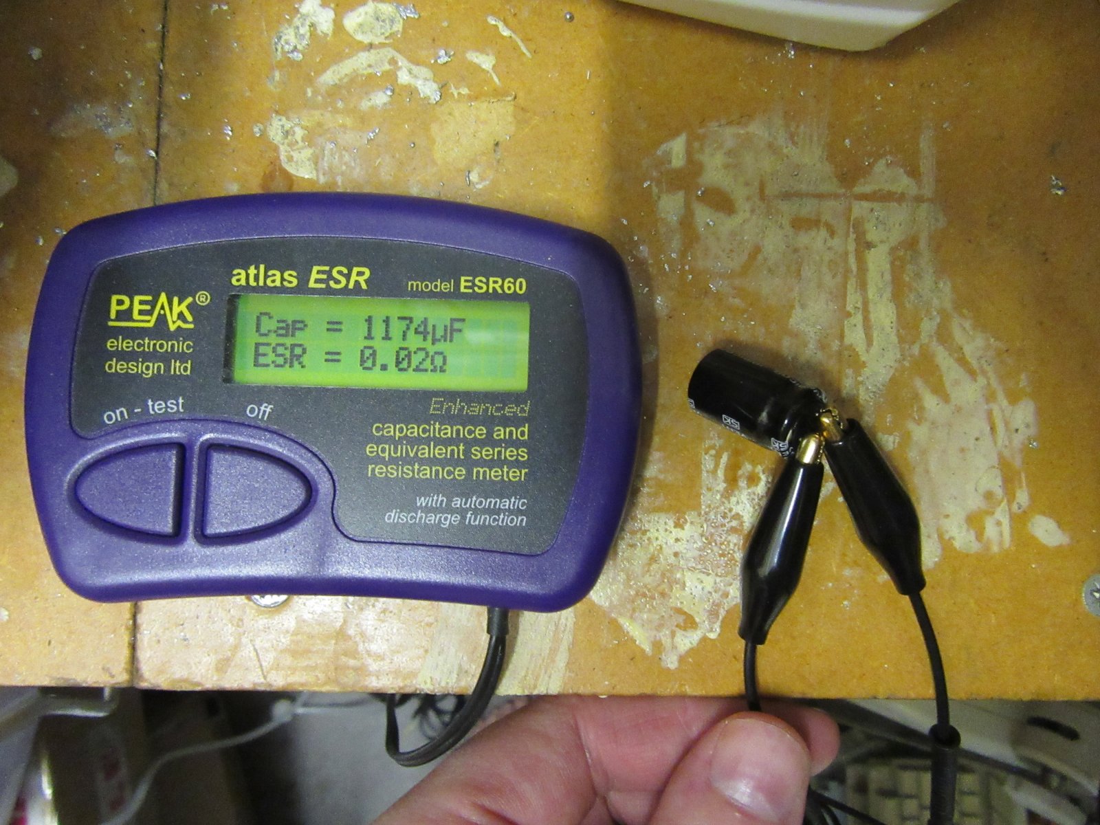

CASE 1 - 1000uF JAMICON
1,000uF capacitor @ 20% tolerance , 800uF - 1200uF
COLD - 1106uF 0.06R
HOT - 1174uF 0.02R
This one seems to be within 20% tolerance but the actual ESR value varies somewhat.

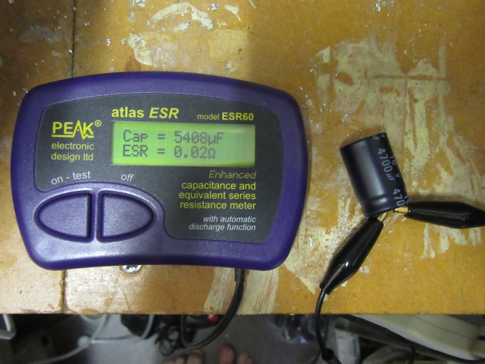

CASE 3 - 4700uF WANGS
4,700uF capacitor @ 20% tolerance , 3760 - 5640uF
COLD - 5052uF 0.00R
HOT - 5408uF 0.02R
ESR actually gets lower as it heats up and capacitance increases.
COLD - 1106uF 0.06R
HOT - 1174uF 0.02R
COLD - 5052uF 0.00R
HOT - 5408uF 0.02R
