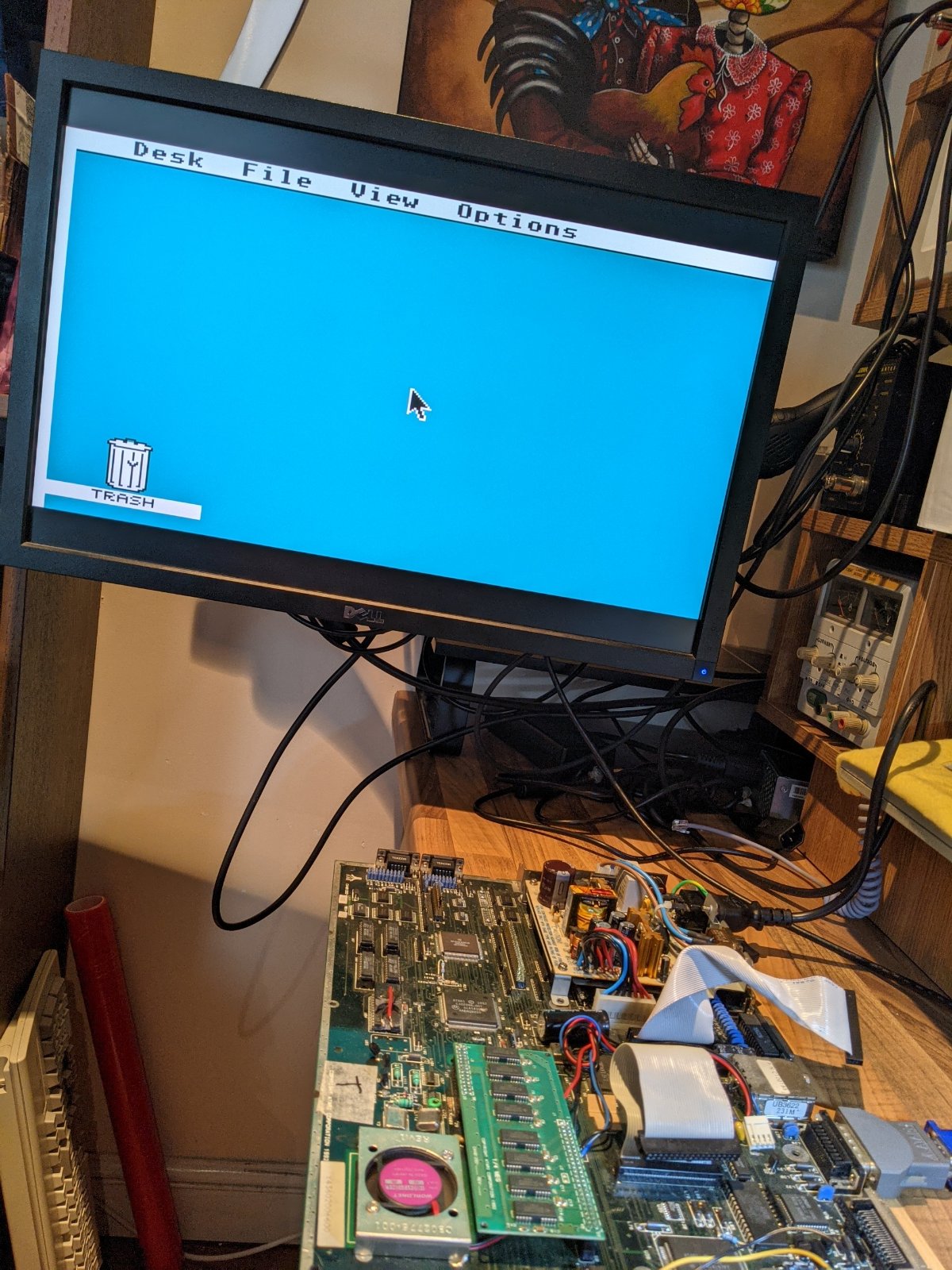

Hi guys,
Just working on Tony's Falcon.
We are doing:
  • PSU recap
  • Falcon motherboard re-cap
  • Reverse old clock patch
  • Exxos clock buffer
  • Exxos NVRAM
  • Exxos RAM board
  • Install FPU
  • Install Fast TOS 4.04
  • Disable wait states
  • Install Openflops drive
Link to motherboard high res photos
Just checking to make sure it's working as expected to begin with

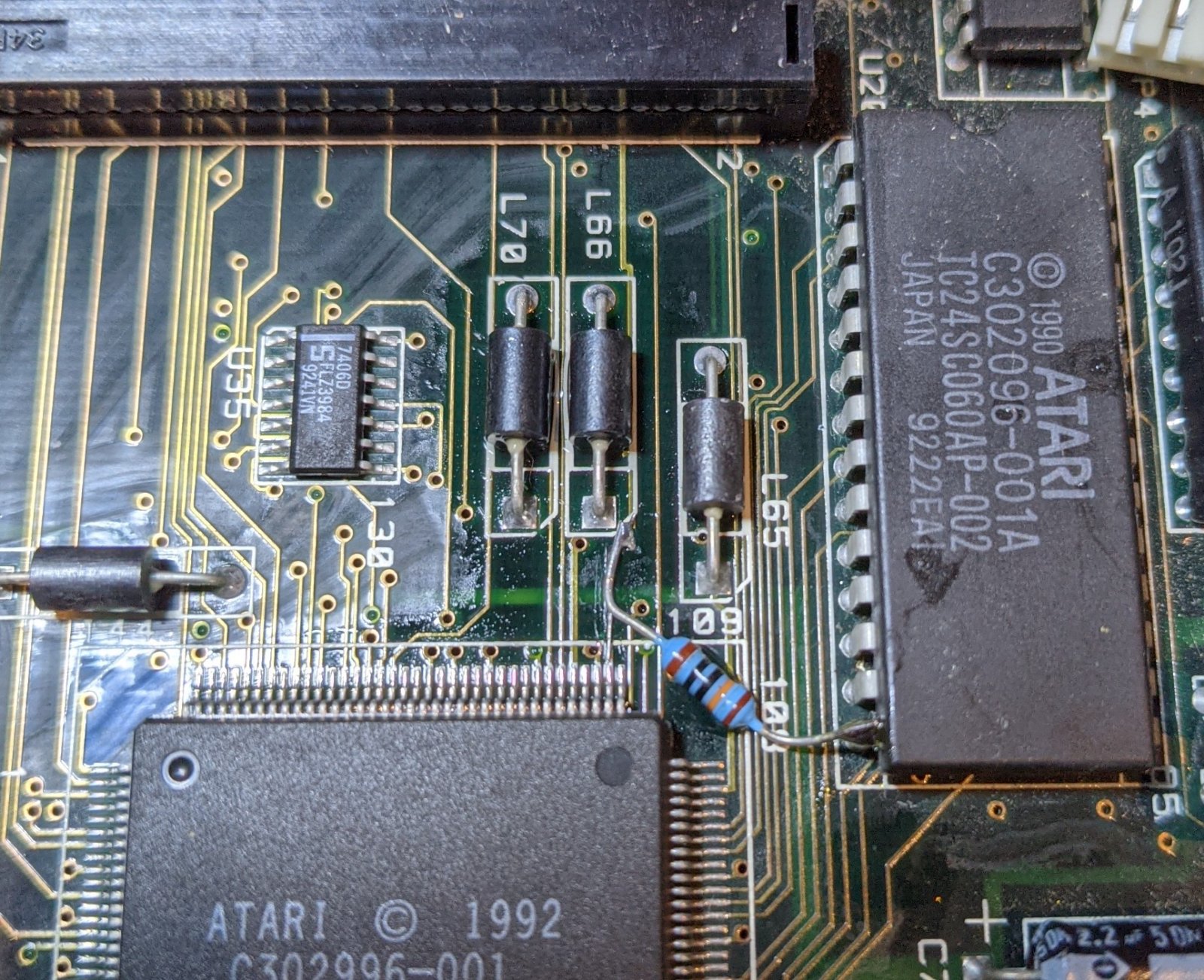

Clock patch removal / fix / install Exxos version. This resistor is the old ct60 'patch' and is very obsolete/bad
Removing the resistor (carefully) reveals the trace has just disintegrated
Some fine patch-work to recreate the trace
Remove all these resistors to install the Exxos patch
Voila

@Steve Don't forget there is a SMT resistor to go one the SDMA end..
Posts: 3409
Re: Tony's Falcon service blog (Nov 2021)
exxos wrote: Mon Nov 08, 2021 10:17 pm @Steve Don't forget there is a SMT resistor to go one the SDMA end..
I thought we only added that if required, I was going to do some tests to see if it was needed (I've only had to add it to one falcon so far)
Posts: 29555
Steve wrote: Tue Nov 09, 2021 9:07 am I thought we only added that if required, I was going to do some tests to see if it was needed (I've only had to add it to one falcon so far)
It's listed on the install page and I don't mention it's optional. Even if it works for some weeks, doesn't mean it always will. Ambient temperature could change enough to cause things to malfunction.
Posts: 3409
Ah okay then. So we should be adding that all the time now, no problems.
Posts: 3409
@exxos Job done boss :2k2:
Posts: 29555
Steve wrote: Tue Nov 09, 2021 1:52 pm @exxos Job done boss :2k2:
:bravo:
You may want to put some hot snot glue over it because soldering a resistor to a small track is not very mechanically robust.
