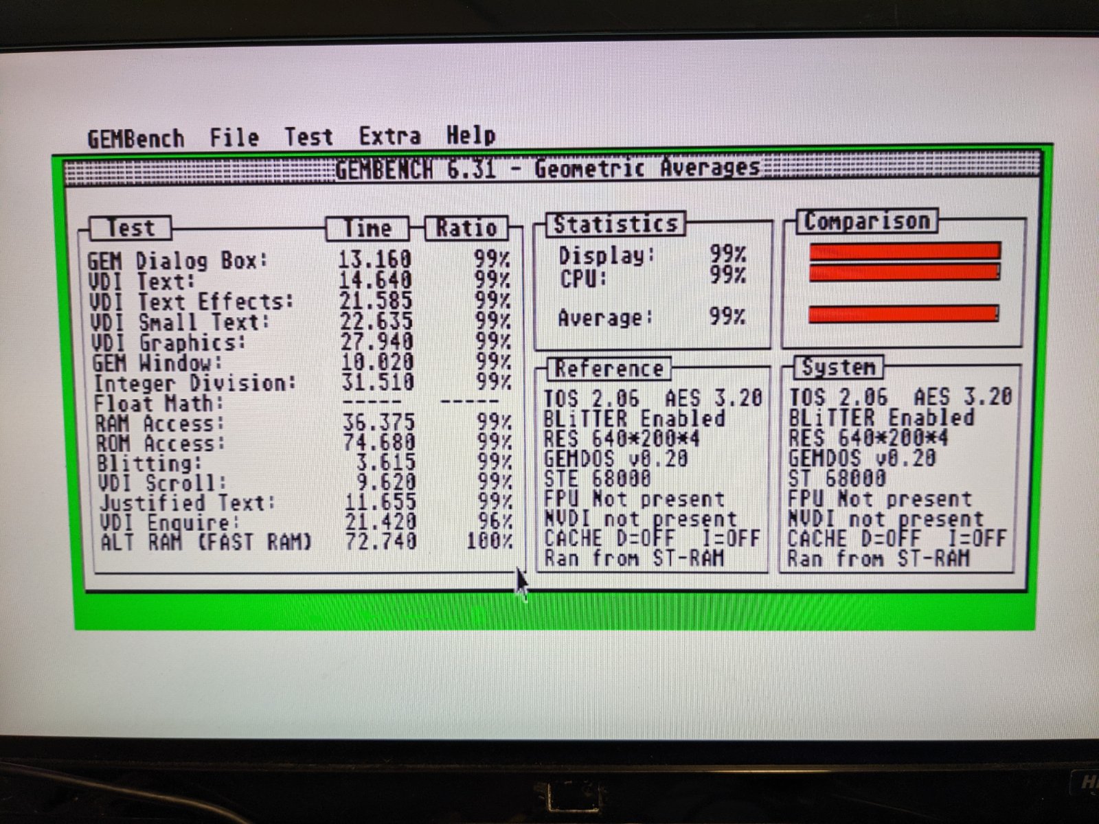

Not sure if these numbers are good bad or average...

You are comparing your machine to a STE (has blitter) to your machine which with the blitter disabled. So of course you will get strange results. As I keep saying, read how to use GB6.
Posts: 4443
Re: Running GEM Bench and HDD tester on Mega 4
Although you have TOS206 installed, your machine should be compared to a stock STFM which the Mega is based on.
The test file is STFM1048 - STFM TOS 104 @ 8mhz (stock machine)
This will show you how improved from stock your system is running.
As @exxos mentions you are comparing with the default test file which is a stock STE DEFAULT - STE TOS 206 8mhz stock
If your Mega has a Blitter turn it on and then can see how it compares agains STFM stock and / or and STE stock.
Lastly a tip is that even if you have run the tests by loading a new test file the values will all be recalculated to show the difference you don't have to re-run the tests. This is handy if you want to quickly compare how your system compares to others.

Yes I turned it on and reran the tests. Also did the HDD test with Blitter instead of PIO.
