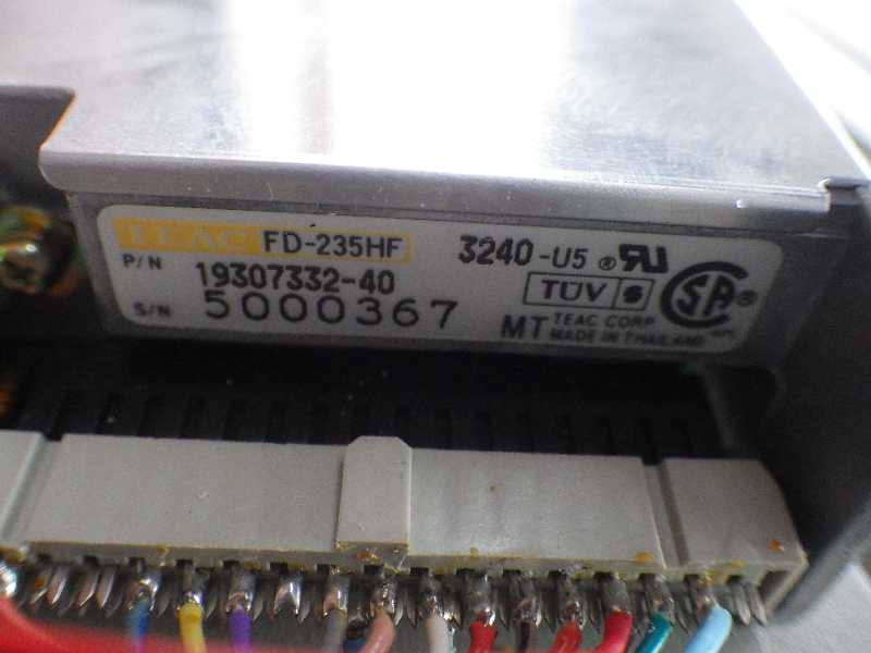

Inside there seem to be a TEAC-FD-235HF drive.

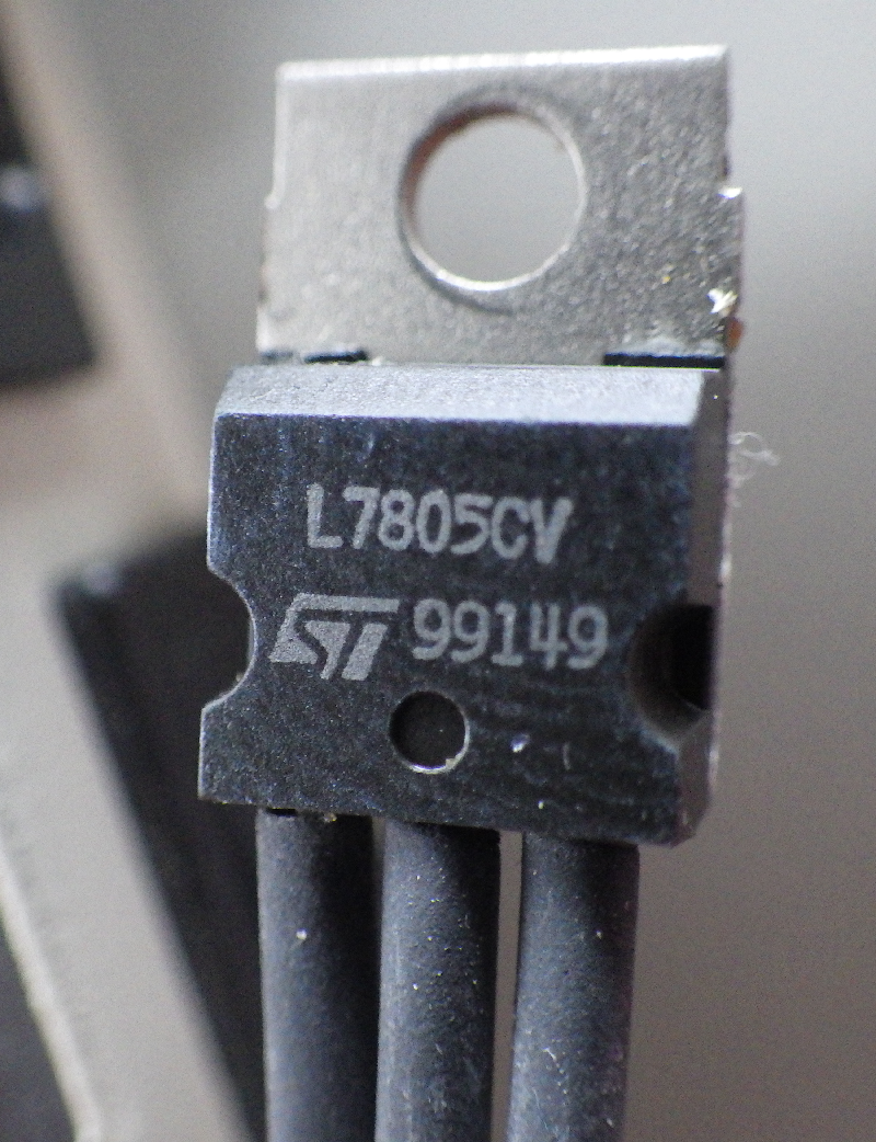

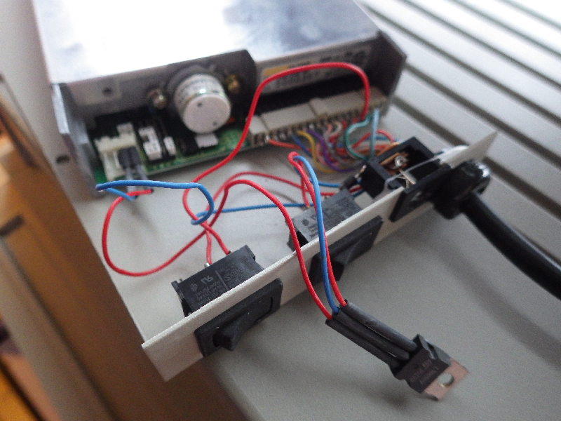

Does the regulator have power input and output ?
It also should be bolted down somewhere .. They run hot and die otherwise.

I get 1.97v on the pin 1 and 2.48v on the pin 2exxos wrote: Thu Oct 28, 2021 3:21 pm Does the regulator have power input and output ?

Do you have your negative probe actually on the tab / case probing the left and the right pin ?
You should have something like 12V on one side and 5V on the other.

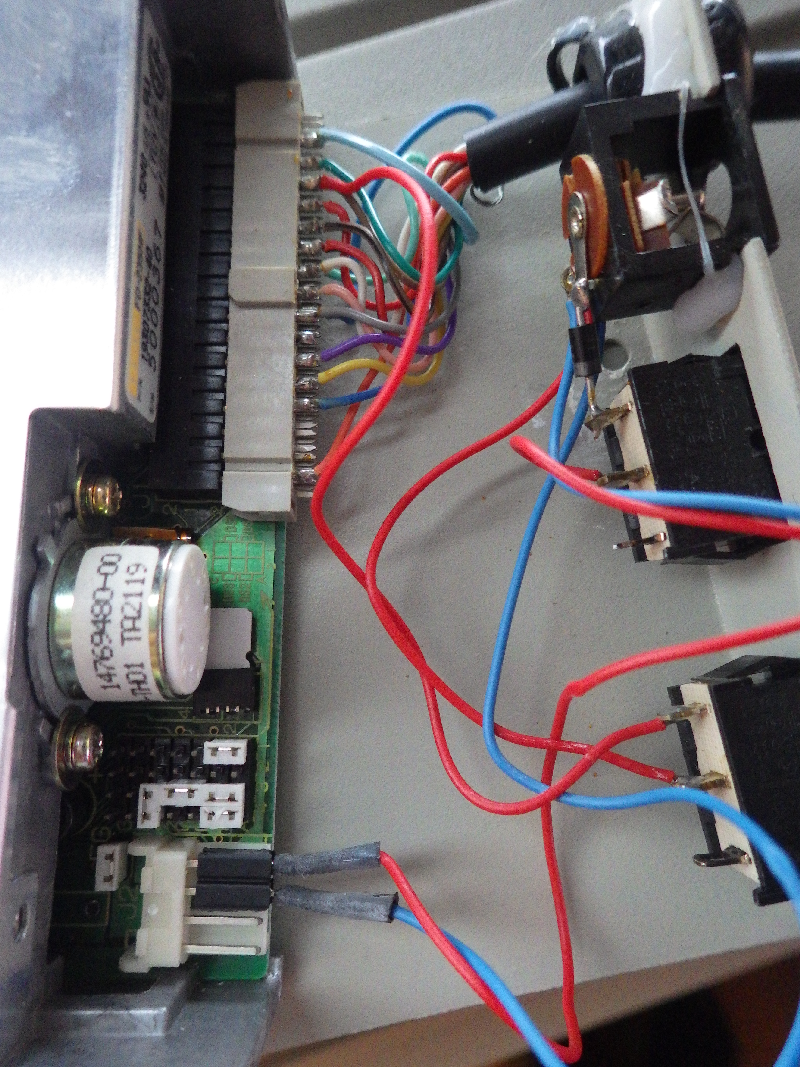

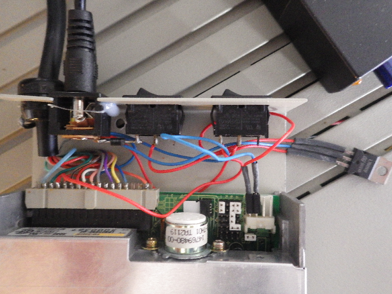

I actually get 5V if I put the negative probe on the floppy disk metal shielding and the positive probe on the red wire that connects the floppy disk IDC connector to the rocker switch.
The double switch puzzles me.

Center pin seems to be positive. The regulator can take up to 35V and it has a 2V dropout and output is 5V so 7-35V in.
Both switches seems to be for power. Right one, seen from back, closest to the FDD cable. If it is ON the barrel jack is used (left OFF). If left one is ON (and right OFF) then power is taken from FDD cable somehow.

I have a Datel unit with a 'similar' 7805 setup and feed it 9-12v for power. The 14 pin plug has no power on it, just control and data signals.

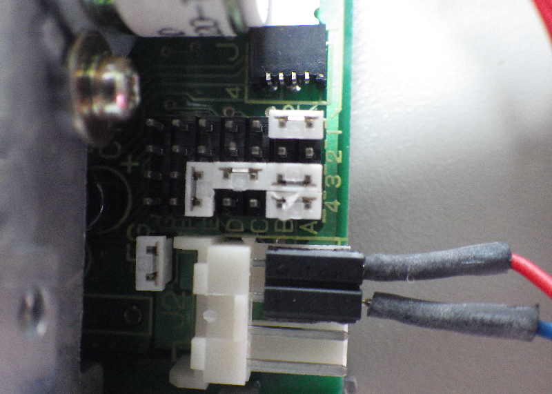

I'd also check for disk ID, it should be DS0.
According to the pinout for the 34 pin connector, pin 7 is what appears to be connected to that switch, but I don't believe it is used, so not connected. 1,3 & 5 are marked as 5v though.
