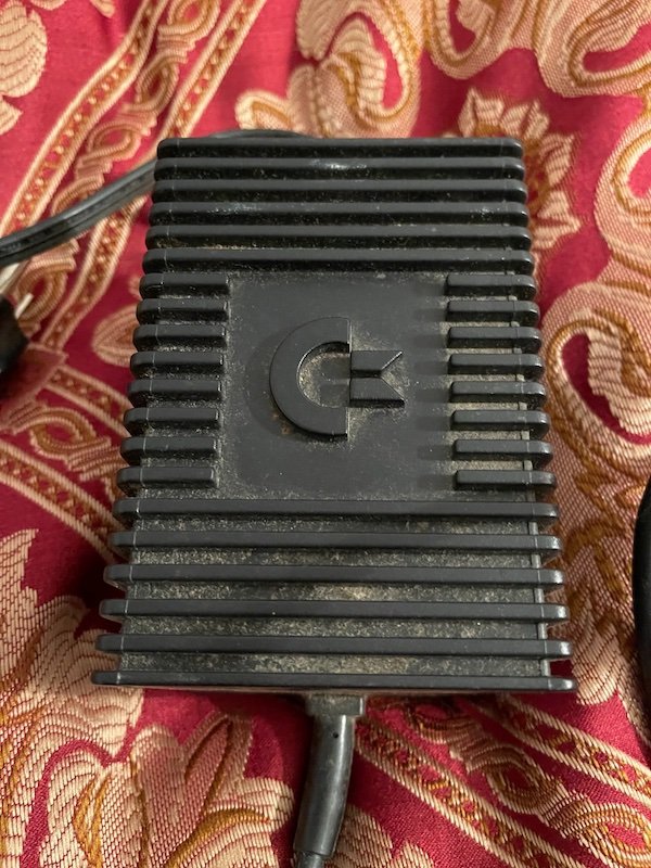

This is super embarrassing but I just got my Amiga CD 32 out of storage and for the life of me I can not get the power plug to plug in
to the console. The pins do not look bent at all but the pins do not look like they line up to me. Here is some pictures let me know if everything looks correct.

That power supply is not for the CD32 , you have the wrong one there it is for another commodore model

I could be wrong but I think that PSU is for a C64 or Vic20?

The CD32 requires 12v and 5v DC power inputs, so as previously posted wrong power brick, your brick is indicating 9VAC and 5VDC :)

That is for a C64 and or 1541, they are not compatible. If you need a new Amiga CD32 PSU we do sell them here: https://www.retropassion.co.uk/product/ ... -for-cd32/

Thanks guys it is a 20 year old mystery is to how I stored my Amiga CD32 with a C64 power supply. I sold my C64 long ago with the power supply before I got my Amiga CD32. I was going to buy a new power supply anyway to accommodate the TF330. Thanks for all of replies.
