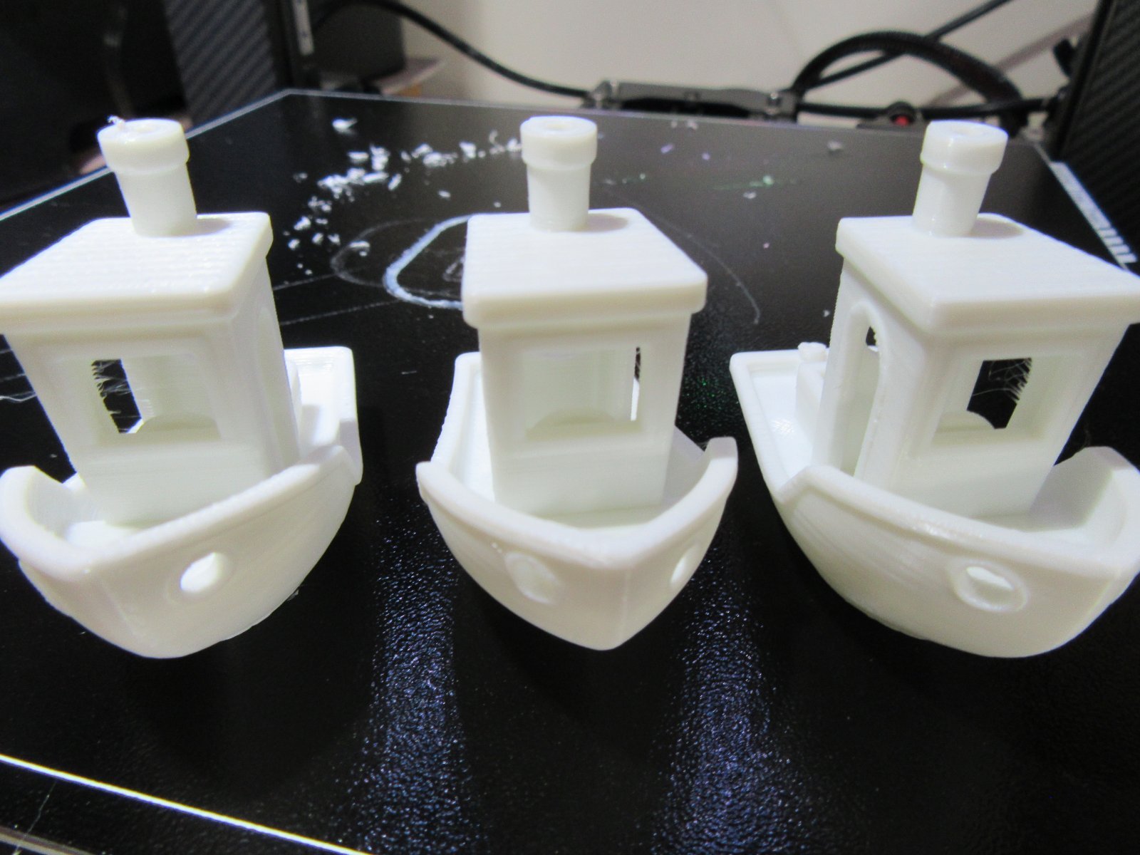

The good points : it seems well constructed but a lot of the screws even on the pre-assembled parts were actually loose. I first benchy out of the box printed amazingly well.

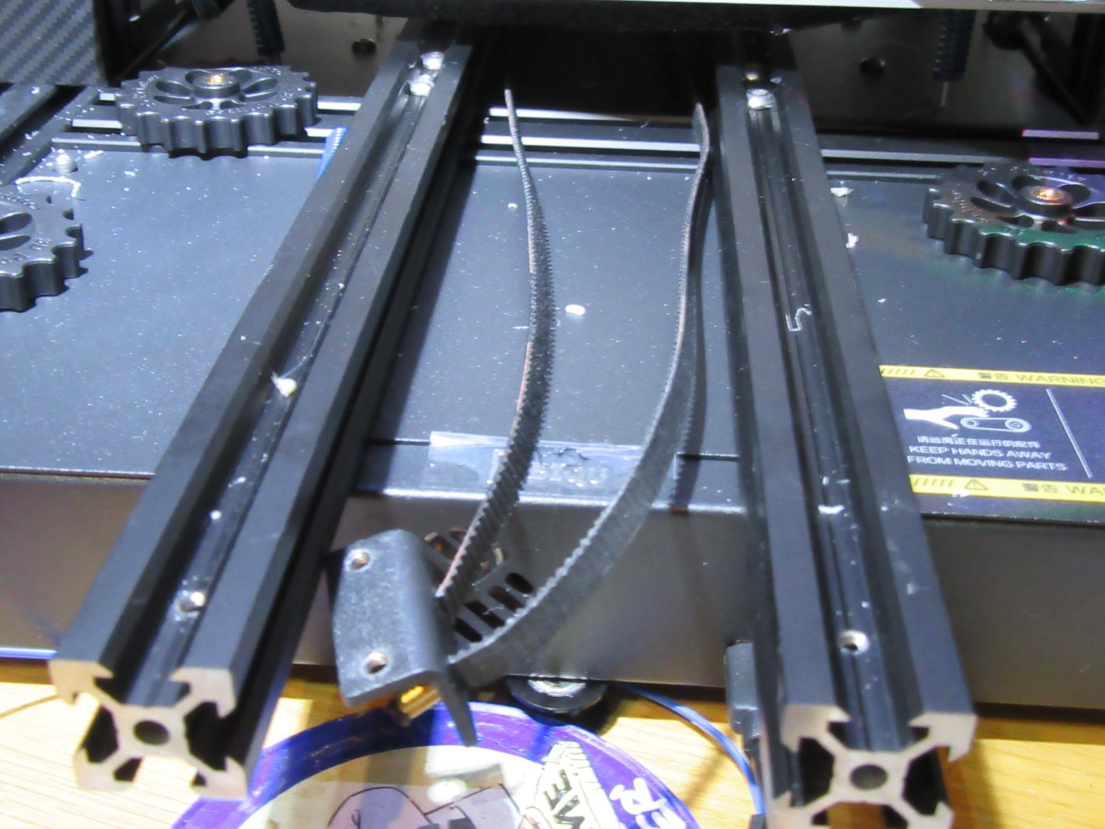

Dismantling the bed to straighten it out.

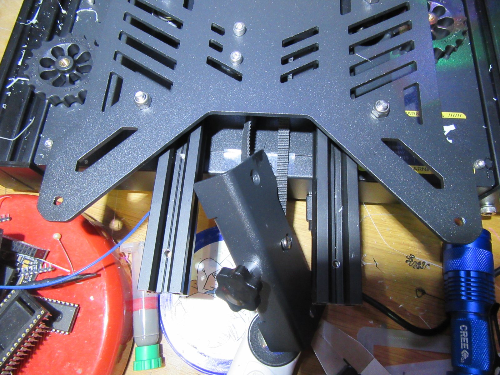

Trying to print in PETG now. This stuff Is like a cross between latex and chewing gum :roll:
You can also see the destroyed printer bed. The white parts at the front I have not yet been able to remove.
