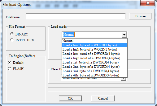

Without any googling, I may tell you, that you can do the same with the MiniPro/XGPro software ;) You only have to remember that "low byte" will be high ROM, and "high byte" will be low ROM, and it is due to the different endianness of the Intel and Motorola CPUs.
