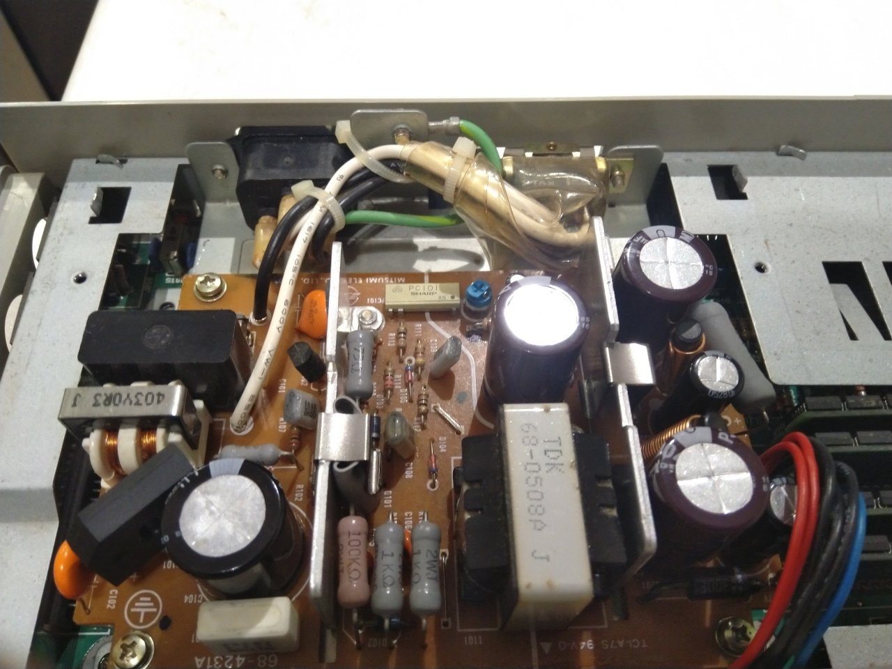

You'll need to take some more thorough photographs if you'd like us to try and visually identify anything, top side, different angles and underside. Be very careful as you can get shocked if you've had it on recently, I'd recommend unplugging it from the AC and turning the psu to 'on' to drain any power out, then turn it back off again.
edit: you may as well just wait a few days for your friend to have a look. By the way the rectifier looks twice the thickness of the one Exxos provides in his kit. Did you also replace the resistors & the diode update from the guide?

Thanks for your reply Steve. I will wait, the best I could do myself is to measure with a multimeter. The rectifier is KBU1005G.
https://www.mouser.com/datasheet/2/395/ ... 248375.pdf
Same part as mentioned by exxos. Well, almost, because I see the G at the end. Seems like it replaced KBU1005 since the later is obsolete. I can take better pictures in the following days.
