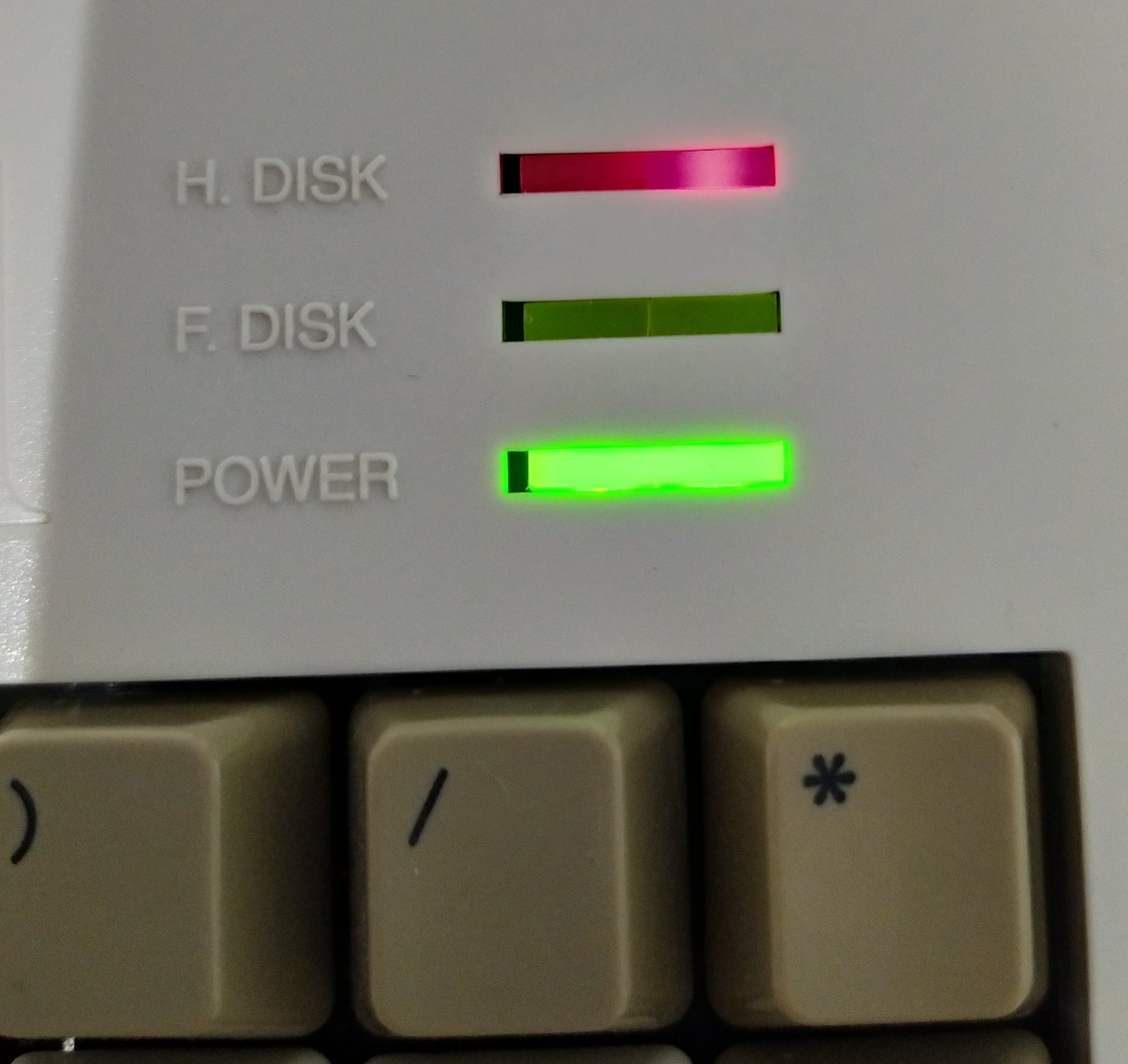

I got my Light Hack done.

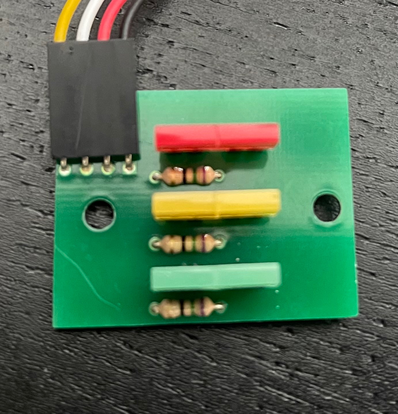

I had an AmigaKit A1200 keyboard LED panel sat waiting for my A1200.net case.
They use 2 LEDs side by side. So I cut the tracks and did a bit of rebuilding to get 1 LED working for A1200 IDE, then wired an extension from my CF adaptor (pins 41 +5v & 39 activity signal) to my AmigaKit LED panel.
Because the HD access LEDs are now not in series I increased the resistance.
So left is A1200 IDE and right is TF IDE. Seems ok

Hi - bit late to this but Higgy’s solution sounds pretty great to me. I’ll be ordering up an Amigakit LeD today. Just wondering if anyway has any photographs or idiot instructions on this?

When your AmigaKit LEDs turn up, can you take a pic of the back and PM me it please.
I should be able to mark up the picture with what I have done.

Finally, finally arrived!
Any advice as to the required modifications would be much appreciated!
