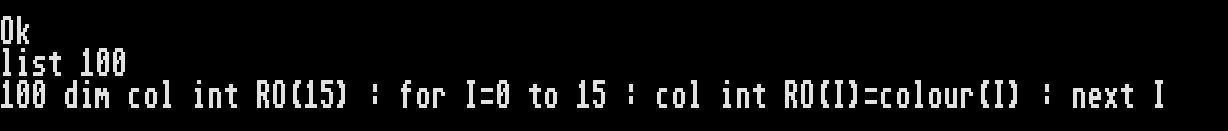

Oddly that does compile and run.. But the ASC file does like what I found..
But in the actual BAS file..
So I don't get why the ASC behaves differently than the BAS file.
In fact you cannot even run this from the command line..
Which Is why I renamed them all..
So I don't know how they got from the ASC file and imported it with loads of invalid syntax. I went through all that one by one last night and corrected it all. So it should not even run with what they have. Again can only assume because they are using older versions of stos.
Seems to be some extensions causing some of these issues. So others may not see such errors.

I assume the original author used the original STOS version. Like I said, some of the examples like Zoltar I had to fix in order to compile them later on. It was things like the colon is missing in between statements like "A=1 B=1" should be "A=1 : B=1" type of thing. Running in the editor to work fine so the problem was never discovered...Until exxos came along and try to compile itmrbombermillzy wrote: Thu Sep 23, 2021 3:52 pm Everyone seems to be up in arms about how it manages to work or whats been done. Who knows?
It does seem to appear, however, that the original author is doing some 'black magic' work arounds for bugs/limits/extra undocumented functionality in the compiler...?
Would LOVE to find out what he did here or even his train of thought!
I never heard of jumps going to a variable like that either. I think this was just a quirk of the editor. What he thought he could do " as it worked", but this is not how STOS should be used. The manual clearly states to use actual line numbers not variables for jumps. So yeah,"This work so I will continue doing it, even though it is wrong and invalid syntax"
I have not checked but I think "COL" and "INT" are probably stos commands so they should not be used in variables.. But that game code does it all over the place. So I replaced them all so the ASC file would import correctly.
As mentioned in the AF thread, the DIM statements were in the middle of the code with a gosub to it. Technically there should be nothing wrong with doing that. But the compiler moans about it. I have seen such similar problems with HISOFT basic as well. But in any case IMHO, declaring variables should be done right at the start of the code as it is what the compiler expects. No doubt this problem works in the editor as its not checking as much stuff as the compiler does. I assume the flowrate of the compiler is that it sees a variable being used which has not been declared yet so chucks up an error. If the compiler actually followed the code path itself ( probably impossible) it would not complain about it. But again IMHO, is bad programming and all variables should be declared at the start of the code.
