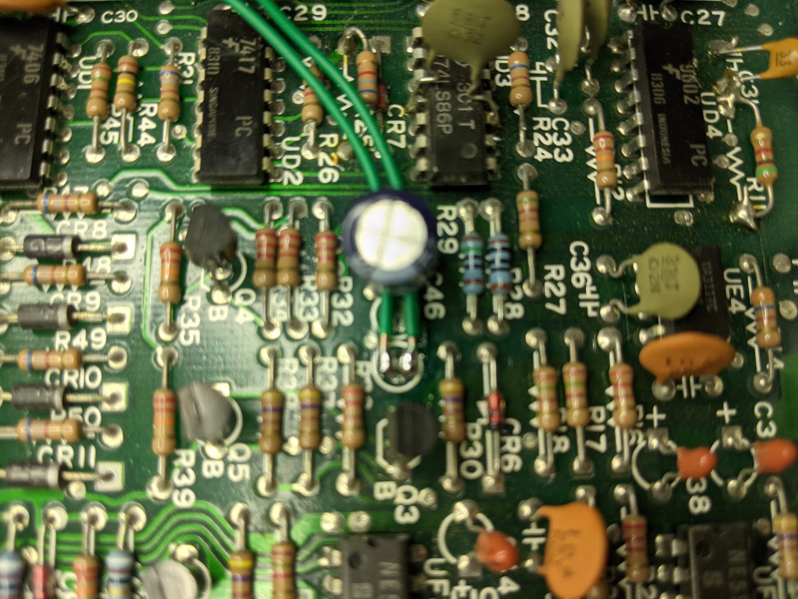

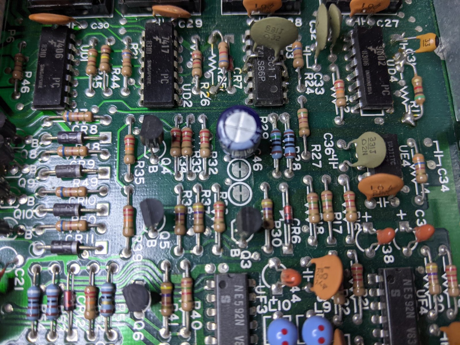

I own a 1541 Ultimate II+, so in order that I can use my real 1541 at the same time it's nice to be able to switch the device ID. On a 64 a 1541 can have an ID of 8,9,10, or 11. Unfortunately this is not a factory switchable option but requires some modification to the drive.
The ID can be set in a few ways, one of which includes lifting legs on IC's - I didn't really want to do that so opted to permanently wire in a toggle switch. There are 2 jumpers on the drive board that combined in binary set the ID (inverse binary). They are both closed from factory, and the one closest to the drive front (on my short board drive) needs cutting to make an ID of 9, factory ID is 8.
The pads are in the centre of this photo
Next I soldered some solid core wire (probably would've been better with braided core) to the pads and ran these to a SPST ON/OFF toggle switch I'd panel mounted to the rear of the 1541 upper case.
Blurry pic follows...
The switch and a hastily printed label - I've also drilled out a hole to panel mount a dolphin dos enable/disable switch
