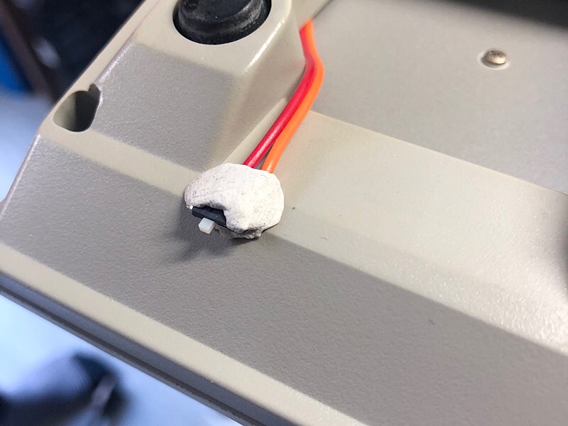

Changed the caps, still the same. I will try to check if there are serial debug messages coming out of the attiny85 later on.
I can always go for a physical switch anyway, the only issue is that French STEs don’t have a modulator so I can’t repurpose the RF hole in the case for a physical switch like I did with my UK STE. And I hate to modify original cases.

I have seen people fitting small sliding switch upside down in the cartridge port slot.
EDIT: I couldn't find exactly what I was searching for but here's an example at least.

Thanks a lot, it reminded me of theses tiny switches I ordered from AliExpress a few years ago and never used. I didn’t go for the cartridge port to avoid very long wires, but instead got it out at the joystick/mouse port.DoG wrote: 14 May 2021 10:43 I have seen people fitting small sliding switch upside down in the cartridge port slot.
Stole some Blu-tack from my kids until I find a more permanent way to fix it. The switch is so small that it fits perfectly below the front edge of the STE.
