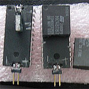

When your Atari Falcon starts developing amnesia by forgetting it's time, native language, keyboard layout, screen resolution, or other bios settings then your NVRAM battery is dead and needs replacing. Chances are you've heard the rumors that there isn't enough room under the Falcon's metal RF shield to install the Dallas 12887 / 12887A replacement chip with an IC socket. As a result, many Falcon owners have concocted all kinds of contraptions and altercations to bring the original NVRAM battery back to life. These hack jobs are documented all over the internet (see examples below).
When I faced changing all three of my Falcon's NVRAM chips, I desperately wanted to use IC sockets to make future replacements quick and easy. One of the solutions was to cut a holes in the RF shields to make room for the new chips and sockets. I refused to do do this. However, if I didn't use IC sockets, I would have to desolder and resolder new chips every 5 to 10 years. I resented this alternative too as it involved too much heat stress and risk to the electronic traces. Taping batteries and soldering jumper cables to boost the dead chip was also out of the question.
Granted, there are two schools of thought on this subject. The first is that some folks don't care about what the end result looks like; all that matters to them is that it works. Others believe that the original state and aesthetics of the computer should not be altered as it depreciates its value. It is my belief that in 2010, these rare computers should be treated like vintage sports cars - you wouldn't hack the insides of your 1991 Lamborghini to fit a Volkswagen battery, would you? After searching the internet endlessly, I finally found a simple solution. Now there's no excuse for butchering your old clock chip anymore! Luckily, as long as you haven't destroyed your RF shielding, whatever workaround you've done previously, the process is reversible!
Here are some previous "horrific" workarounds found across the Internet that are no longer necessary.
