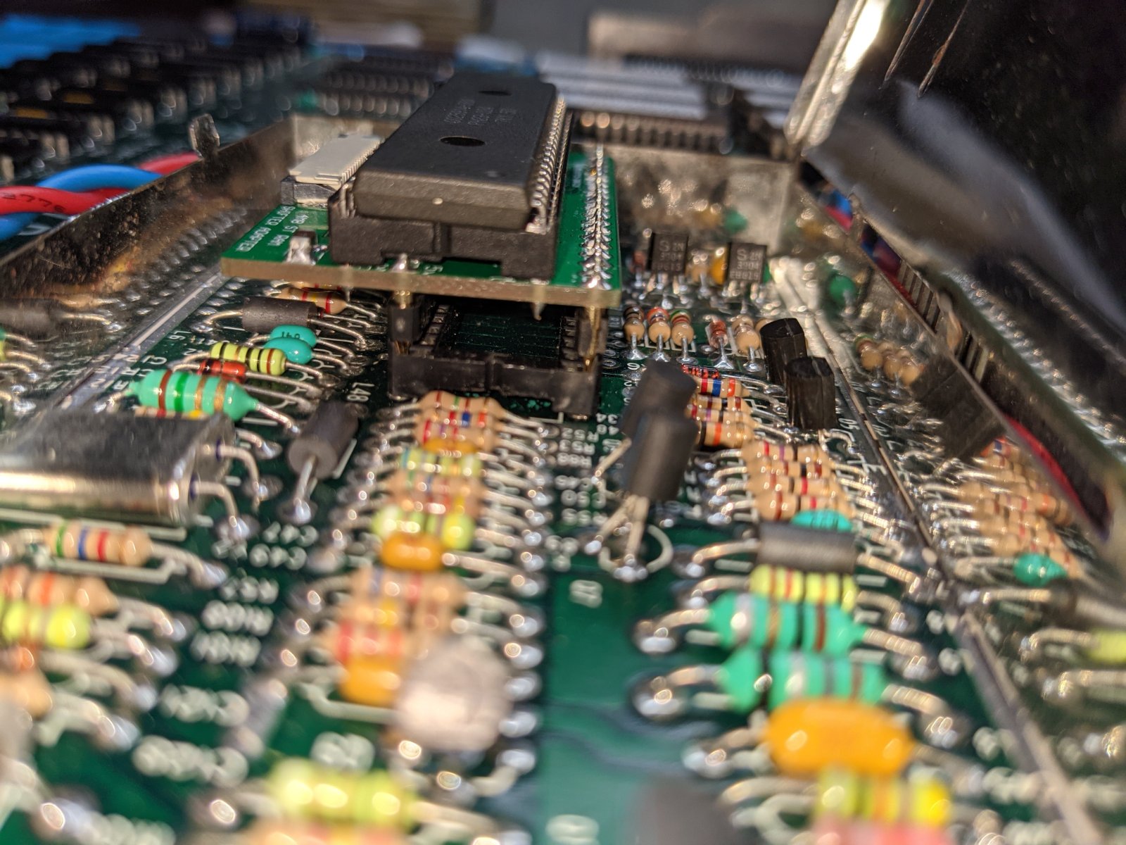

I have attempted this 4MB RAM upgrade, but when I turn the unit on, I am not getting a boot up sequence. The system produces a black screen through the video port. The gotek is getting power and the power light is lit. Listening to the device, I don't hear the normal "bzz" noises that periodically play, when the system is booting up. I assume the RAM is not working, now that I used this upgrade. Can anyone please help me diagnose the problem? I have attached some pictures. Any suggestions on what to try would be greatly appreciated.

It also looks like the RAM board is not correctly inserted into the socket fully...

It doesn't look like the mmu adapter and the shifter is fully inserted. Could be the angle of the photo maybe.

When you have a border with black screen it generally speaking means no memory.
The MMU adapter looks correctly aligned with pin 1 in the correct location, however it is not inserted nearly far enough. You should have only about 1mm of the pins visible when properly inserted.
I'd suggest that you completely remove the mainboard and place it on a piece of cardboard on a flat level surface before trying to push in the MMU adapter to ensure that you can use enough force, applied evenly, to ensure the adapter pushes in far enough.
Leaving it in the case allows the board to flex, which can also cause hidden damage, and prevents even insertion. I've had boards break just by pushing something into a socket.
As for the Shifter adapter, I don't think that is fully in either as it looks a bit high to me. It should be easier to insert than the MMU adapter but I still advise doing it with the board outside the case on a flat surface supported by cardboard.
Double check the Shifter orientation to make sure that pin 1 of the adapter and chip are in the right place.
After inserting the adapters, I'd suggest you check on the bottom of the board for any pins that may have bent over and are shorting. Atari often left component leads long enough for this to happen.

I tried my best to press down more like you recommended. I think I made some leeway, but the same result is occurring. I don't see any obvious damage on the bottom of the board. I did put some solder in one pin whole that didn't seem to have solder in it.
Maybe this is a dumb question but I don't have to mount the PSU with any screws or plug in the keyboard for the boot sequence to start normally, do I?
Please see attached photos.

No, It'll boot just fine with the PSU sitting in place on the mobo, no screws, and the keyboard isn't necessary for boot.kmcrainey wrote: Wed May 05, 2021 8:24 pm I tried my best to press down more like you recommended. I think I made some leeway, but the same result is occurring. I don't see any obvious damage on the bottom of the board. I did put some solder in one pin whole that didn't seem to have solder in it.
What hole (Via) are you referring to that had no solder? Really you shouldn't solder anything unless you know what it does, and the ST does have a lot of unsoldered vias.
BTW, the 4th pin up on the left of your shifter looks bent and the shifter adapter doesn't look evenly plugged in, it's higher on the right hand side in your pictures.
