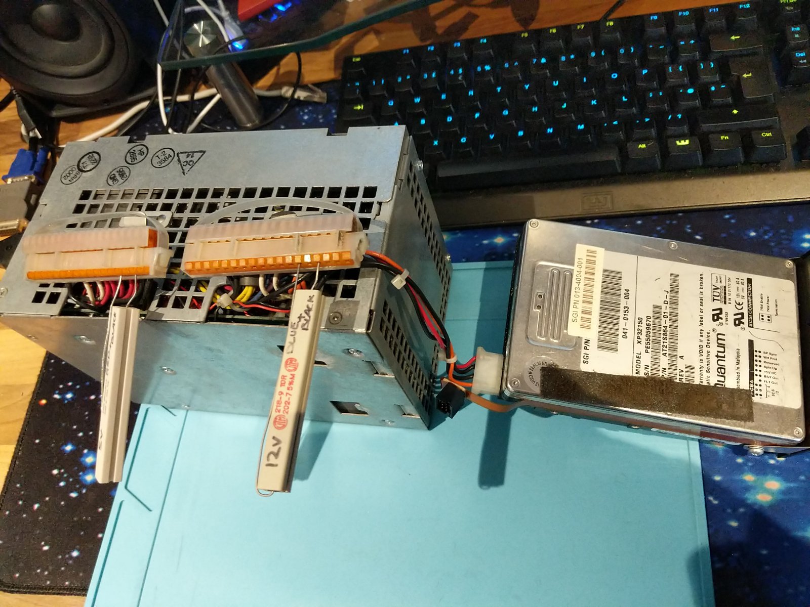

Hi guys n gals,
I'm currently testing an SGI Indigo2 PSU 'PEC4074'. I didn't want to just put it into a machine and hope it works so I've been bench testing it. This is a 'ground to stop' PSU which should just turn on when AC is supplied and there is some loading on the rails.
  • It doesn't turn on when turning AC on
  • Tried using my load resistors & also a HDD on the molex
  • measured pin 5 (5v standby) which should always supply 5v even when off, it was only 0.15v.
  • when turning the AC off, the 5vSB voltage slowly discharges to 0 while making an audible spiralling deceleration high pitch noise.
I'm not a PSU expert and my method of fixing PSUs is usually a shotgun approach. I'm hoping there may be someone in this forum who is good with PSUs and may look at it for me. Happy to pay for time or with my own labour if you need jobs done.
Valuable info on this PSU, non impact model:
https://forums.sgi.sh/index.php?threads ... asics.111/
Here are some photos:

Posts: 3405
Re: Need help with an SGI PSU
It's supposed to auto-start as it is a 'ground to stop' and the SB is supposed to be 5v during idle... you think I can just ignore all that and try?

Posts: 3405
It's ok @DoG I tried that just a moment ago, but it didn't make any difference :(
