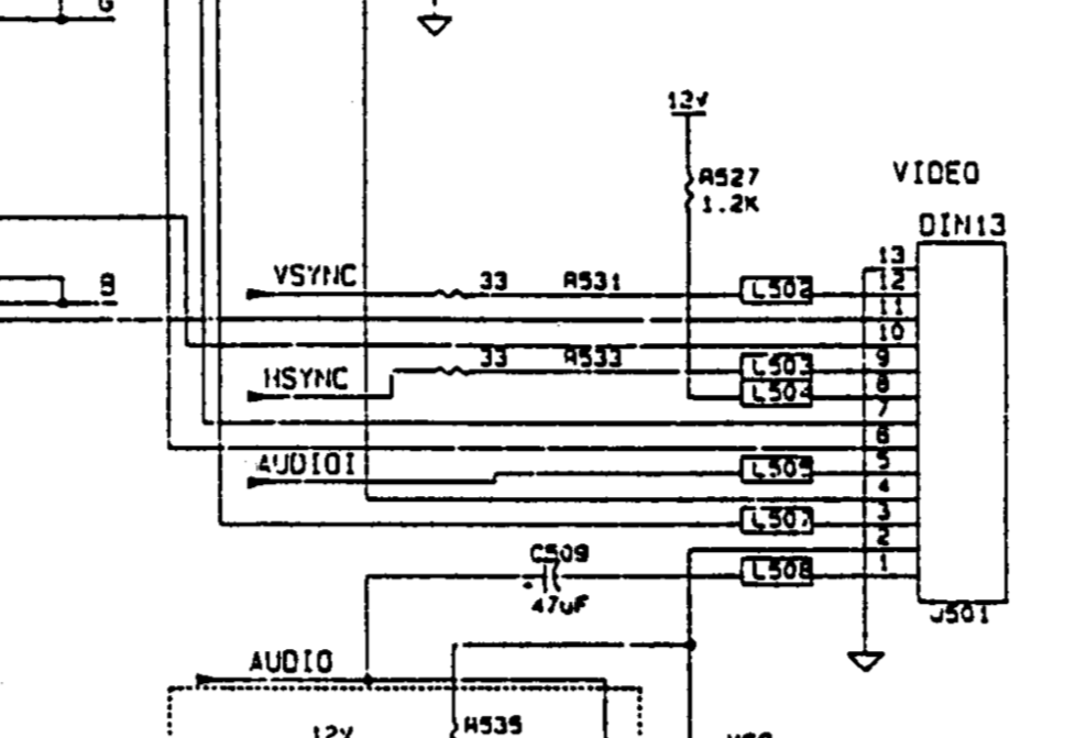

There are 33 Ohm resistors on the Vsync and Hsync lines check the schematics. The resistors can be faulty ...
Re: Black screen (but sync?) on Mega STe
Found them!
R531 and R533 both measure around 33K and go through inductors L502 and L503. I checked these since too I've had bad experiences (and frustrated troubleshooting in the past) when one of these had shorted to GND. But these appear OK.
Presumably you mean 33 Ω here?Pacman wrote: Tue Apr 27, 2021 11:01 am R531 and R533 both measure around 33K and go through inductors L502 and L503.
Oops!
Yes, absolutely. I rechecked and they're indeed both 33 Ohms.
