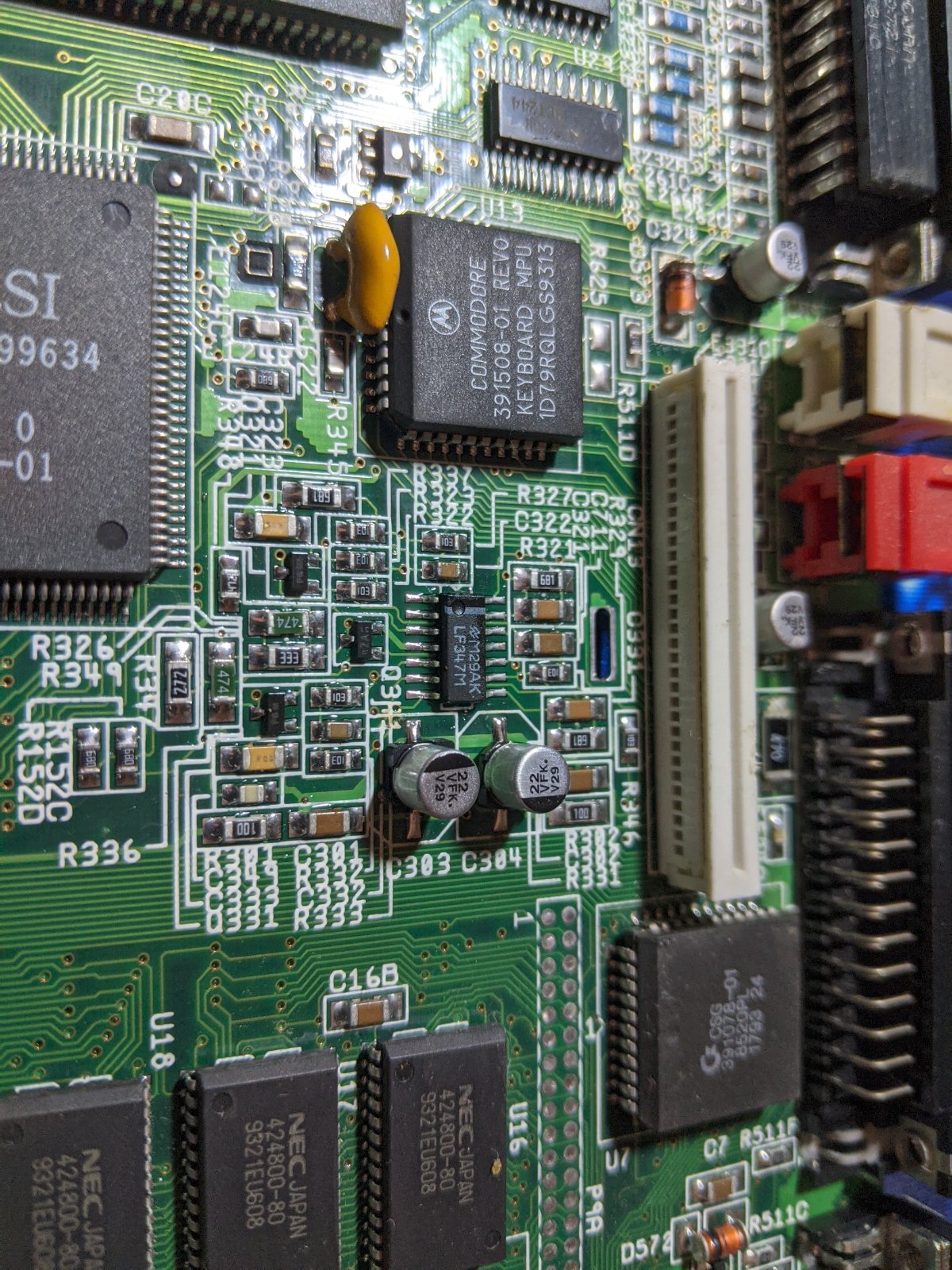

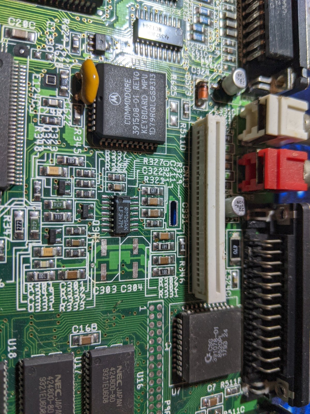

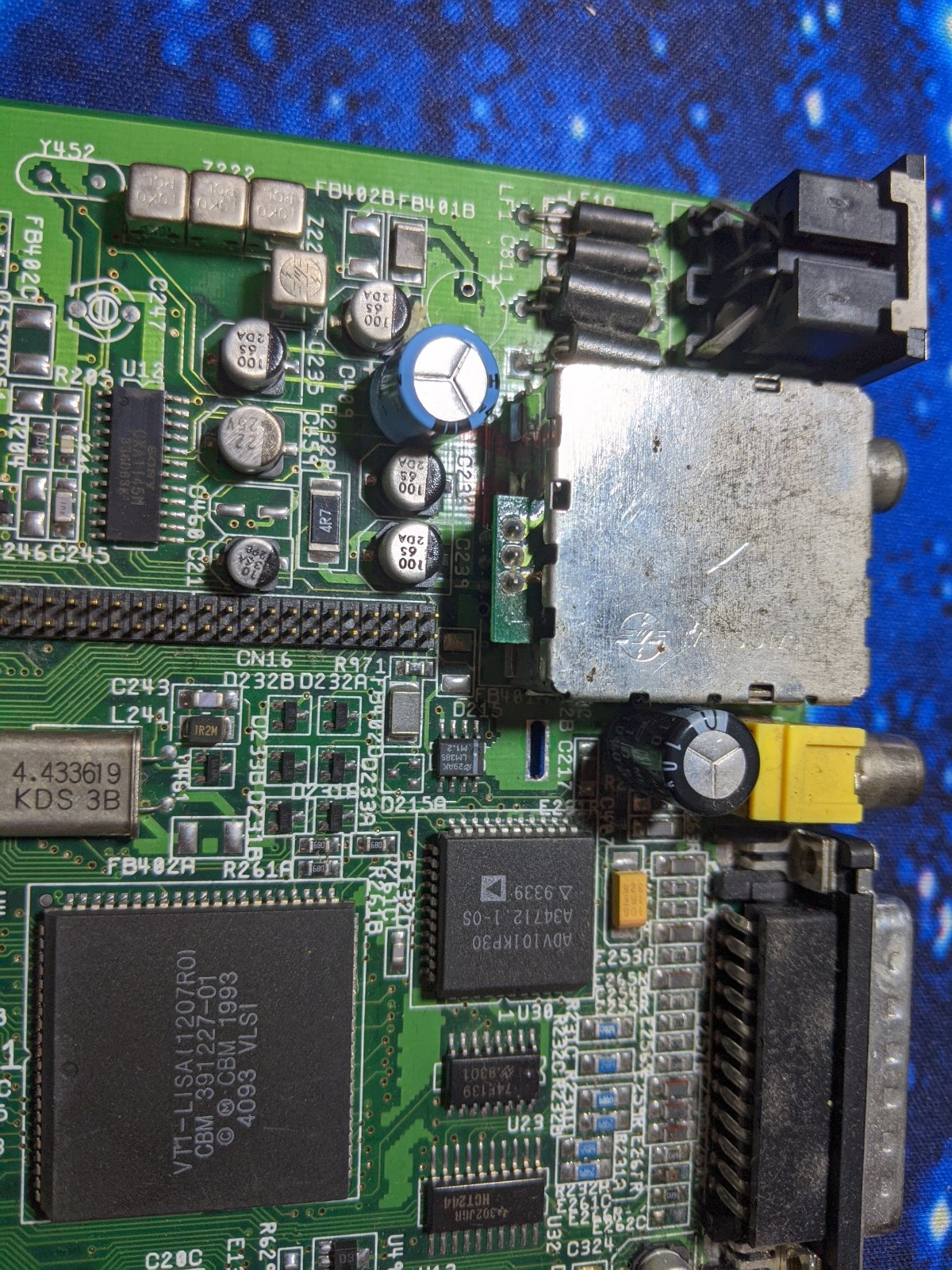

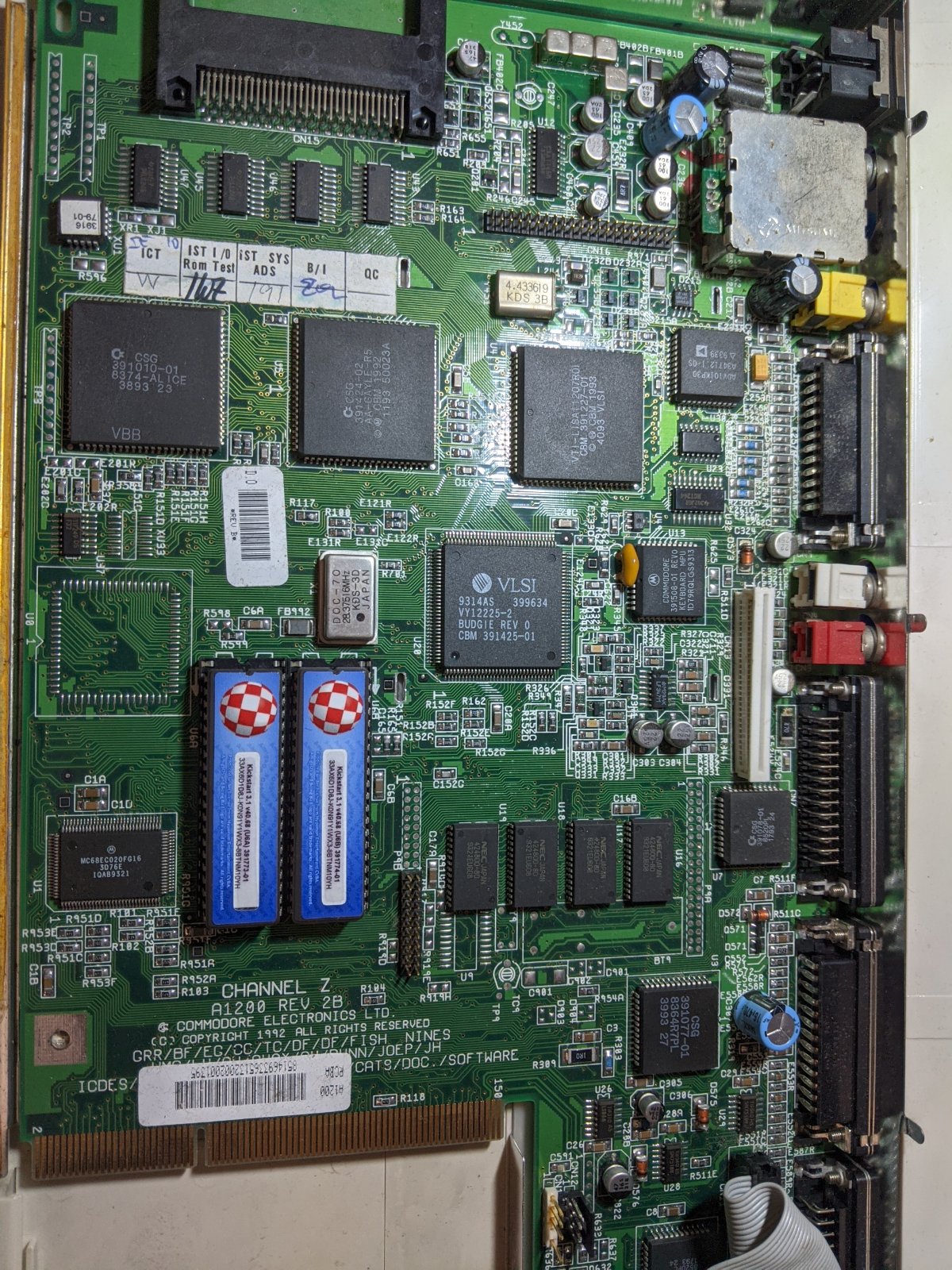

Here is an Amiga 1200 that was sent to me for a re-cap due to instability issues when using the ACA1233n accelerator. In this blog we re-cap the motherboard, remove two ceramic capacitors on the rear and perform a general tidy up.
Photos before service:

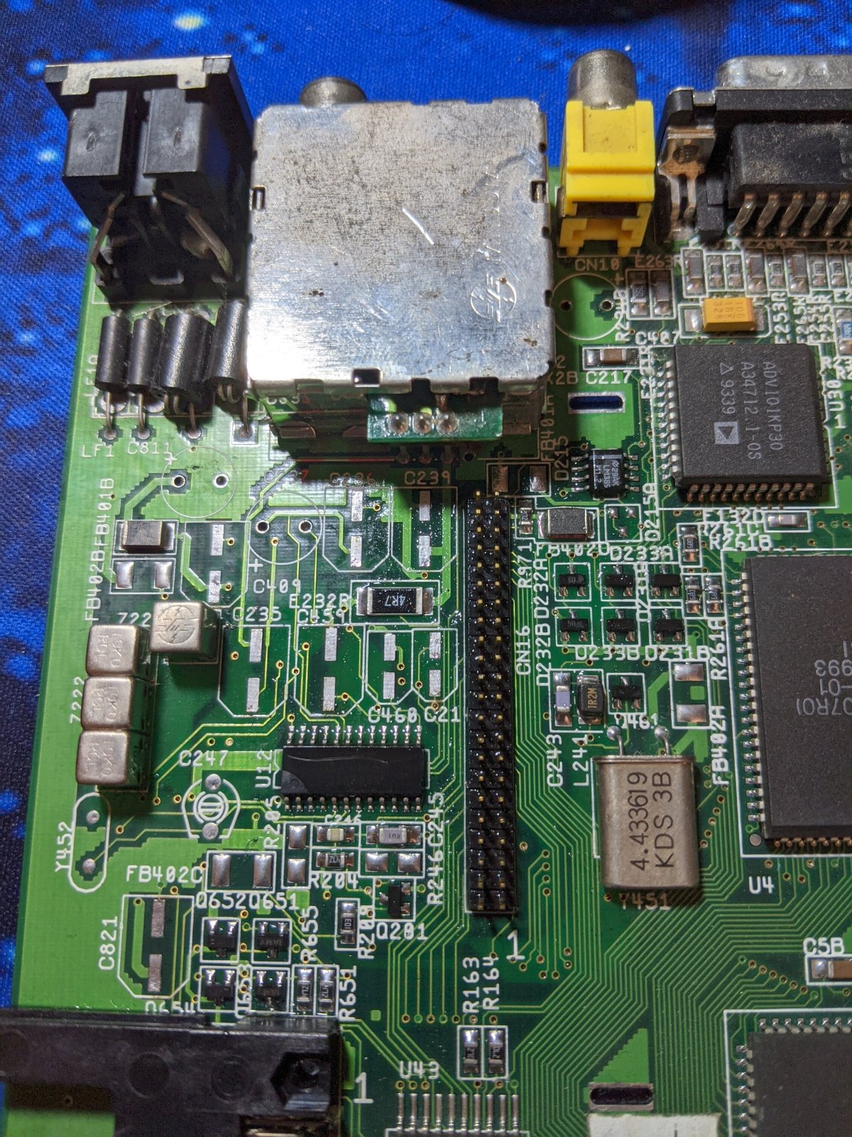

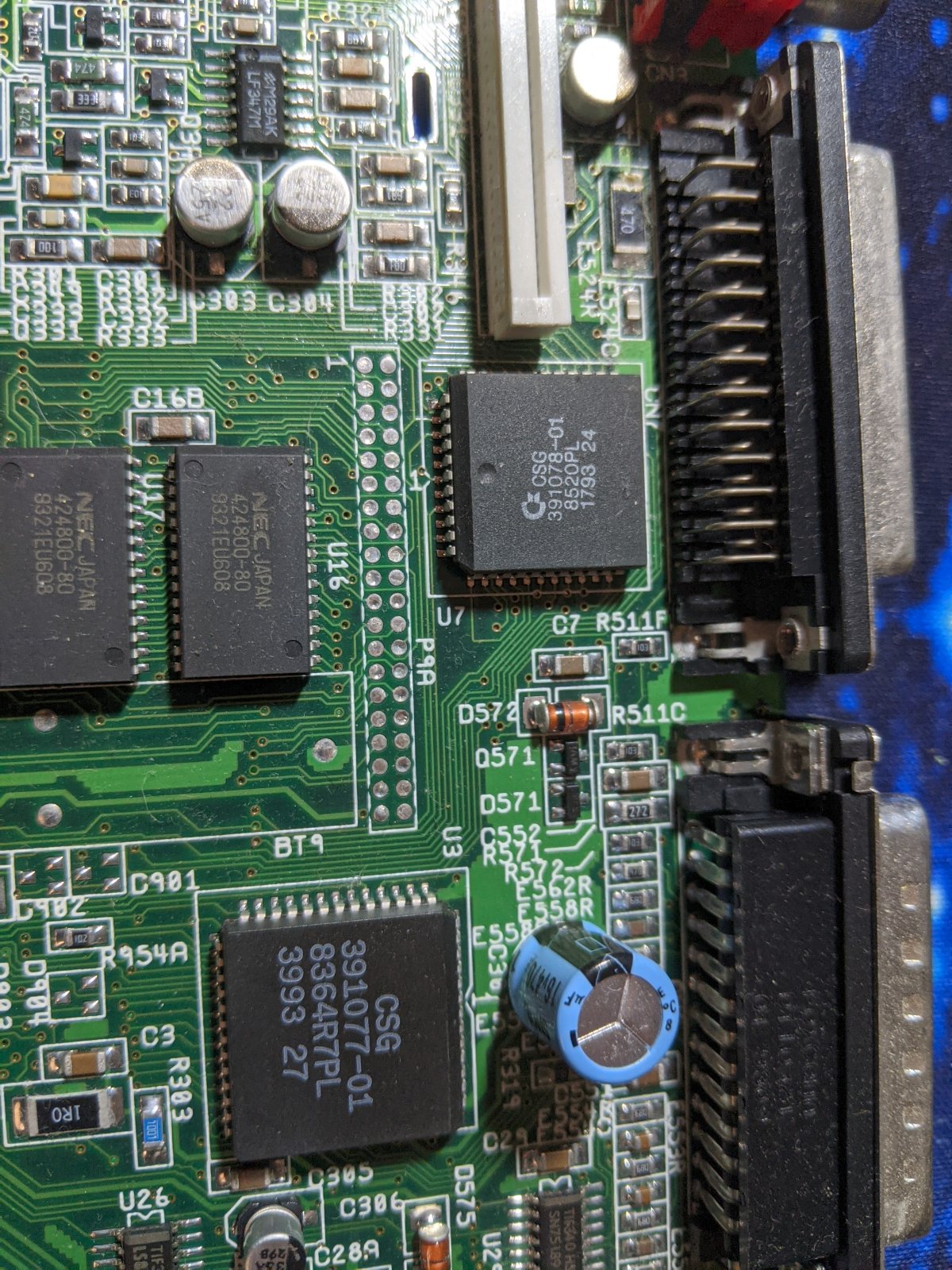

Capacitors on top of board replacement, many had leaked and emitted a very strong fishy smell:

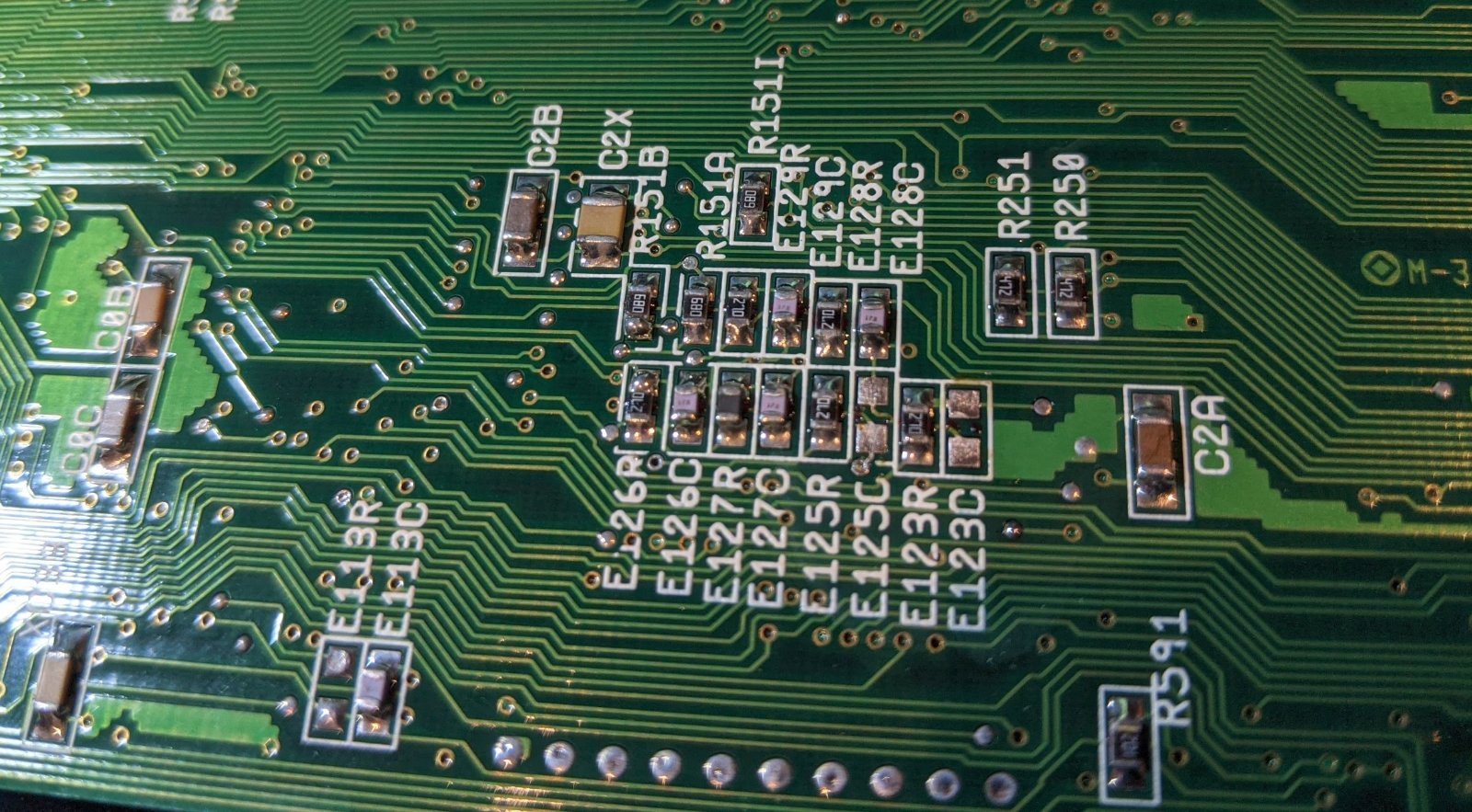

Rear capacitors needed to be removed as per aca1233n wiki, link: http://wiki.icomp.de/wiki/ACA1233n#poss ... ifications

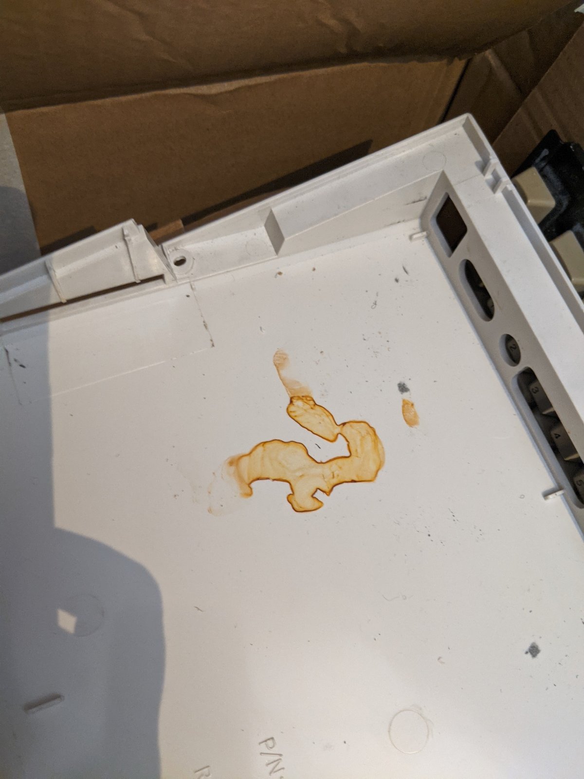

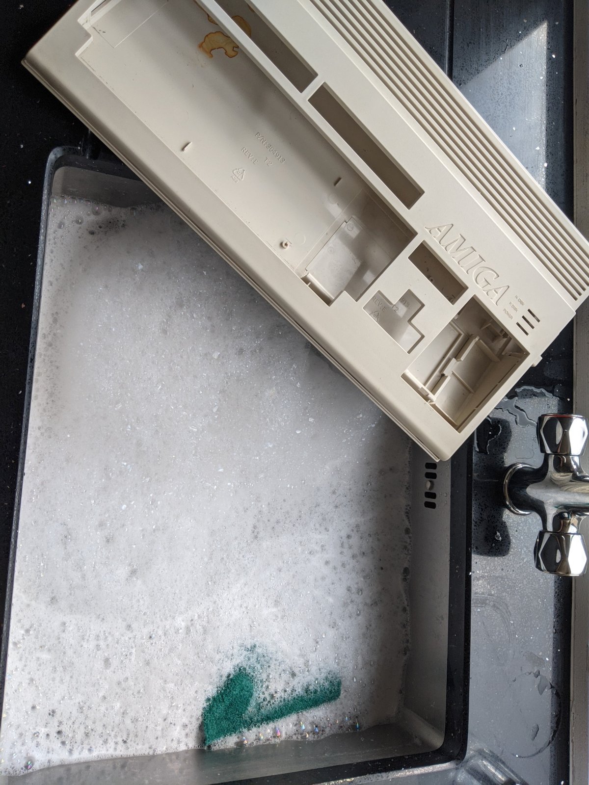

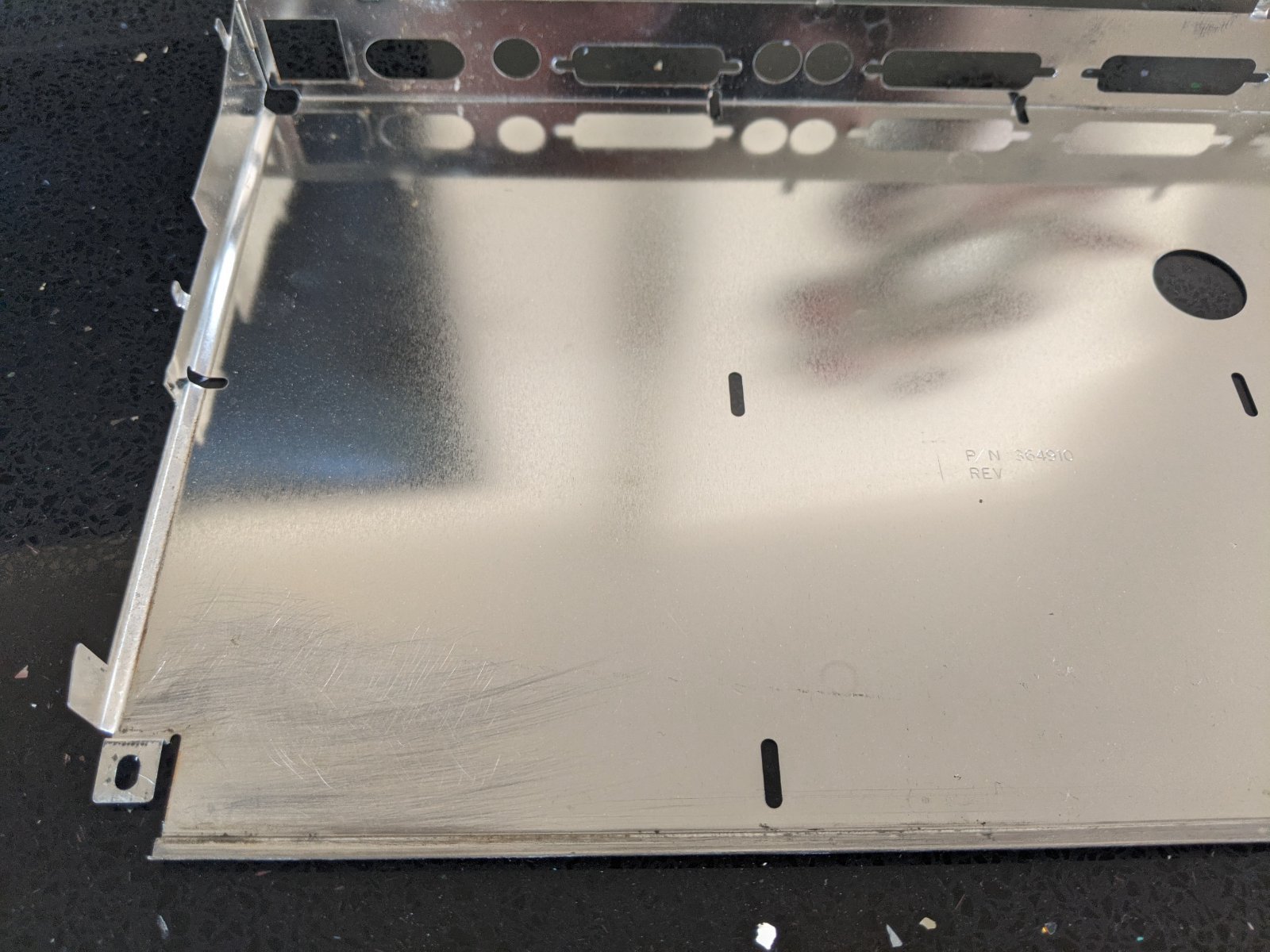

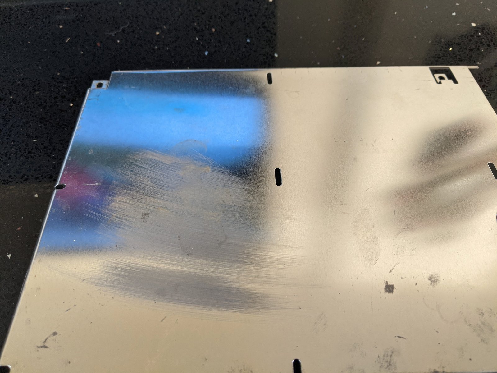

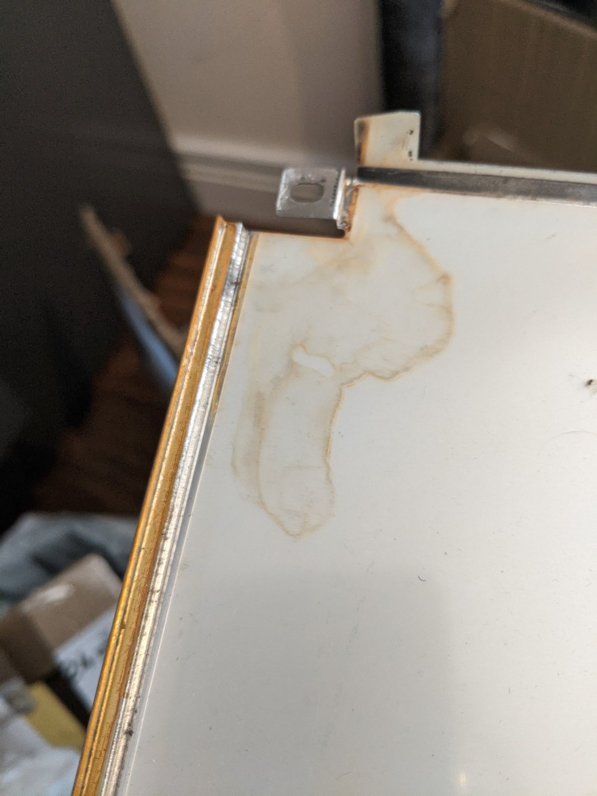

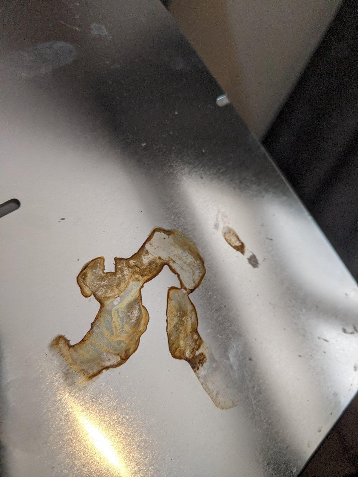

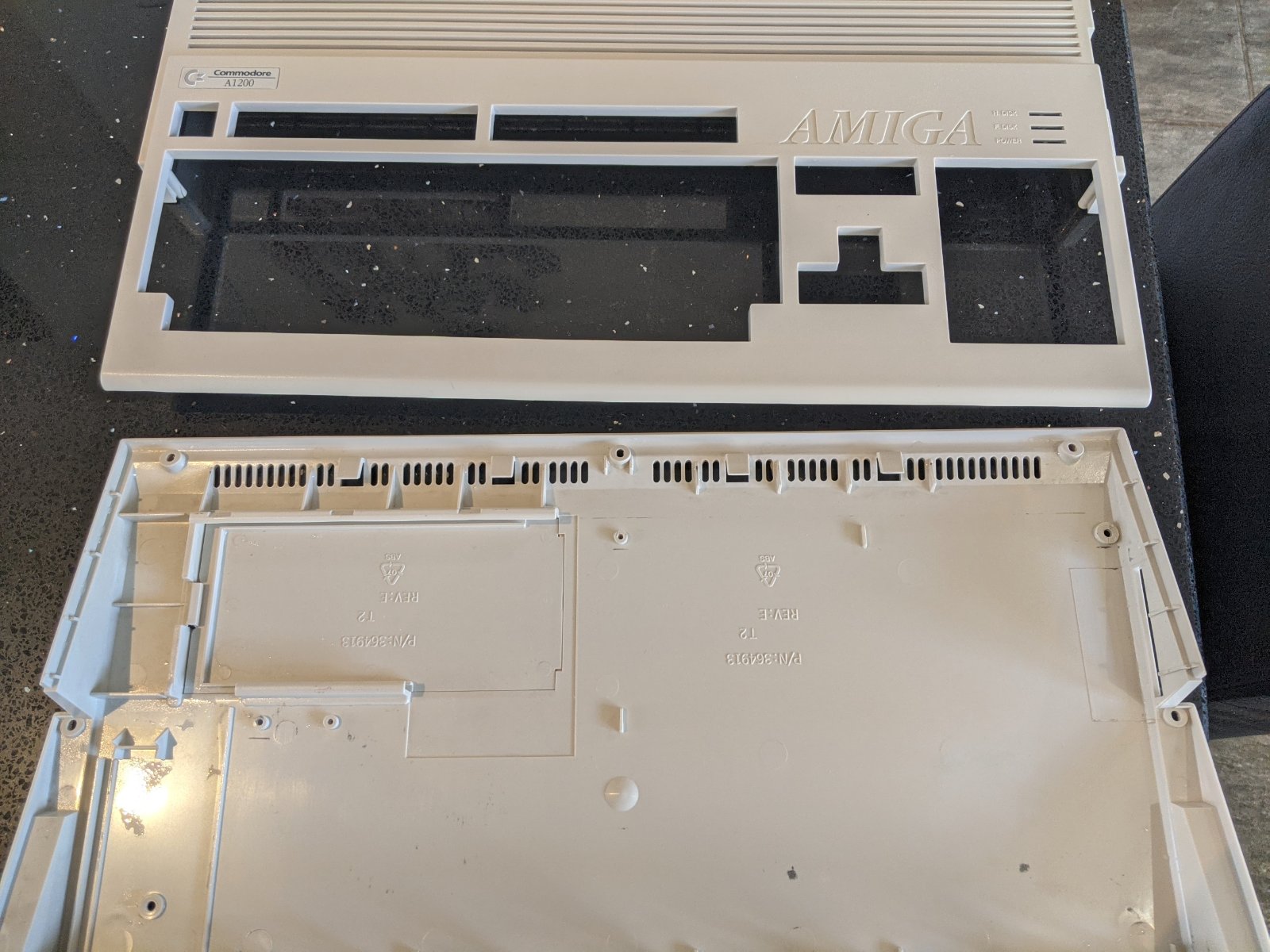

Rust on case and shielding removed with sand paper, case cleaning in the sink:

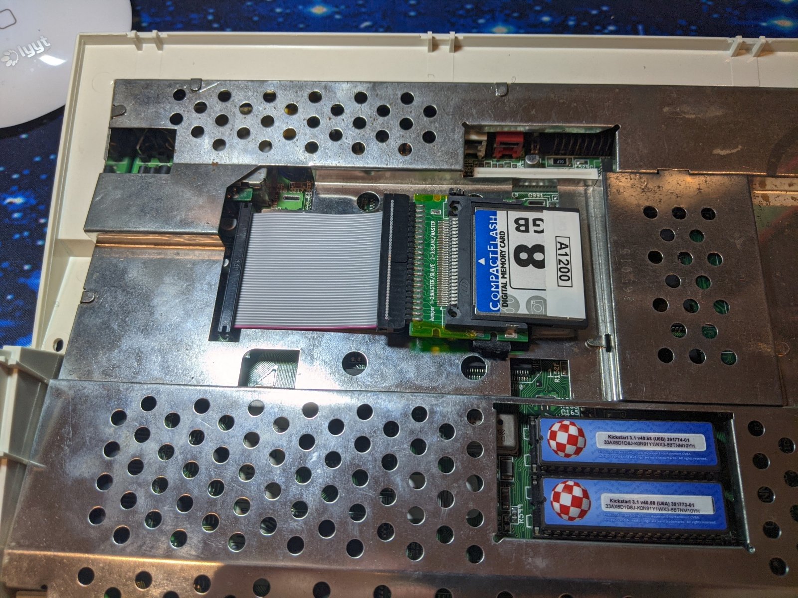

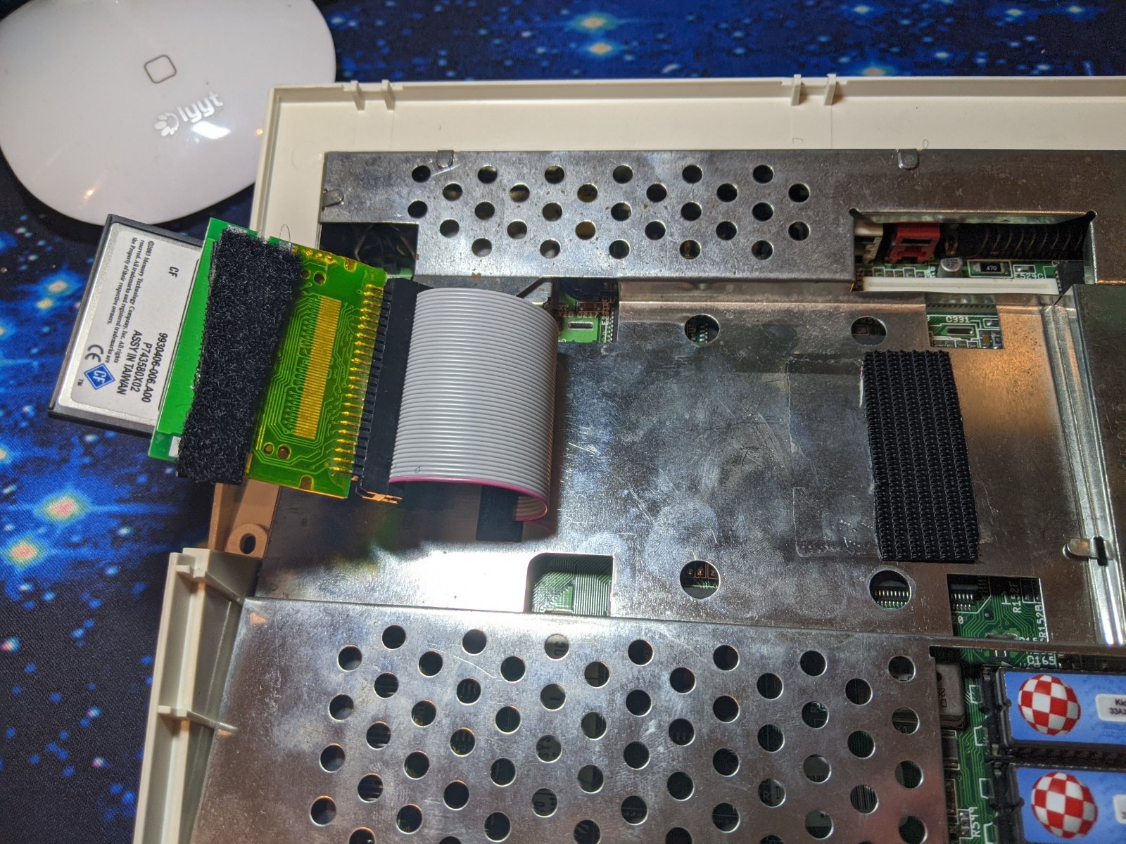

Put back together and finishing touches, HDD cable was very long so removed and replaced with new smaller cable, rear of cf adaptor covered with kapton tape and secured with velcro:

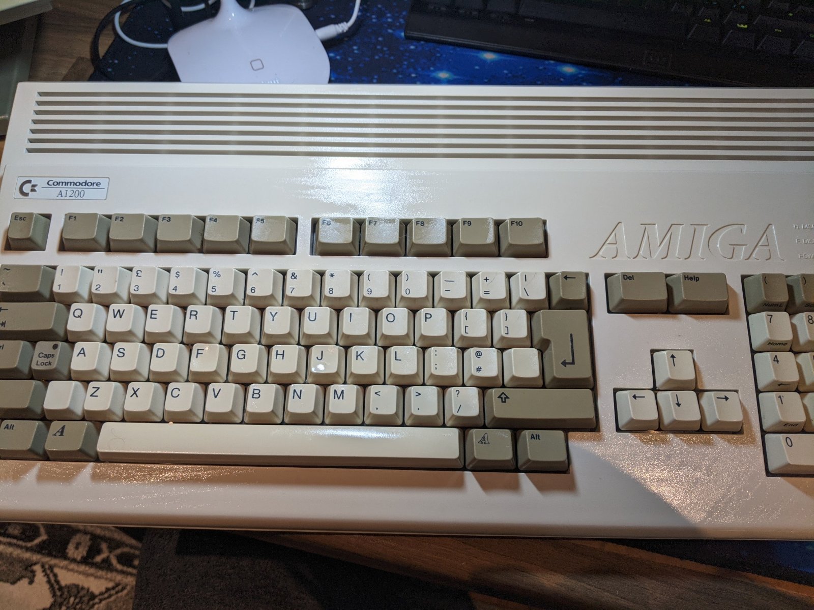

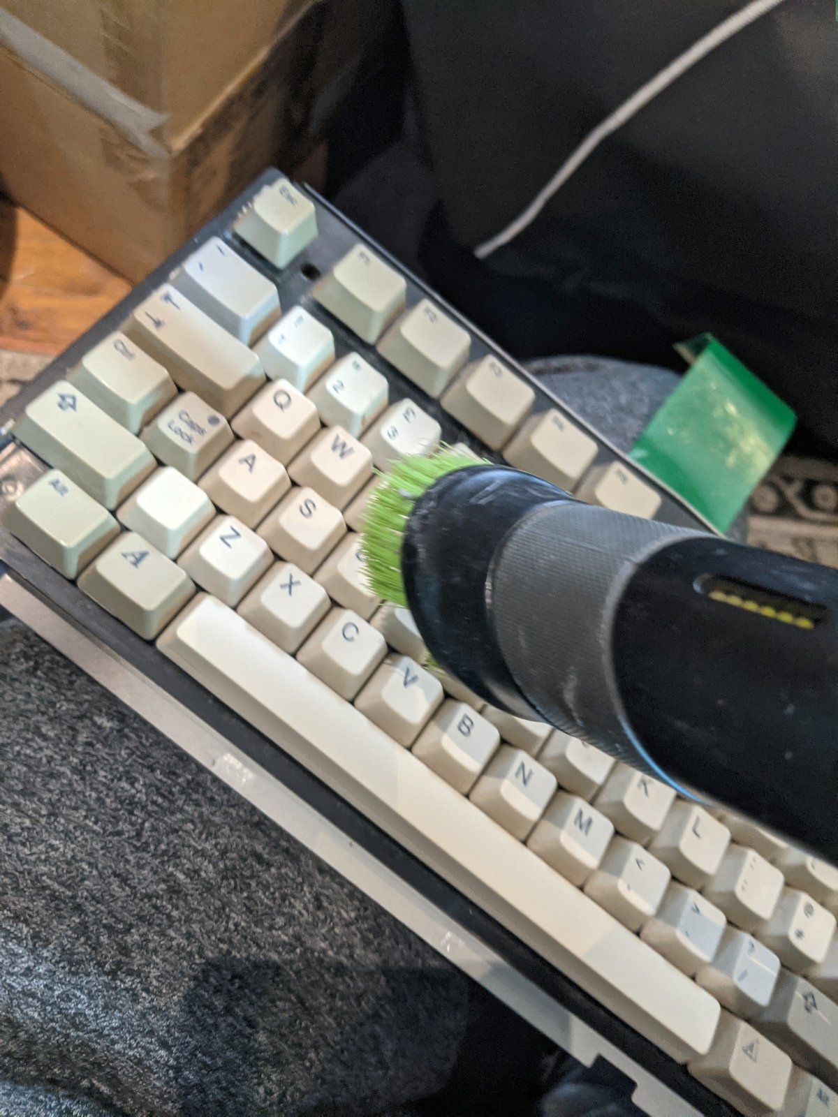

Keyboard cleaned and everything wrapped up:

Did you replace the two capacitors near the audio jacks?
And did you remove the keyboard connector to do so?
Thanks!
Thanks for sharing
Thanks!
Re: Amiga 1200 service blog (accel stability)
Yes they were replaced too, I didn't need to remove the keyboard connector as I have a very fine soldering tip which fits between ok. Got to be very careful with a1200 mobos as the pads are very delicate.

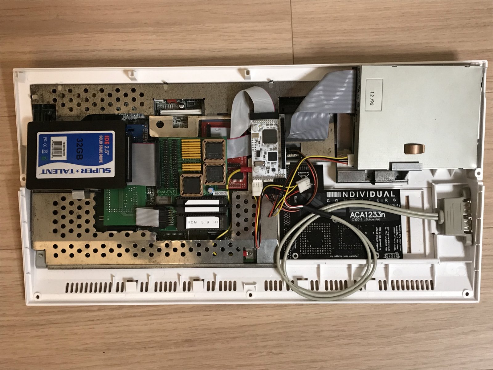

Never thought I will post an Amiga related topic on Exxos forum, but just the once will not hurt...
Here is a picture of my own Amiga 1200 (NTSC):
The following have been done to enhance the beast:
- Full polymer recap
- Timing fixes
- Indivision AGA MK3
- 4-way Clockport Expander
- Elbox FastATA A1200 MK-V
- RapidRoad (double USB)
- ACA1233n@55Mhz and 55Mhz FPU
- 32GB SSD
- 3.9 Kickstart ROMS
- Chinon FZ-357A
- New A1200.NET case
Everything is rock solid and runs perfectly under Amiga OS 3.9.
I am still waiting for the new A1200.NET keycaps to arrive and to get a 68060 based accelerator board, such as Terriblefire's TF1260 (my MC68060 would be grateful).
Cheers.
