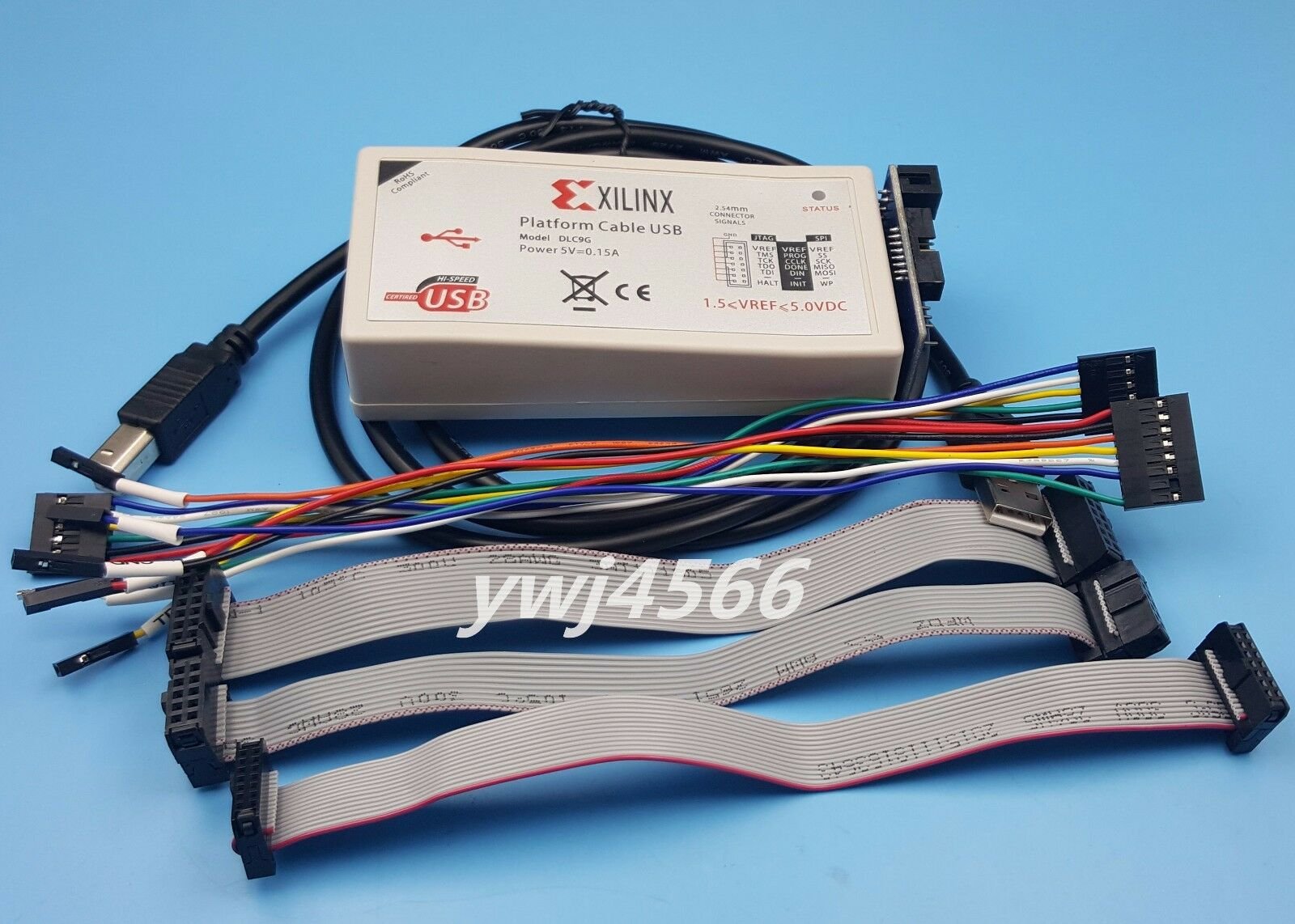

This is what I bought about a year ago.. I think I should be able to program the firmware with this correct?
I have not taken it out of the package as of yet.

Yes, that will work both with the Linux software and the Xilinx stuff.
It's far safer than trying to use the Raspberry Pi GPIO pins.

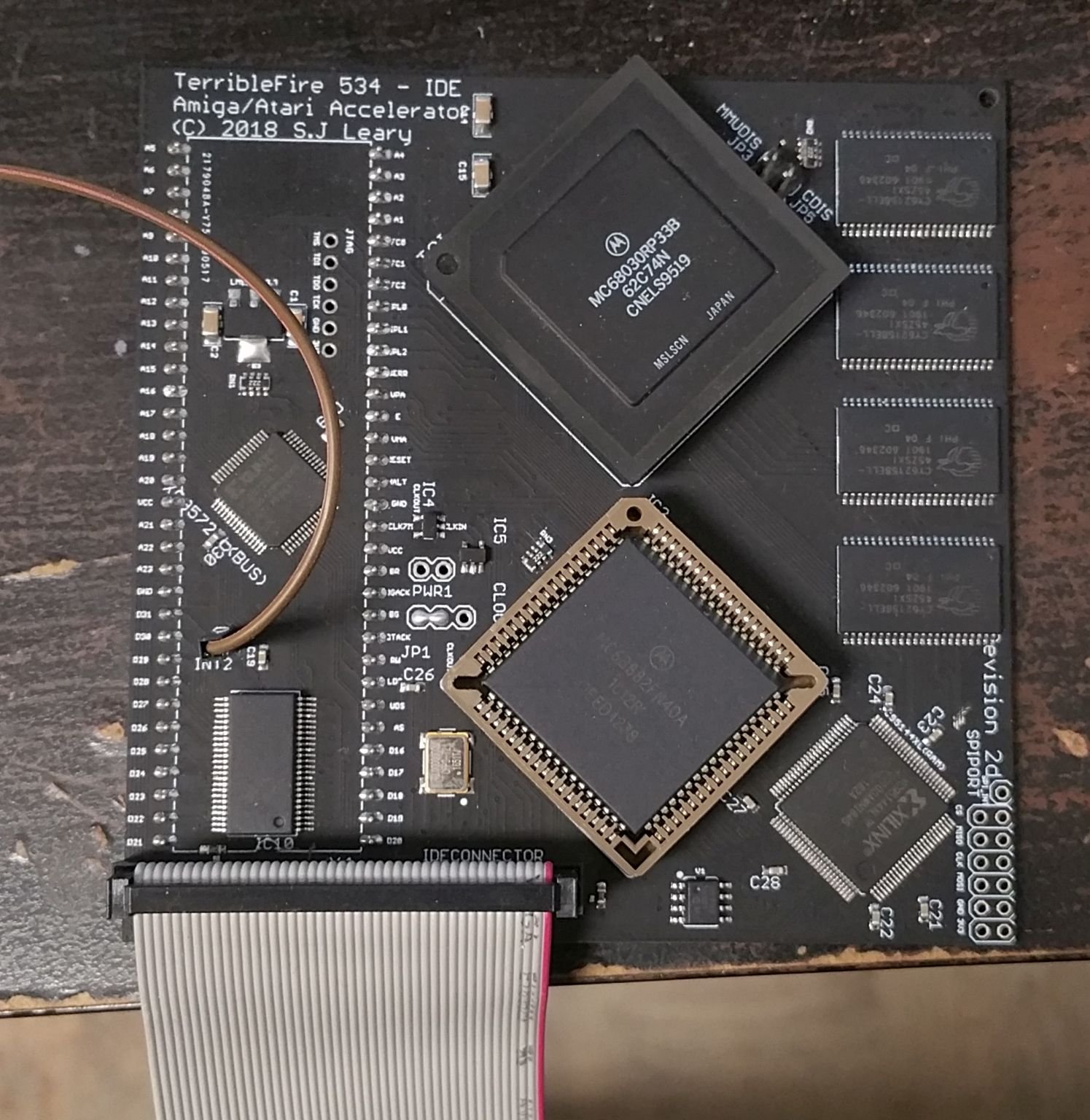

OK, so this is my TF534. I am getting a TF536 from Alenppc. I showed him this pic, he says this is not one of his. Does anyone recognize this board?
It runs fine in an A2000 - My thought is that the 534 IF STABLE in the Atari would be good because 4mb TT ram is enough for full enhanced performace. The 536 in the A500 rev6 for WHD gaming because some stuff can run over 4mb (no idea if its the stuff I would use).
Any thoughts?
