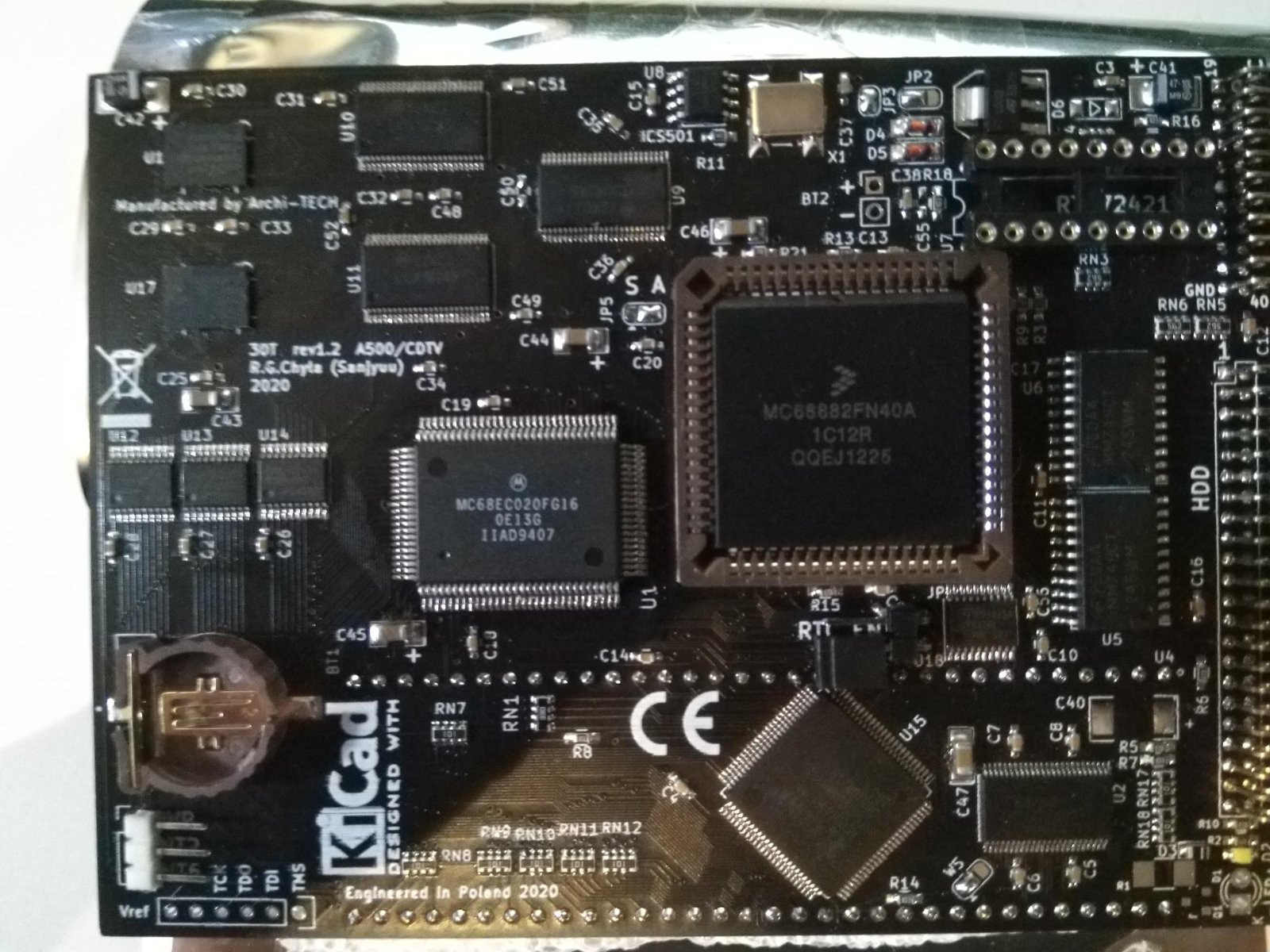

68020 28mhz, FPU, 9,5mb ram, IDE, RTC and clock port.
Supports CD-drive just fine.
It was designed and produced in poland.
30T accelerator for a CDTV

That's interesting.. Did You got one?
Can You tell us more?

Yeah if you can keep the ram in the ZII area you will have no issues. 9.5mb of ram... I guess I have got too used to 128mb now
EDIT: didn’t mean that to sound negative. This board looks good

I guess this card is on its limit with 8MB Fast and 1.5MB Slow RAM because of the EC CPU Type, it can't address more than 16MB in total...
This is ok though since CDTV doesn't have any Zorro slot..

Re: 30T accelerator for a CDTV
There is no "seller web page", these are available through Polish web site allegro time to time. I got hinted, registered there and bought one.
Ram is 8mb + 1,5mb slow fast area.
It comes with tool wich syncs card's rtc to CDTV's rtc, have kickstart to fast ram, disable fast ram options etc.
With that shape / size it fits perfectly inside of CDTV, without any tinkering.
Requires extended roms v 2.30 to work with CD-drive.
I'm going to use it with 7-bit clock port to SPI apdapter for a networking.
