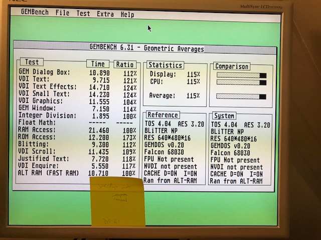

I had a go comparing the both on the Falcon @48MHz (speed relative to same configuration with hardware ROM).
As I expected, the results are pretty much the same.
MAPROM:
ROMSPEED:
So does that imply MAPROM doesn't like the TT? (I have looked at the sources before, but it's all Greek to me :D )
