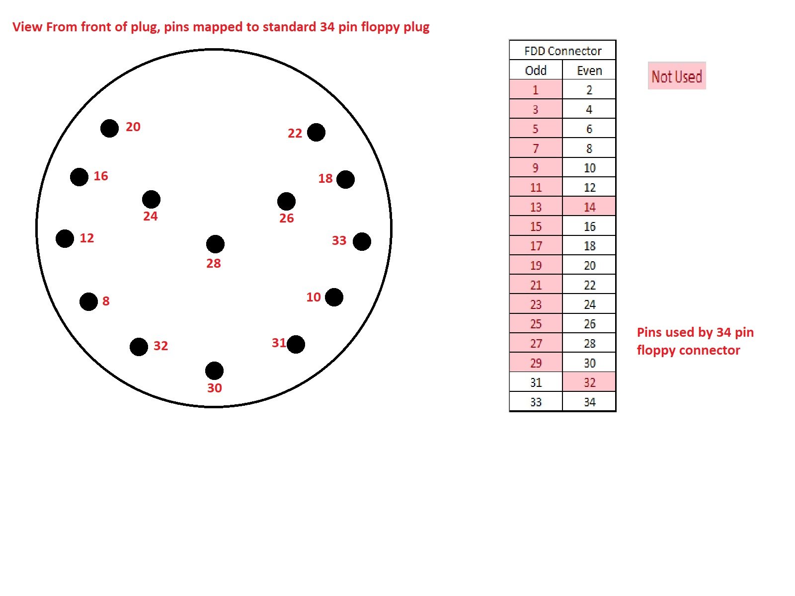

I used an existing external enclosure to get the pin mappings I needed looking at the front of the plug, as I couldn't disassemble it:
External Cable.jpg (98.91 KiB) Viewed 2610 times
And then reversed it:
External Cable_2.jpg (99.95 KiB) Viewed 2610 times
As I would be working from the back of the plug.

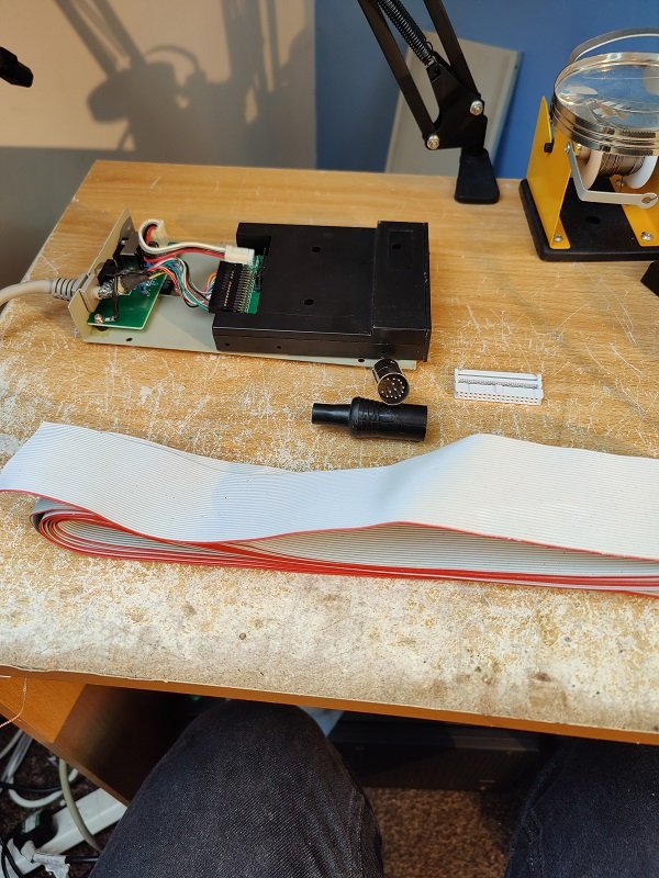

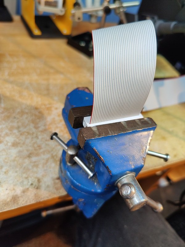

I then clamped a new 34 Pin IDC connector on to allow me to buzz out the wires to the plug as per my diagrams:
Once I had the 14 wires I needed I trimmed the rest off and began to get my assembly going:
The end result being:
Hopefully the pinouts and will help somebody wanting to do the same as me.
Make sure you buzz everything out before assembling to make sure all the connections are good, I had one bad solder joint and a pair of wires transposed.
Happily it's all connected up to my MSTE and CosmosEx and working a treat :)
