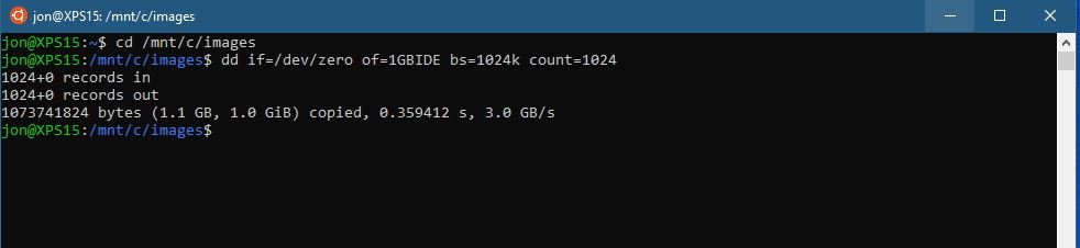

1. On the C:\ drive of your windows machine, create a directory called "images".
2. Start your WSL command prompt.
3. In your WSL command prompt, change directory using the following command: cd /mnt/c/images. This will take us to the c:\images directory created in step 1.
4. Execute the command: dd if=/dev/zero of=1GBIDE bs=1024k count=1024. This will create a 1GB IDE image file called 1GBIDE.
The following shows all the above as I ran the commands.
Of course, if you happen to be using Linux, then you can skip the WSL steps above and do straight to step 4 in a directory of your choosing.
