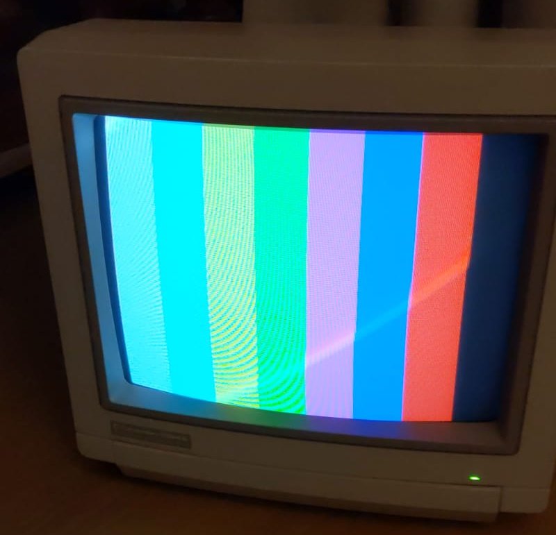

I've built an ATtiny2313 based RGB pattern generator by following this guide: https://dselec.wordpress.com/generator.
The generator is designed to produce test patterns like these:
I'm intending to use it to be able to more accurately adjust my CRT monitors. The service manual has some internal calibration instructions that make use of a pattern generator so I figured this would help me.
Here's a picture of the finished build (I couldn't find a 90 degree connector however so I used a straight one).
Sadly, it doesn't work for my Commodore 1084S-P1 monitor, the picture keeps running vertically and also the horizontal sync is off. I've tried another of my monitors, with similar results. Please note that while the pictures all seem to have a blue shade, in reality I'm seeing different colors (it's my smartphone's camera that messing up).
Here's another one, I selected pattern 11 I think but I have no idea how each pattern is supposed to look exactly. The example pictures from the site don't mention the corresponding pattern numbers.
The project is like 10 years old and the author hasn't responded to the article's replies so I needed to look elsewhere for a solution.
So I hooked up my scope and measured the horizontal sync and I got 14,881.9 Hz. As the monitor's service manual indicates, the horizontal frequency should be "15,625 Hz (+600 Hz)". Does that mean that the tolerance is 600 Hz but only above and not below the 15,625? Or perhaps -300Hz and +300 Hz?
Anyway, 14.881.9 Hz is obviously too low, even when taking an optimistic 15.625 Hz - 600 Hz = 15.025 Hz as the lower limit.
As some of the replies suggested, the crystal oscillator should be 21 Mhz instead of the 20MHz as listed in schematics. When calculating the resulting frequency, we get (20,000,000 / 14881.9) * 15625 = ~20,998,662.81 so that's very close to the mentioned 21 MHz.
The problem is however, that I haven't been able to find any 21 Mhz crystals online. But I managed to get my hands on a few 21.3 Mhz crystals. I figured those would work as well because a 21.3 Mhz crystal results in a 15,851 Hz horizontal frequency. That should be well within the specified tolerance (a conservative 15,625 + 300 = 15,925).
So I replaced the 20.0 Mhz crystal with a 21.3 Mhz one. The scope confirms the horizontal frequency of 15,851 Hz:
Sadly, the problem didn't go away: the picture keeps running both vertically and horizontally.

I'm currently debugging my SCART<->RGB-cable because I think I might have a mistake in the wiring! I suspect that the csync signal is missing and that would explain the weird picture!
sandord
Posts: 764
Joined: Mon Aug 13, 2018 10:08 pm
Location: The Netherlands
Re: RGB pattern generator circuit
Post by sandord »
That was it! Silly me, always check your cables :headbang: :roll:
