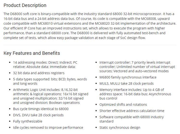

Anyone seen or know anything about this ...
I have contacted them to see what their licensing policy is....
While I am clocking 32 MHz, I was looking at moving towards 64Mhz with the 68SEC000 CPU, but I think there will be bottlenecks in terms of SRAM & ROM access speeds which will be tricky to get beyond 32MHz.. Even so, being able to run internal instructions at superspeed would still be a huge gain, assuming the core can actually run at 32 MHz or faster..
https://www.xilinx.com/products/intelle ... -2871.html
https://www.dcd.pl/workspace/documentat ... 000_ds.pdf

There is also the LGPL licensed TG68 open core. https://opencores.org/project,tg68

keli wrote: Mon Nov 20, 2017 7:32 pm There is also the LGPL licensed TG68 open core. https://opencores.org/project,tg68
I have seen that one, but it does not seem to have been updated in rather a long time ? I do not know if it is actually complete or not either..
