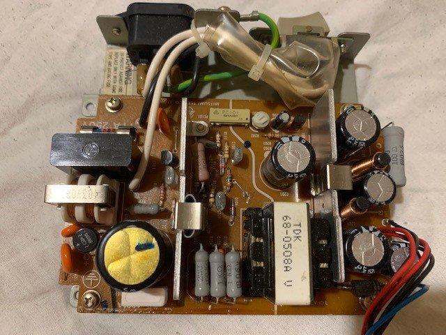

I've heard about people recapping the PSU's to fix certain problems but I have no idea if that applies here. I opened it up to see if anything stood out but I couldn't see signs of dry joints or anything like that. It looks like there may have sat on top of a minor spill at some point in it's life, which you can see from the small brown marks (these rub off with my finger) unless this is just old flux perhaps:
Old dry flux on the surface?
No real signs of liquid damage anywhere here.

Recap PSU.. Resolder rgb port.. Clean it with contact cleaner...

I had the same symptoms with a ST-to-SCART cable: buzzing audio and bad image quality and it turned out just to be bad contacts. Thus, using a contact cleaner on the video port (as proposed by Exxos) should be the first step.
