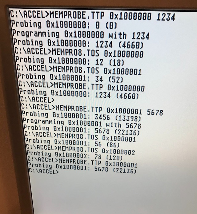

I'll have to re-read it, thanks. My understanding was with a fixed 16 bit bus you always answer as 16 bit, otherwise if you're reading a single byte from the lower data bit size the data will end up on the wrong data lines.czietz wrote: Thu Sep 24, 2020 7:44 pm However, 68030 dynamic bus sizing is quite complicated. Did you implement all the cases for the combinations of of SIZ1, SIZ0, and A0 as described by 68030UM? In particular the combinations where you also have to provide the previous/next byte in memory for byte-sized accesses?
I've used a 16 bit port to keep it the same as the Falcon's bus for now so I'm using the same logic for UDS, LDS and DSACK[0:1].
Here's an example of me writing a word and reading it back byte-wise; plus a word-misaligned write and read back. These seem OK, but perhaps there's a combination I'm missing -- or it's timing.
BW.
