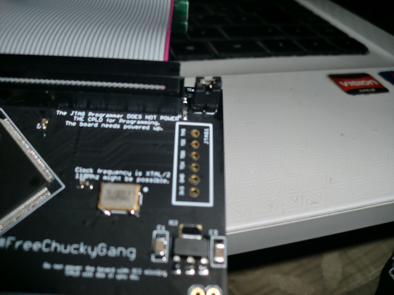

  • What's the jumper for by the ide header? I can't read the silscreen on mine.

you need a jumper on two pins next to IDE as these are the Card enable/ Disable pins
see pic below
it will then boot with your A1200 cf card
TF330 disable jumper.jpg (167.14 KiB) Viewed 6676 times

Well loook at that! That's all I needed was the jumper. Thanks!
