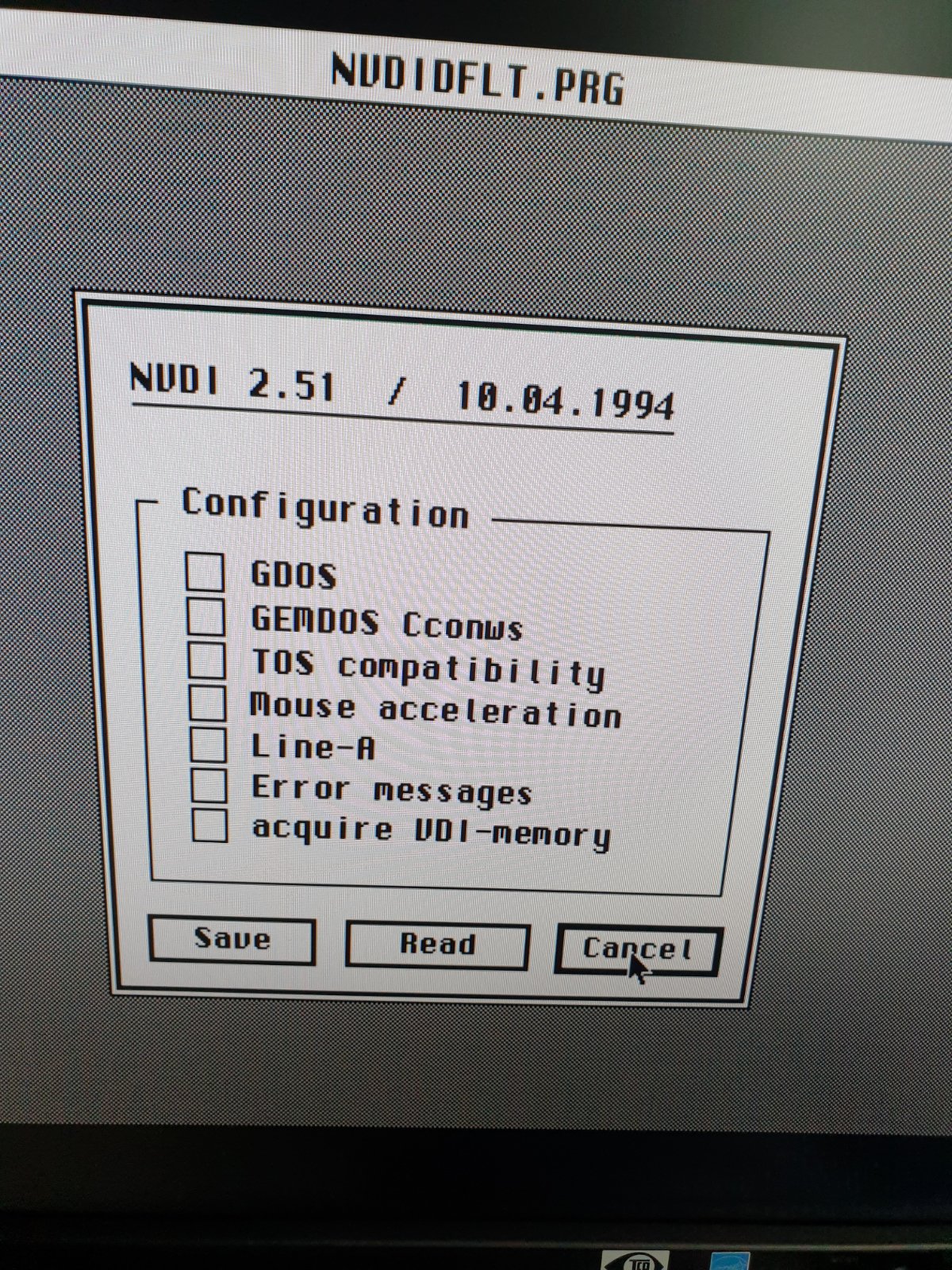

So there's a selection here:
Which gives you these options:
No matter what I select Notator crashes when being used with EmuTOS. (Just Notator with NVDI 2.51 is fine)
But if I double click on this:
I get this "aquire VDI -memory" that's unclickable:

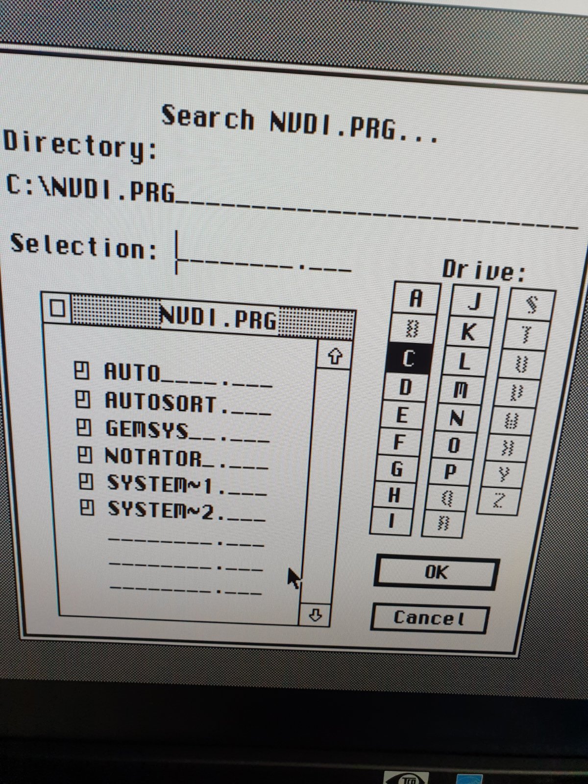

If I click "Read" and then go into the AUTO folder:
and choose NVDI.PRG:
I'm able to select "aquire VDI -memory" and save:
This will then let Notator load.
I tried lots of combinations. I can leave all boxes unchecked, but if I uncheck "aquire VDI -memory" I get this:
This is unchecked by default and only accessible through this folder.

After losing my whole day to this, as I hadn't remembered this was what was doing the making and breaking, can anyone tell why this is the case?
I have no idea what's going on. I've just fixed it by a process of elimination and taken my sanity with it! :shock:

I don't understand what this means, it says to leave it unchecked, yet checking this box makes Notator load with EmuTOS.
Unchecking it causes a crash.
