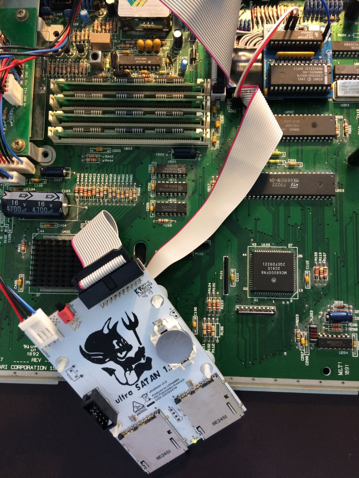

As promised in another thread, here are some pics of the internal mods I made in my 1040 STE during my short summer vacation:
Everything works like a charm.
Next step will be to install the STE booster, but it's another story...

Looks great ! Could you give more detail on the internal satan Install please?

joelolzen wrote: Sat Aug 29, 2020 3:05 pm Looks great ! Could you give more detail on the internal satan Install please?
Thanks !
Here's a picture from another forum which will help you connect the Ultra Satan internally:
If you plan to install Exxos' HD fdd kit, you'll have to move the flat cable on the left side, as seen in my previous pics.
Have fun !
