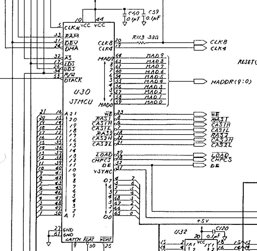

Another consideration when looking at schematics is how things like address and data lines are handled. Here we see one of the STs many chips with both address and databus connections:
Once again, the pin numbers are numbered as per the datasheet, but in the schematic, not where you'd find them on the actual chip. What is key here is that to draw ALL of the address and data lines would take up a mass of space and make the schematic huge. So what is done is that initially at the chips,they all pop out (A1-A21 and D0-D7), but as soon as possible they merge into a single line representation of the address and data bus. This saves time and space and is a technique that helps simplify the schematic.
The important takeaway is that at each chip these buses are shown and this again allows us to easily understand where connections are being made chip to chip. This type of representation for multiple bus connections is standard on most schematics.
