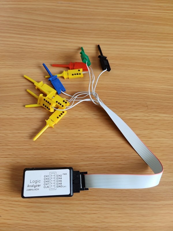

The Logic Analyser:
This is the big brother of the logic probe, and now also available for under £10. The Logic Analyser can measure the states of pins on chips, so 1 & 0, but unlike the Logic Probe, it can examine multiple channels at once, and because it plugs into a PC, allows you to record these channels. For example, you could connect the 8 channels of the device shown to 8 address lines, or 8 data lines, and record as they 'Pulse', then play it back.
I'd describe it as an oscilloscope for logic.
Given the cheap price and free software, these are well worth investing in if you need to see more than one channel of logic at a time. I wouldn't regard them as essential for basic troubleshooting however.
