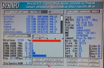

Started the 1200 up with Diagrom and the diagnostic was indicating it was a Rev 6 :)
Just to make sure :roll:
Lucky
Lucky
I had to use AddMem for the fast RAM to show up when I was using the card as a 1240 as detailed in this thread
viewtopic.php?f=84&t=2973
Not any more with the 060 ROM in place everything was auto-loading as it should fast RAM as well :D
Chucky suggested this on his website the 1240 ROM was probably defective in some way and that was the reason the fast RAM would not auto-load on the 1240. (Spot on by the looks off it :thumbup: )
Only running at 50 MHZ ATM but happy with the results
