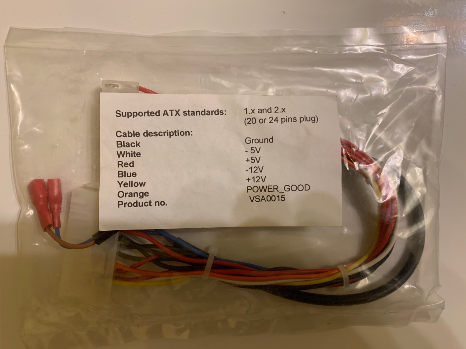

Let me start by saying I'm new to the Atari ST scene. I just bought my first machine, a 4MB Mega STE running UK TOS 2.06, previously owned by an enthusiast. It came with a number of extras - gotek, ultrasatan, eiffel ps/2, ubeswitch and also came with this:
The seller said he'd planned to put in an ATX but had never gotten around to it. I'm in the US, the MSTE came from Czech Republic, and given I'm gonna have to power this thing through a step-up transformer until I can swap out the PSU for a 110, should I tell exxos to put me on the list for one of his or replace it with an ATX, in which case, what would you recommend? I don't know that the machine is currently having any issues - I haven't turned it on, as I still need to get the transformer.

I guess any low power ATX PSU will do the job.
My PSU's are not for MSTE either, only ST range.

exxos wrote: Fri Jun 05, 2020 5:36 pm I guess any low power ATX PSU will do the job.
Good to know, I followed a link to your PSU listing from another forum asking the same question re: MSTE PSU replacements and was a bit confused, but chalked it up to to newb ignorance.
