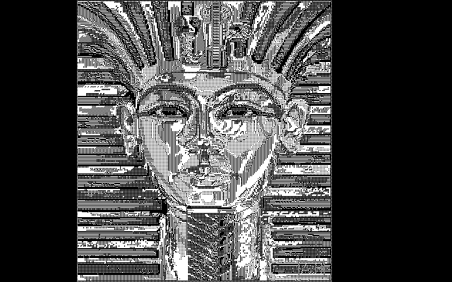

Gunstick
Posts: 61
Joined: Tue Aug 22, 2017 12:42 pm
Re: Convert image from PNG to PI2 ?
Post by Gunstick »
exxos wrote: Thu Apr 16, 2020 2:00 pm ARGH! Anyone know how to convert PI3 into IMG ?!
EDIT: looks like CANVAS can do it ... viewtopic.php?f=25&t=65
If you are on linux, netpbm has pi3topbm
BILD.PNG: PNG image data, 640 x 400, 1-bit grayscale, non-interlaced
