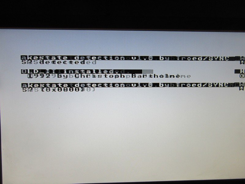

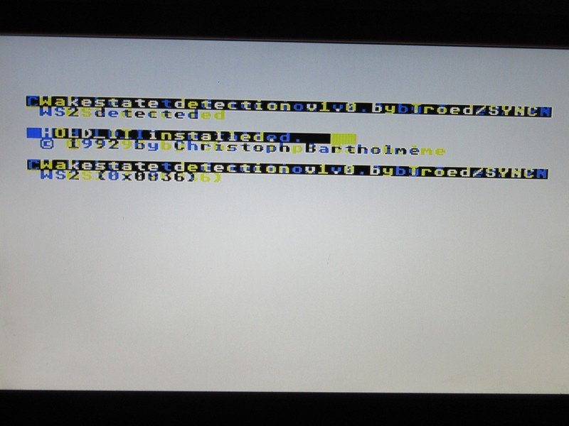

Thanks, seems to work. I assume in the image below WS2 means it counted 36 bytes :shrug:
and WS ? gives 0x0000 but its always hard to read which is part of the problem... Not sure is possible to actually output how many bytes accounted regardless of it translating it to the "WS" number ?

Post by beel1 »
The computed value is displayed in any case. I get "WS? (0x00AE)" on STE in Hi for example.
It is the value in d4 as used in the switch case at lines 244-252 converted in ASCII
Posts: 29620
Re: Help to compile a source file
Wonder why it says 0x0000 on mine then ?
