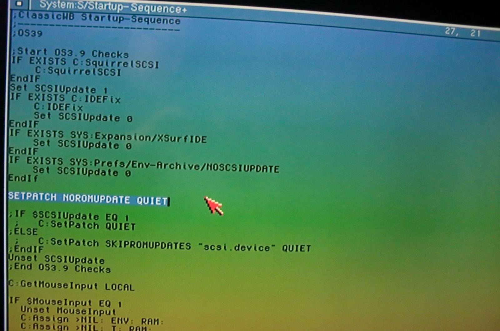

I didn't find any reference to DF0 in the startup-sequence. I believe the closest thing to it was this

To stop the DF0 unreadable icon appearing on WorkBench edit your Startup-Sequence as I have done by adding this line before the first Setpach command
SetPatch NOROMUPDATE QUIET
