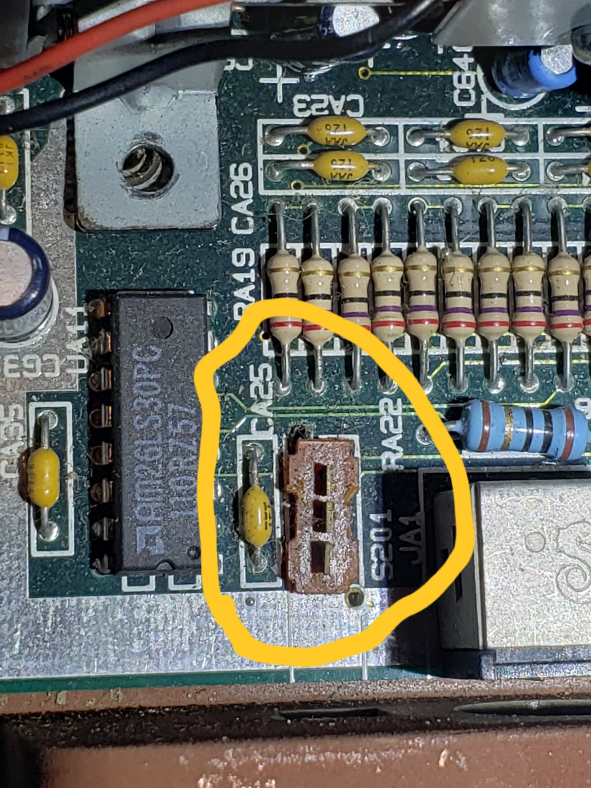

Hello just looking for some help with a mega ste I have repaired the psu and it is working I replaced the reset switch as it looked like this
I'm using a benq702 led monitor for testing I get a white screen in hi res and a black screen in low no signs of boot after 20 mins. There is sync as the monitor locks on so I'm think the cpu is halted it has memory from a working system and tos 2.06 rpms

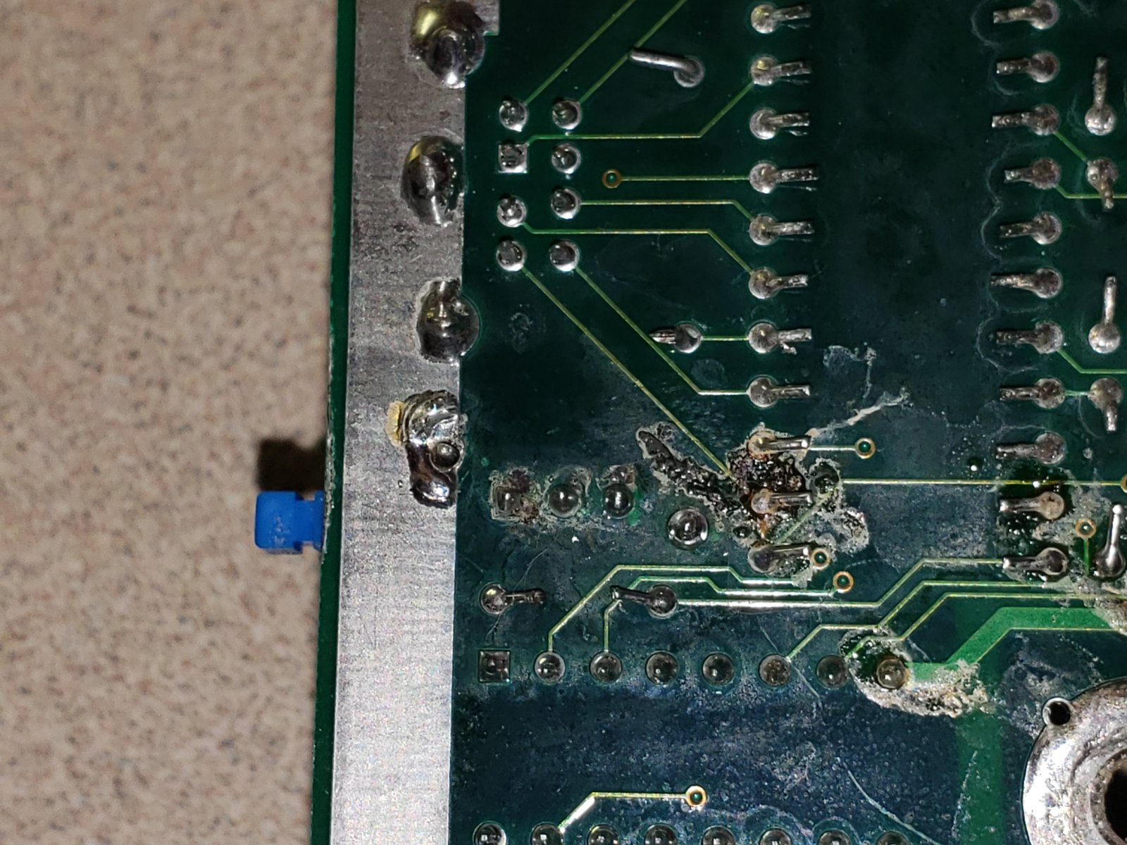

This is the bottom of the board after the new switch

Tomswork wrote: Mon Dec 09, 2019 8:09 pm The switch when pressed cause the sync to drop off
It is normal for the monitor to lose sync when the reset switch is pressed.

Ok, so the first thing you need to do is clean up the pcb. Its difficult to tell what you have until all that flux or corrosion is removed.
I suggest you clean it with IPA and then see what happens.

The corrosion is a major problem that is after a cleaning is is localized to this area of the board and someone put alot of heat to the area as well
